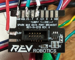

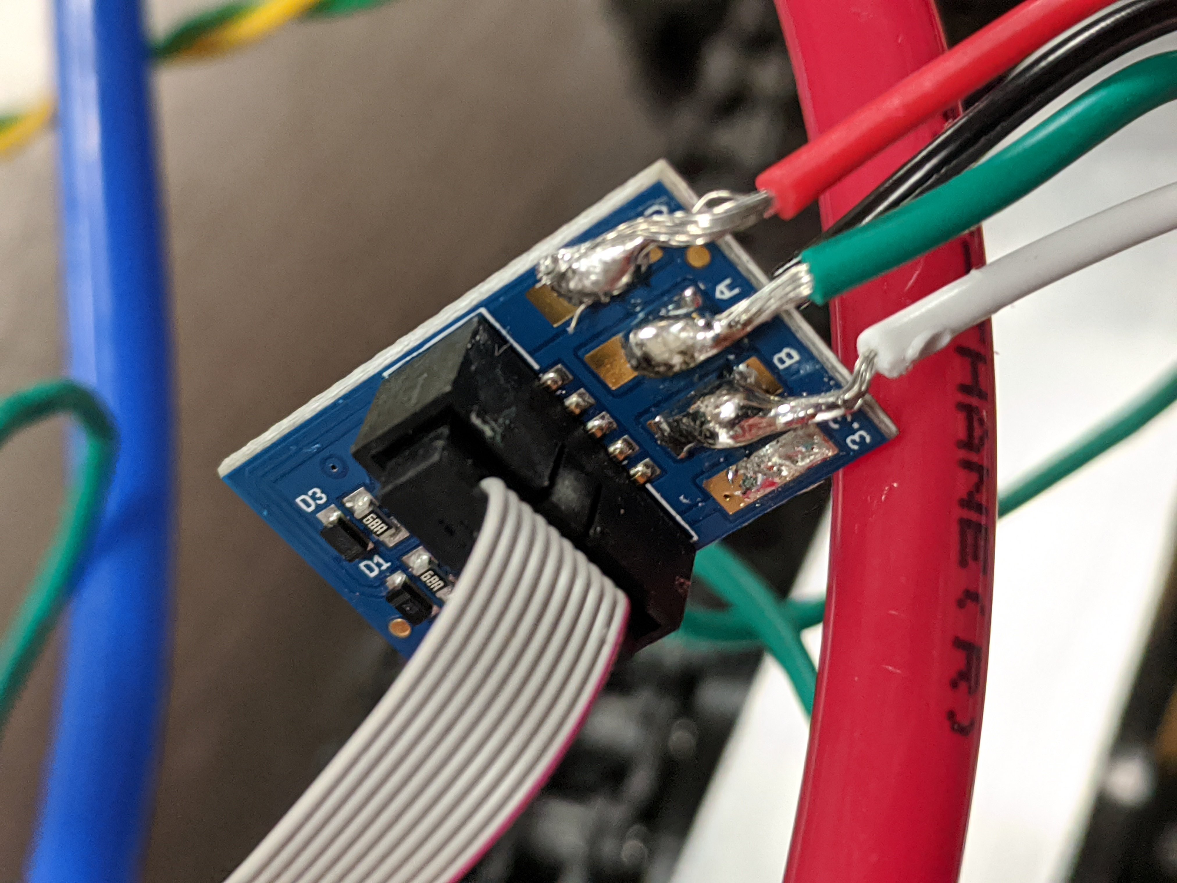

I soldered them in the manner specified on REV’s website under the “Connecting an alternate encoder” section, where the pins are reconfigured. Here are some pictures:
(For context: Red = 5V, Black = Ground, Green = A, and White = B)
When you seat the Data Port Breakout Board on the Spark Max, can you double check that it is aligned correctly? There is enough space to offset the board by a row of pins in either direction if you’re not careful.
Can you also confirm in the Spark Max Client under Advanced Tab -> AlternateEncoder that kDataPortConfig is 1 for the Spark Max to which the breakout board and encoder are connected?
Yeah, I double checked before I left today and it was seated properly and the tab for kDataPortConfig was set to “alternate encoder” (I believe that’s what it sets to in the 2.1.1 version of the client)
