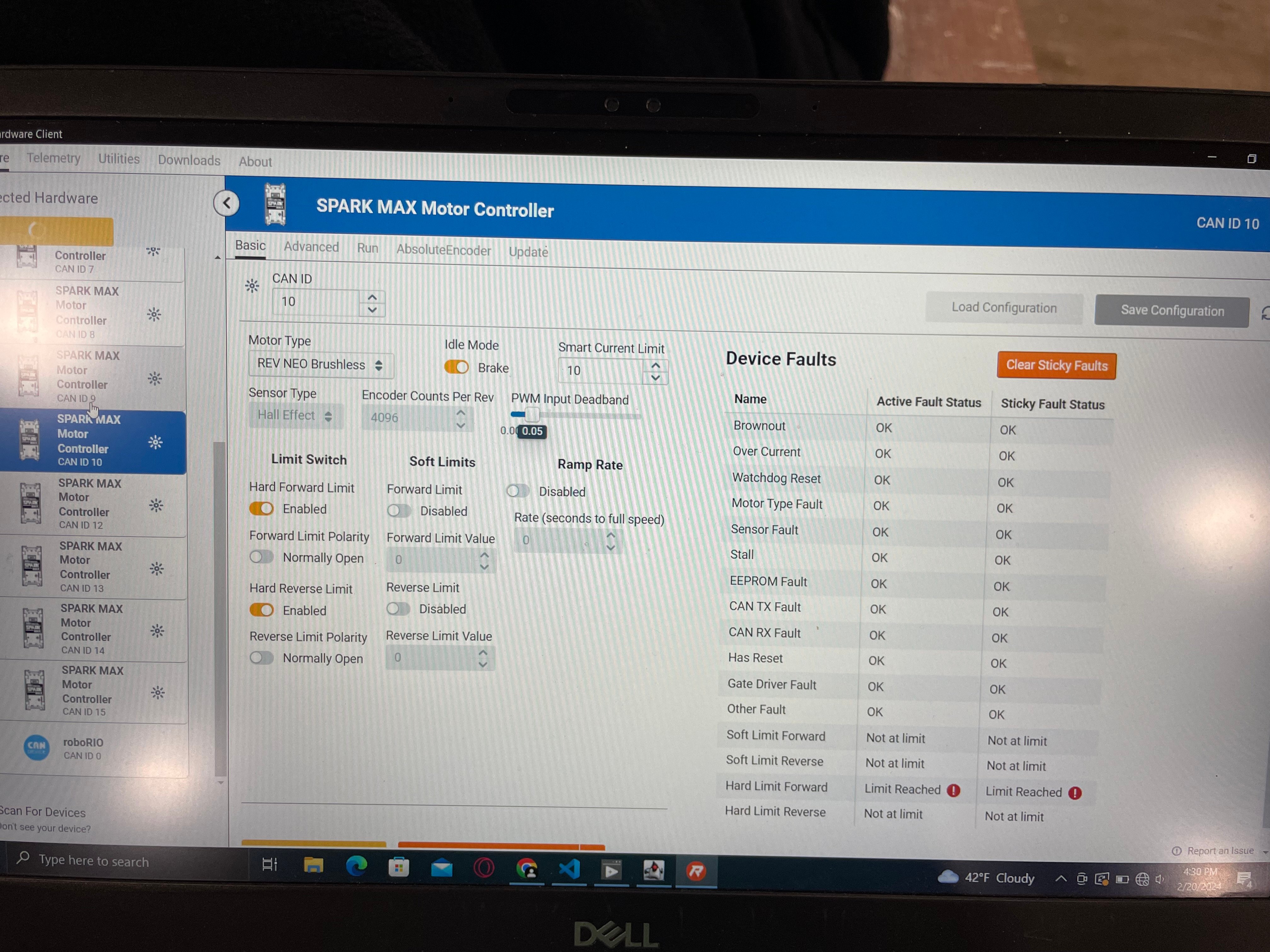

Can someone tell me what the hard limit forward is and why the fault won’t go away.

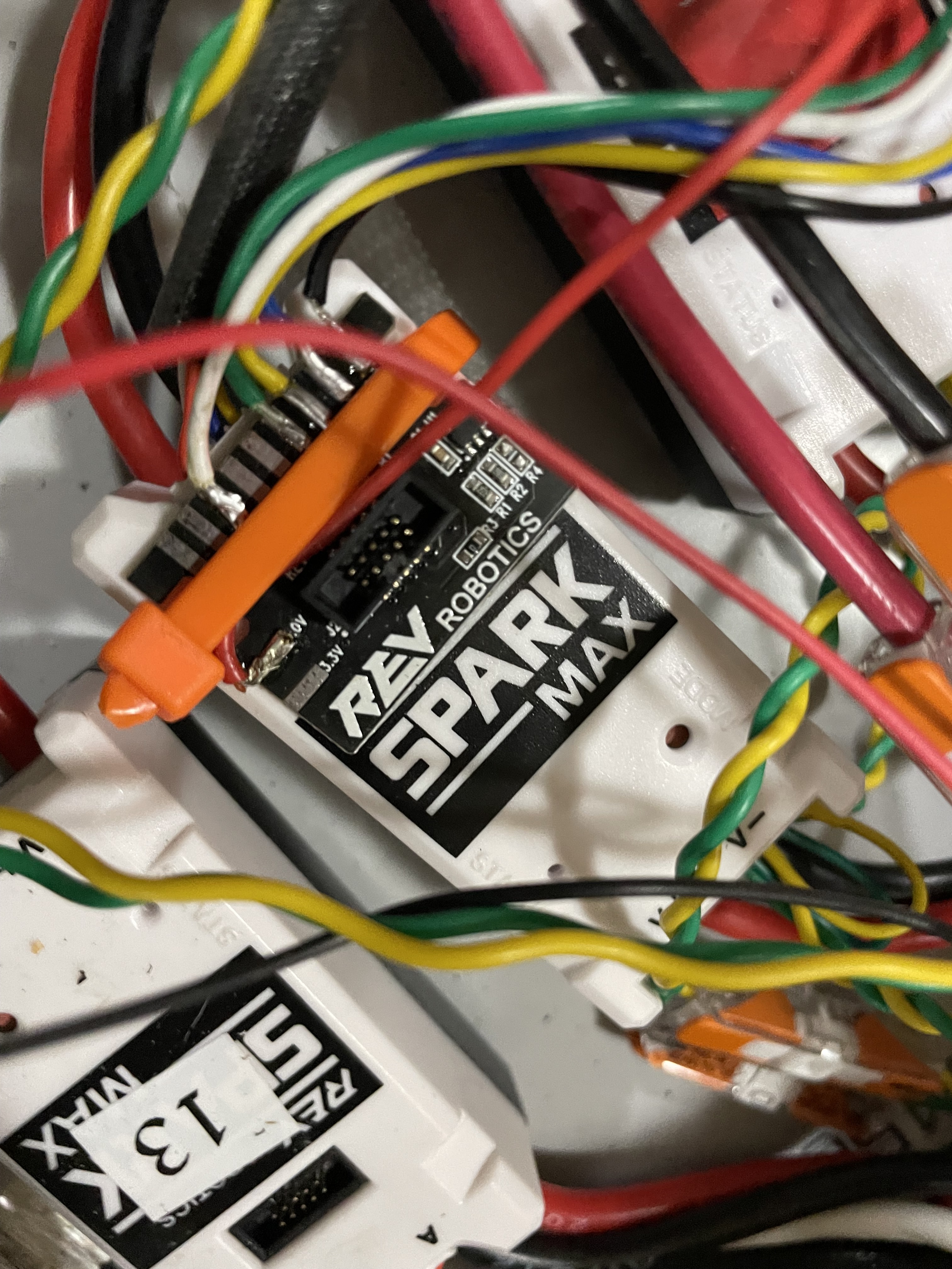

We have a neo through a 100:1 max planetary with a throughbore encoder wired in through a breakout board

Can you send a picture of the error and how it’s wired?
Sorry, the images wouldn’t upload the first time, but here are pictures of the error on the hardware client and the wiring of the breakout board
If you need any more photos, I’ll try to provide asap
Do you have a limit switch attached? If you aren’t using one, you can just turn off the switch for “hard forward limit” and “hard reverse limit”

Make sure you have the normally open/normally closed setting so it matches what you are doing electrically.
Make sure you have set your encoder type to alternate (either with sparkMax.getAlternateEncoder(8192) or via rev hardware client), since if it is in absolute mode the index pins are shared with limit switch pins
Make sure you don’t have a “hair” or solder bridge between P6 and the forward limit switch solder pad next to it (can’t see what’s happening under that zip tie).
Also make sure there’s nothing lodged in the piggyback data port.

Sorry for the delay on this one. It looks like your breakout board is misaligned. Make sure the notches on the board line up with the notches on the case, as well as the outer edges of the logo box.
