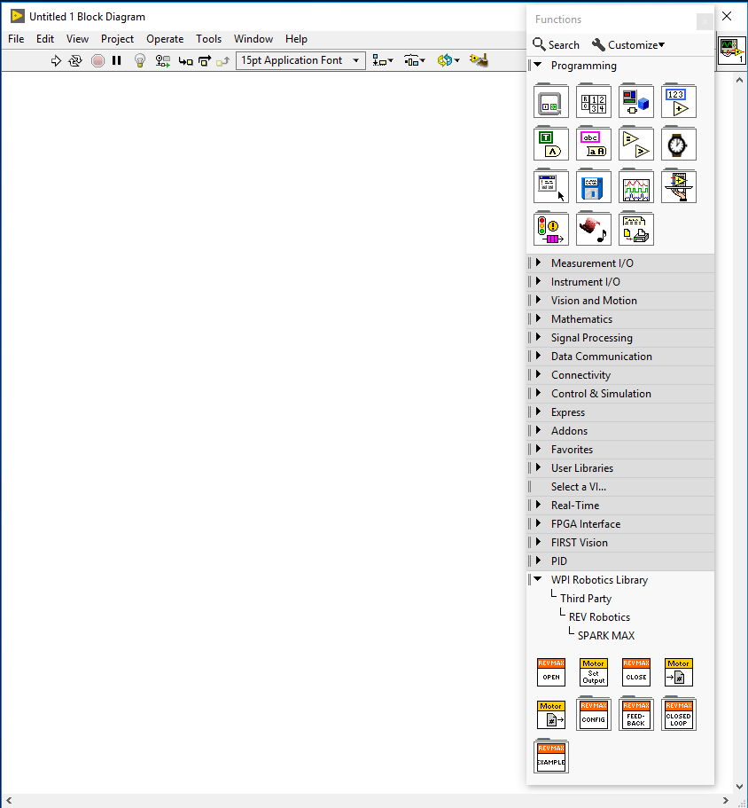

@BCR-Jim here is the process I followed to show the libraries:
  1. Download and install the SPARK MAX Client
  2. Download and install the SPARK MAX LabVIEW API using NI Package Manager
  3. Reboot the computer
  4. Saw the library in WPI Robotics Library > Third Party > REV Robotics > SPARK MAX
I hope this helps you get up and running!
