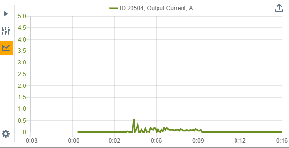

Here’s what got when plotting the output current today:
This seems to make much more sense, but I’m not sure if it’s accurate, as I believed the motor would pull much more current when running at full speed.

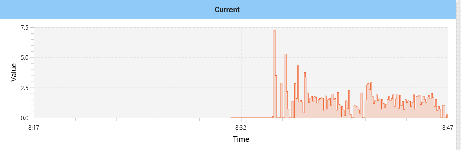

Also, it seems like reading the output current value in code results in values that make much more sense, but they also have some big fluctuations:
The motor was running in open loop mode at 100% output, with no load. I don’t know much about motors, but I’m pretty sure that it did not pull nearly 7.5 amps and drop back down to 0 instantly. those numbers are also wildly different from the ones measured from the same motor shown above.

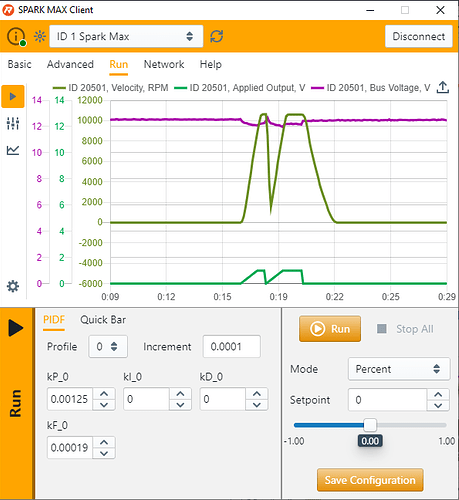

Here’s what it looks like when the stopping happens:
The first drop in velocity is when it suddenly stopped, versus the second drop, which was when the robot was disabled (the motor is in coast mode). As you can see there’s a very big difference.

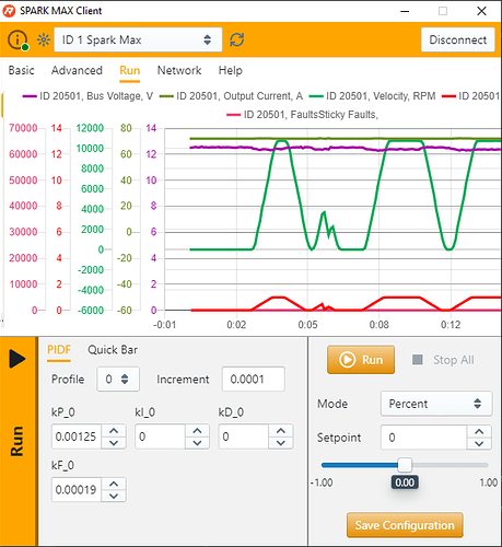

This graph shows more information:

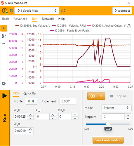

Each one of those sudden drops in velocity is the motor suddenly stopping completely, and then accelerating again (since the joystick was held down). And weirdly enough no faults or sticky faults were reported this entire time. The “Applied Output”, which seems to be the percentage output given to the motor (even though it’s measured in volts???), dropped to 0 immediately. In comparison, here’s what it looks like normally:
Here’s the code that was used to do this:
double y = -controller.getRawAxis(Y_AXIS);
if(y > 0.9) {
	drivetrain.setMotors(0, 1);
else {
	drivetrain.setMotors(0, 0);
As you can see, even though the code just sets it to either 1 or 0, the ramping and coast mode still make the velocity change relatively smooth. In contrast, that weird bump in the middle is from the motor trying to accelerate, but suddenly stopping.
Also, the Output Current went back to 72A again, and would sometimes randomly drop to 24A and stop there. No idea what it’s actually even measuring.
Nevermind, it seems like the problems have magically gone away. it might be just a comms issue after all.
