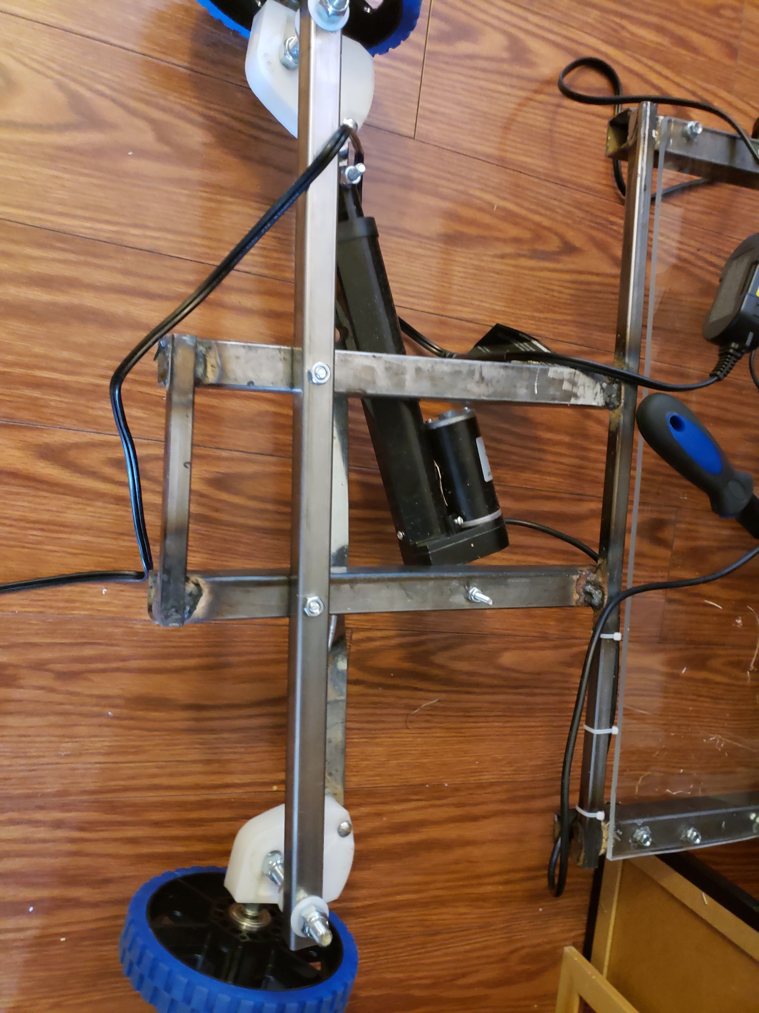

I’m currently using Two Neo Brushless motors with Spark Max Motor Controllers for the main power train, and in the front, I built an Ackerman steering system with a linear actuator and a Victor 884 to control it.

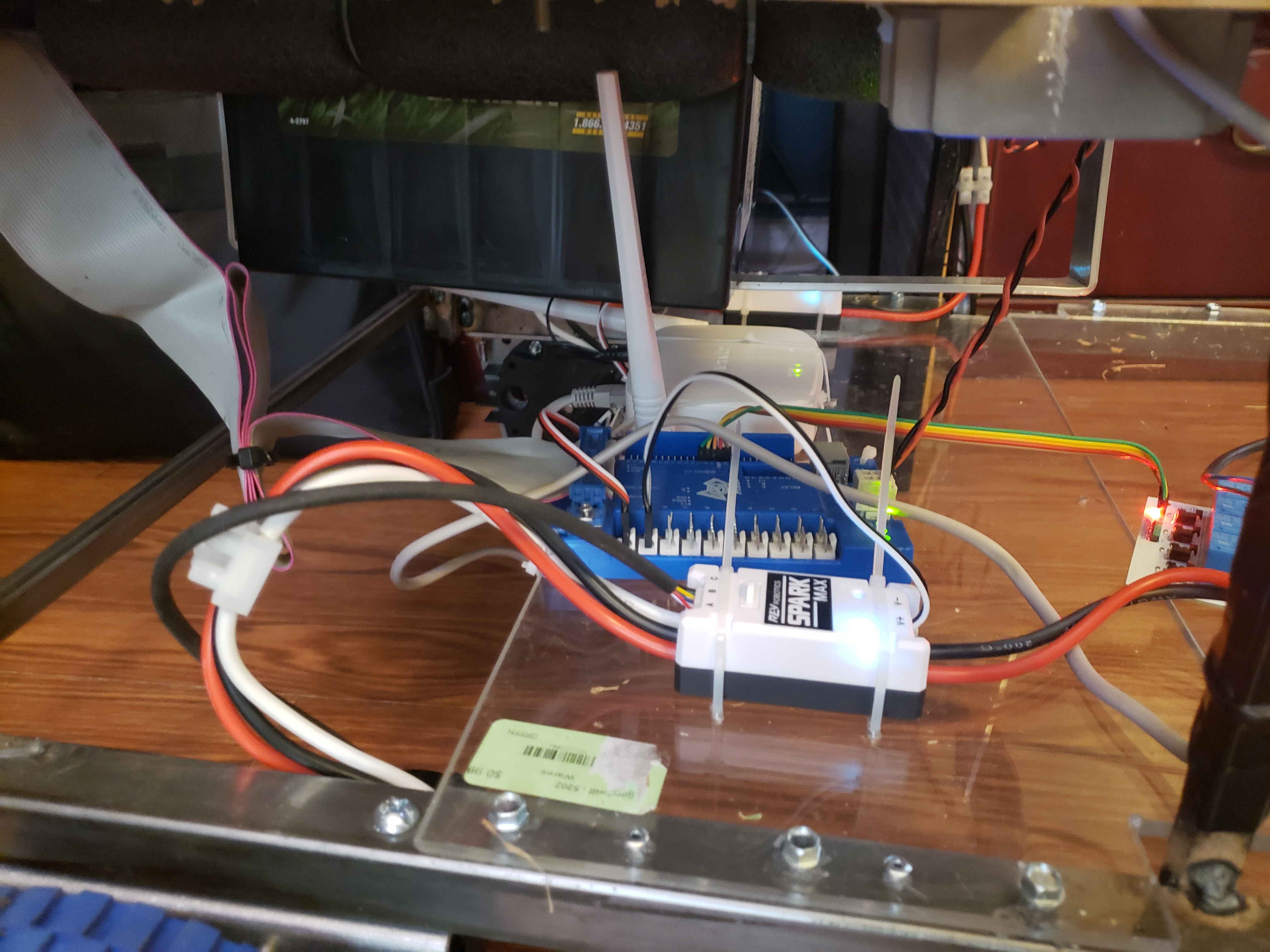

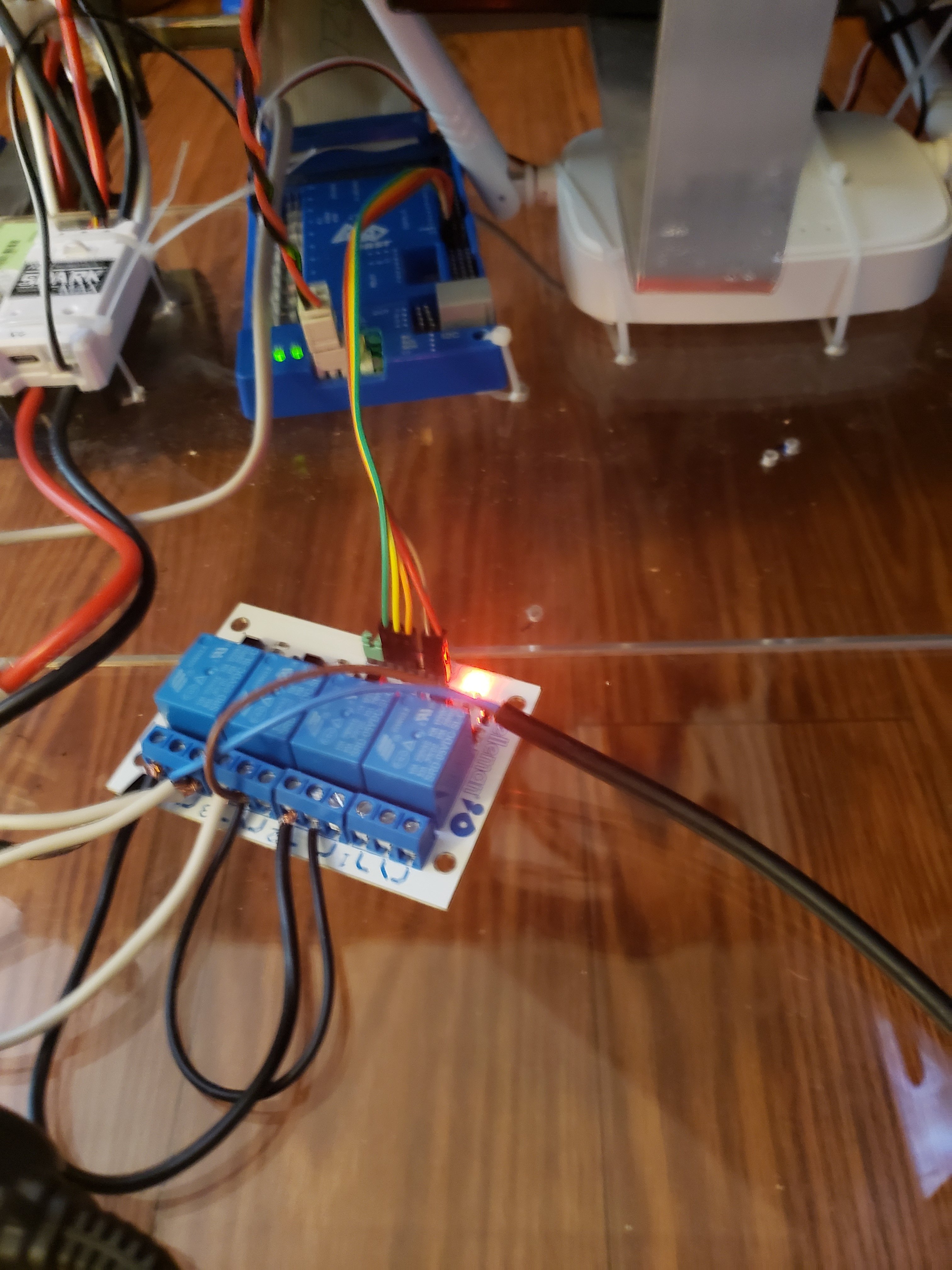

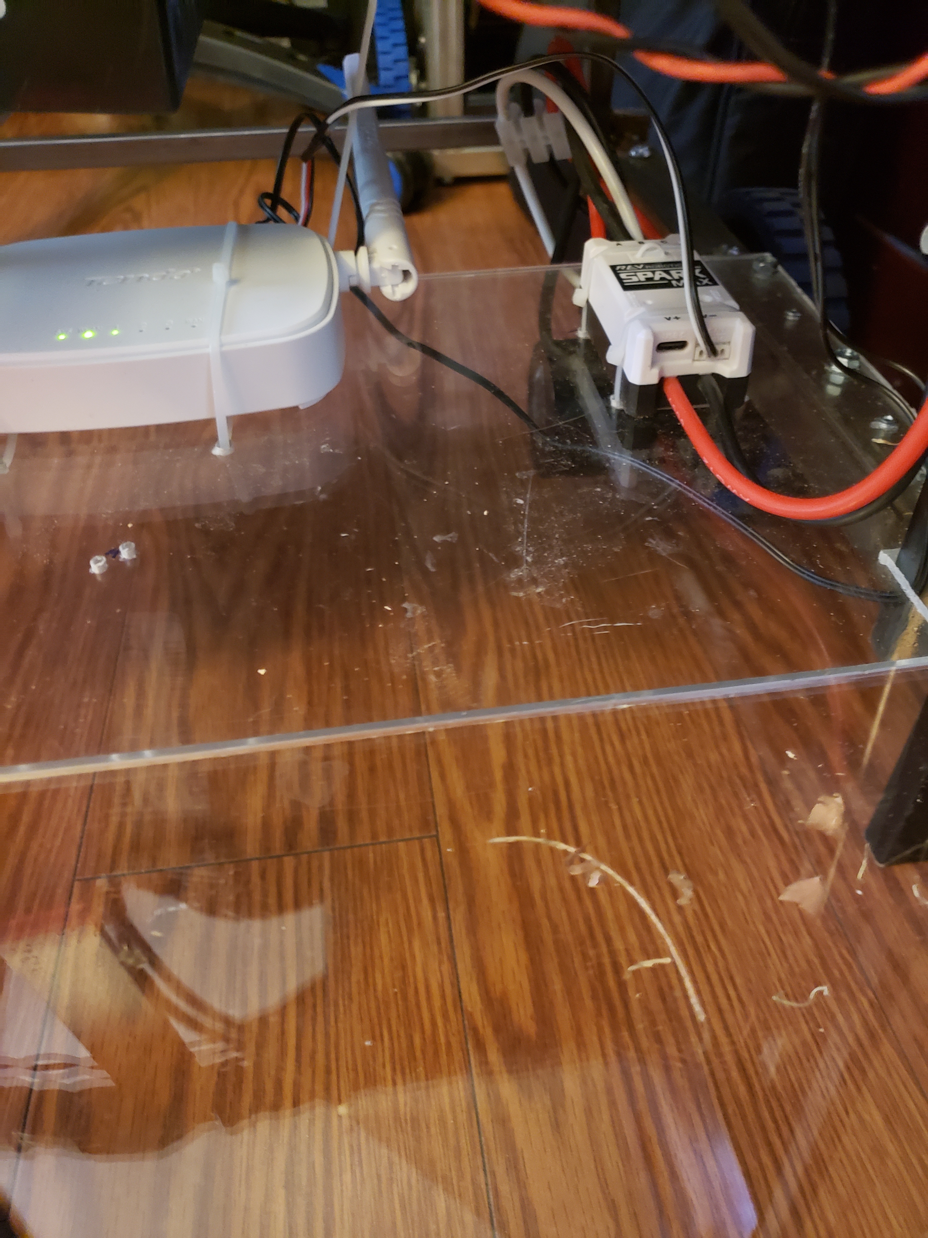

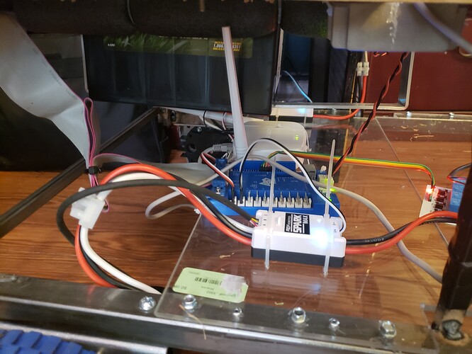

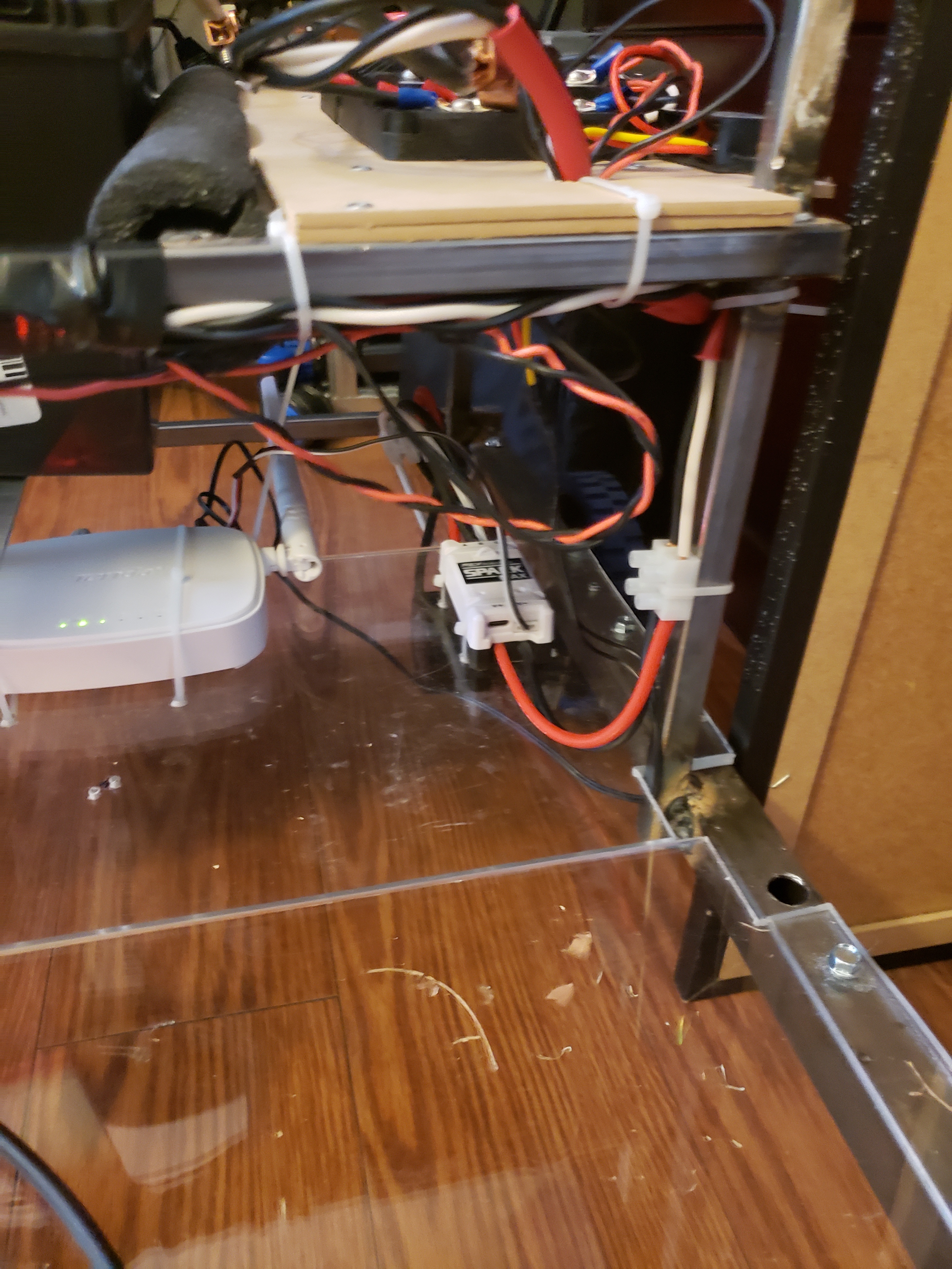

Can you post photos showing your wiring including all the signal and power wires?
Check that the black return wires all have tight connections (crimped and bolted).
Print out your code and check through it, line by line. Make a table for all your variables and motor controller states and update the table based on what the code does, not what you think it should do.
Sorry about the jumbled wires. I’m still working on the layout for wiring, signal wires are directly tied to the digital sidecar.

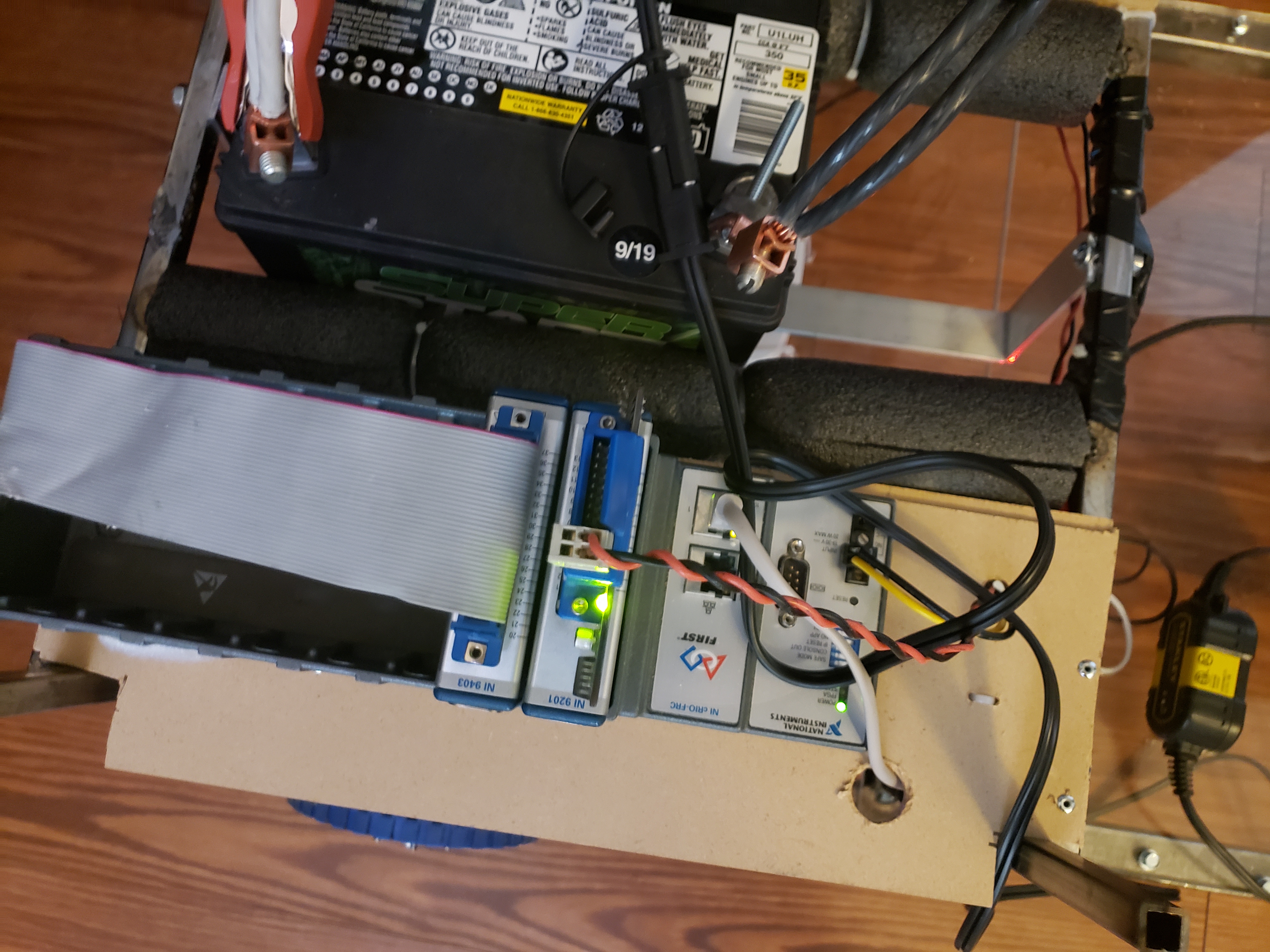

The cRio currently sits on Masonite board and (I believe) should be sufficiently isolated from the frame.

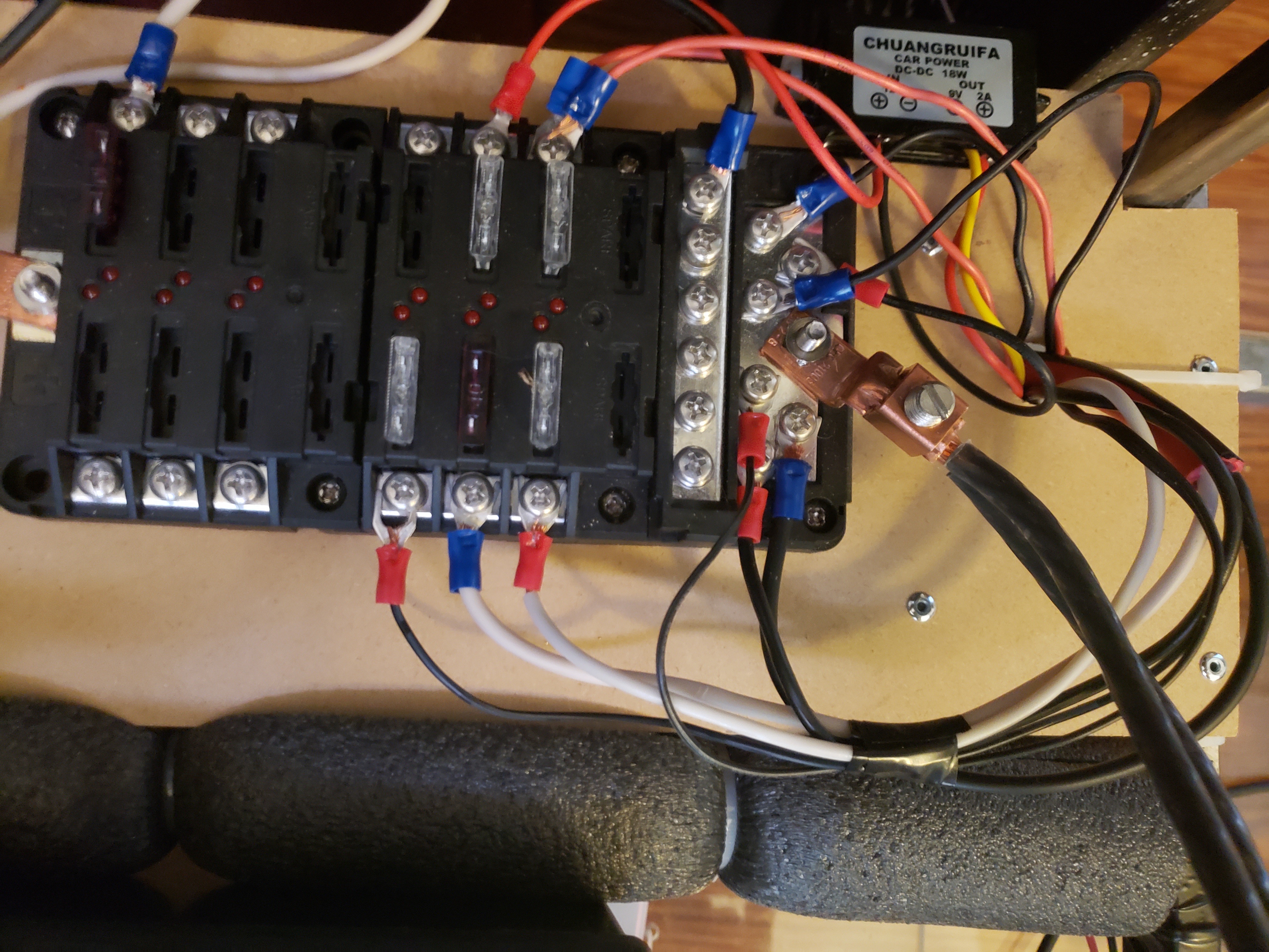

Can you post another picture showing how your battery connects to the power distribution panel?
Are all the connections tight? You should not be able to turn any of the lugs with finger pressure. The lug with the red insulation at the lower left in the third picture doesn’t look like it is making very good contact.
