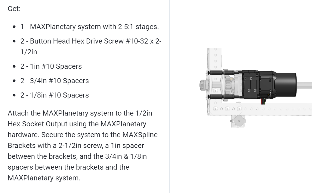

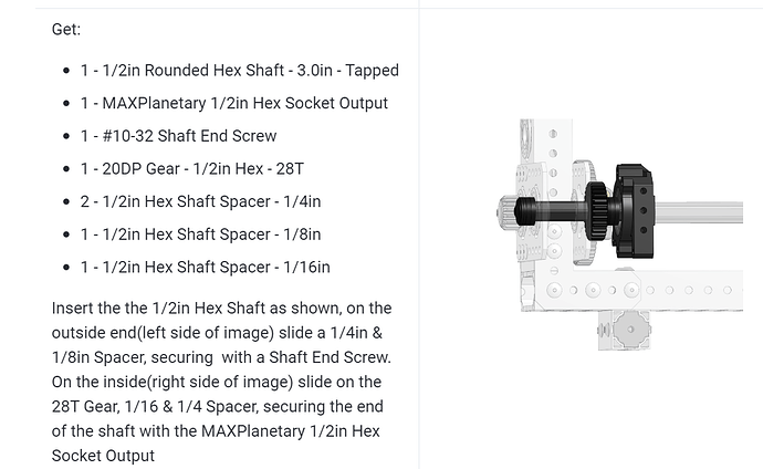

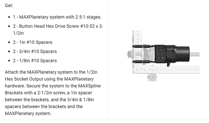

For our gear boxes we are using two 5:1 ratio gearboxes, I’m not the best at the mechanical aspect of the robot, so I linked the set up we used for our whole arm.
5:1 will be “weak” by most standards. If the two 5:1 were planetary and combined to 25:1 that’s better but still pretty low

No problem, did add a note about combining the gears, didn’t notice how the two 5:1 were already being mixed. 25:1 can move the default arm, but not well. It also estimated 5 seconds to move 90 degrees. Changing to a 100:1 actually brought the time down to 0.4 seconds because it’s not struggling to get there. Might want to look at changing to 10:1s for each stage if possible.
If you can’t change those gearboxes then you could use external gears or a chain reduction to get another 4:1 or 5:1 and be in a better range. It really depends on the length and weight of the arm.

REV doesn’t have a 10:1 stage (and I probably wouldn’t use it if they did since itll likely have the same load issues the high ratio Vex planetary gearboxes did). They do have a 9:1 which is new this year, but I’m still hesitant. Best bet would be to add a 3rd stage with 4:1 if you’re going for 100:1 total.
We have only just started to use the REV max planetary (part of max swerve), I’m just familiar with the banebots 100:1 (prefered) and the VP 10:1 I agree they can bind. That’s why maybe an external chain reduction would work too. Also would help if the arm is on a dead axle
