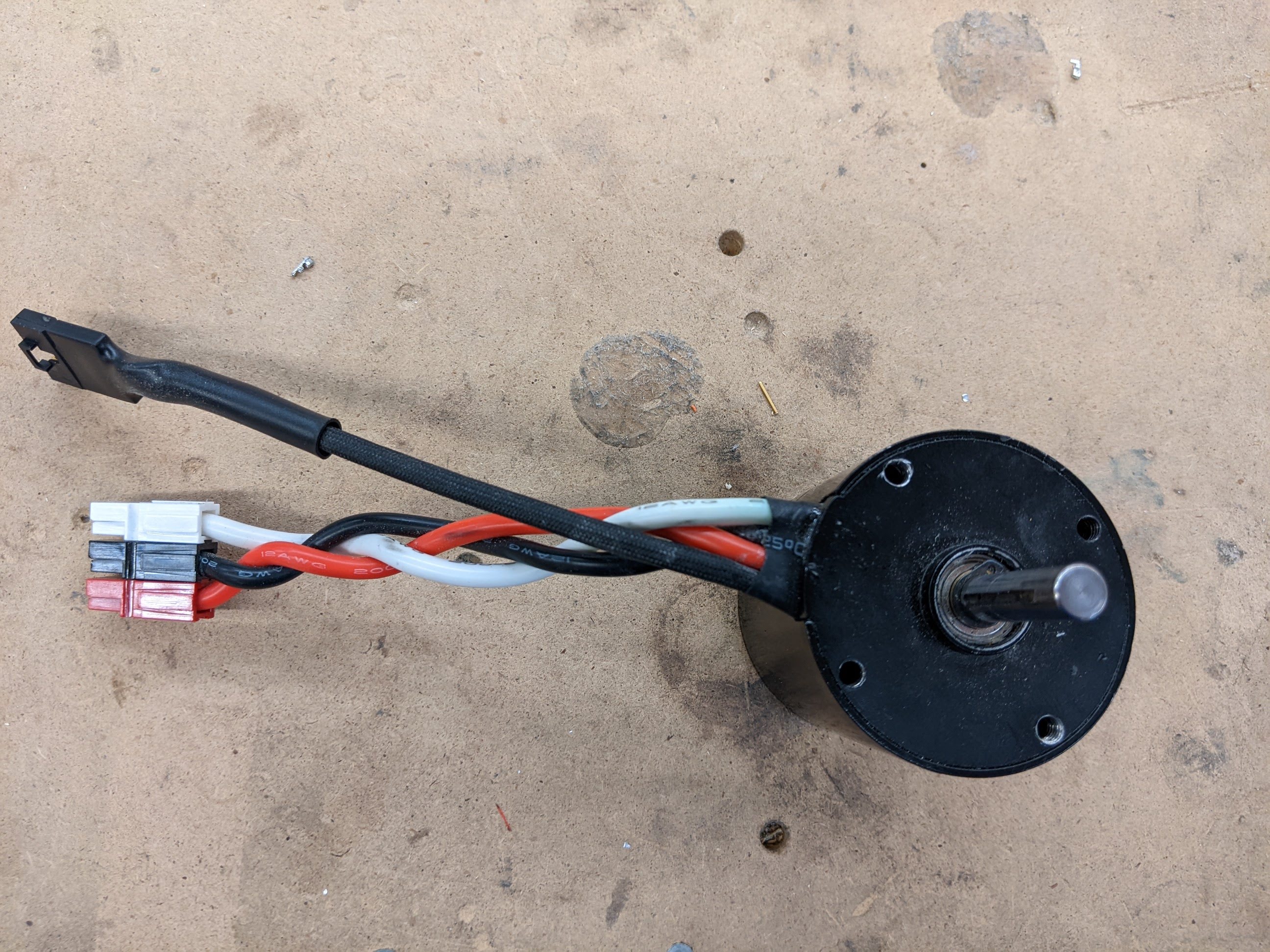

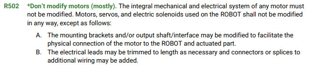

Has anyone considered cutting the motor’s encoder wire and soldering in a “better” connector in between? We’re just starting with NEOs after the problems with Falcons and the weak encoder wire is our only gripe so far. Adding a connector to the motor wire should be exception B to the no modifying rule.
That’s our tentative plan this season. It’s not as much a connector problem as a wire gauge problem. The Neo 550 is worse than the Neo.

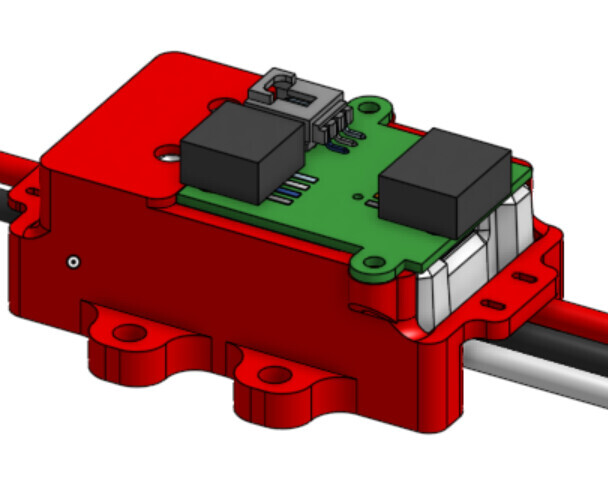

Our tentative plan is to make a JST PH to molexSL converters (out of of the Rev extension wires that use larger gauge wire). Then crimp all of our Neos with molexSL connectors, which we have found to be more reliable with the tiny wire. We also have a $400 crimper for them, so there is that. We designed a Spark Max mount to hold all the JST PH connections with the ziptie.

Braiding the lead wires? Yeah, we have done that for a couple seasons. (I think back to 2019). Seems to work fine…but didn’t think it was particularly innovative.

I’m curious what you plan to do at the controller’s JST PH connector. If I’m understanding correctly, you’re relying on the heavier extension-wire gauge as being less likely to break there… but how does the mount fit in with this? (Can you share a picture?)

Sure!! Its actually all in a different post if you want to read a lot about it. It just has a ziptie to hold the JST wires for strain relief. Nothing super fancy. We may also use hot glue to hold it in, but haven’t decided. Because it will have the MolexSL on the other side, there isn’t really a reason to ever remove that JST connector.
Yeah, “avoid ever removing the connector” from the SparkMax is exactly what I want to do :wink:
