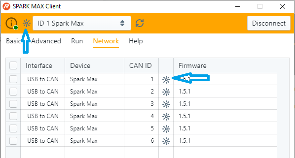

My team was experimenting with the sparkmaxs and the neos, one side of our robot works and the other doesnt… I know the joystick is going through to the drive method because I have it being printed out to the console. CAN Ids are set correctly, all firmware up to date, inverted set appropriately. How am I able to flash the lights on the spark maxes like I can with talons?
There is an “blink” or “identify” button in the Rev Max set up program. Main config page is memory serves.
You can also flash the LEDs on the Network tab of the PC Client
@AfterTen and @Will_Toth beat me to it! This is what the Identify buttons look like:

That’s odd, I don’t have that. Maybe there is something wrong with the SparkMax’s.
You are most likely not on the latest version of the spark max client. Go to the help tab and see if your client version is 2.1.1. If not, download the latest release from the Rev website.
v2.1.1 of the Spark Max Client can be downloaded here.
