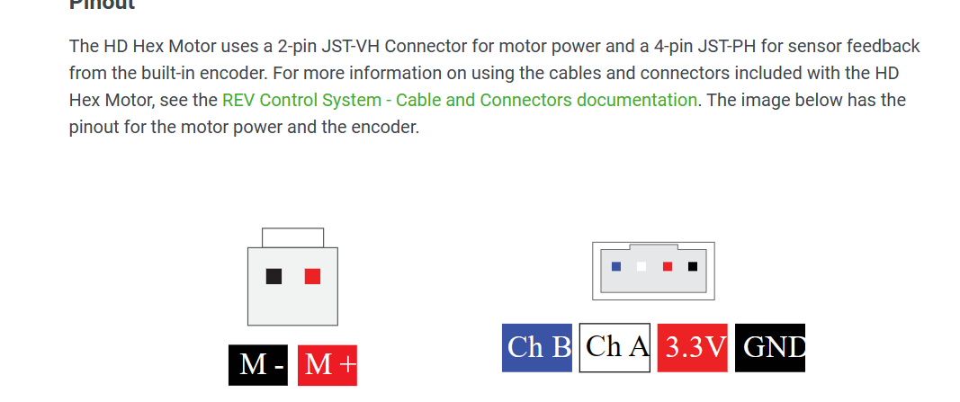

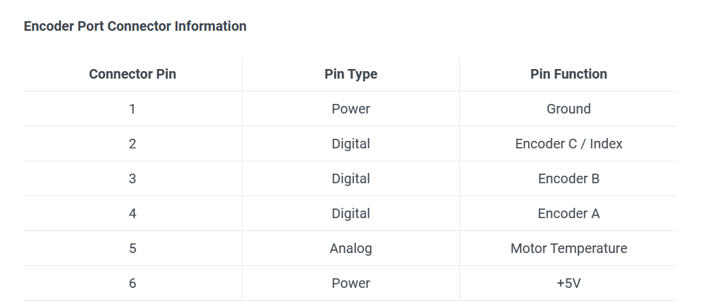

We recently purchased an HD Hex Motor thinking that it would easily connect to the SparkMAX with the encoder port but are having some difficulties. We have found that the connections do not line up, so the encoder does not receive any power. Just wondering if anybody else has a solution to this.
It appears to be out of stock, but REV Sells a cable to adapt the HD Hex 4-Pin Sensor Port to the 6-Pin SmarkMax Encoder Port
Thank you! Turns out one of the students knew where we had one so luckily we won’t need to be buying another one.
