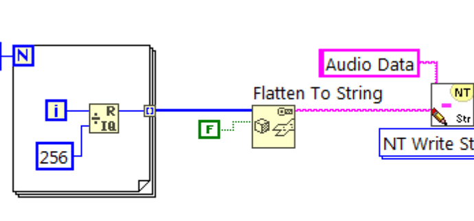

So it comes down to this: Can NetworkTables keep up with three 2605-element DBL Numeric Arrays being updated every 100 ms?

NetworkTables has a min update interval of 0.01s. So yes.

The LV network tables lets users determine the update rate with a parameter – always has, no limits. During beta, it was tested down to 5ms I think.
As for the robot driven with audio, you can certainly transmit pretty good audio with the equipment on the robot, but I honestly haven’t tried it through network tables. The numeric you are sending is an eight byte double, so it is way more resolution than you need. A more optimized approach would be to convert the array of numerics to I16s or even I8s, flatten to a string, and send via network tables.

Here’s an update, I set both dash and robot to convert to single-precision float before sending data to NT, robot audio code is shown in the attachment.
Audio processing print 1.pdf (205 KB)
Be sure to notice that there is a red dot where the wire joins the NT subVIs. That is where a type coercion happens. NT numbers are always stored and transmitted as doubles.
The attached image shows what I was suggesting to use 1/8th the memory and transmission bandwidth. The unflatten is how you’d get the numbers back.

Update: Went with I16 as a format, should work pretty well. that’s 1/4 the data, right?

Keep in mind that sound doesn’t have to be sampled at 44100, or 22050. Those standards were chosen for high fidelity music. By comparison, I think telephony transmission was 6K. Just enough to carry human voice. You may need to read the mic at 22k, but you can take every fourth byte or do similar filters to get a lower bandwidth audio signal. And you probably don’t need 16 bits of range for voice. Eight bits will probably sound fine.
I’d encourage you to start at 100ms sending audio from one computer to another using NT. Then change the period by a factor of 2 and experiment.
By the way, if you want to have a bit more control over things, you may want to consider dropping NT and just using UDP. It is actually very easy in LV. It has the advantage of dropping small packets instead of delaying and retransmitting, and has less overhead.
