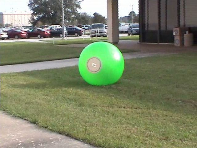

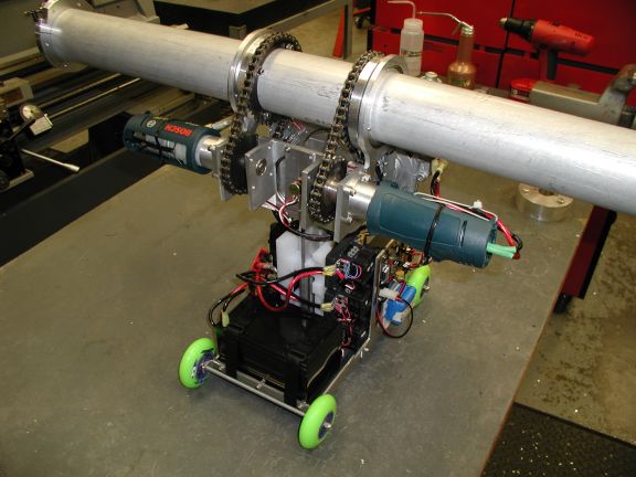

This is Roboball, it was designed , built and tested within about 6 weeks. most components are FIRST legal though I had to swap out a few things in order to fit under my weight limit of about 20 Kg ( 44 lbs). First ran about this time last year. It is capable of about 20 mph and will run for about an hour before the motors over heat or the battery for the IFI EDU controller dies. The ball material is a 50 inch diameter big-ins ball similar to the ones that have been used in a few FIRST competitions in the past. the little green wheels are just there in case the pendulum arm impacts the ground while traveling over bumpy terrain. It is inflatable and yes can travel across water.
That’s awesome! :smiley:
Question though… is it able to turn? It’s hard to tell from the pictures. (Being only two. And I’m an idiot programmer nerd who ignores the peasants who build the robot. ;))
Definately able to turn, the pendulum interal to the deveice is leaned over at any angle you want and it will cause the sphere to lean over as well and as long as it is traveling forward it will turn, much like a motorcycle when you lean. Similarly the ball can lean so far over that it places the metal disks on the sides of the ball onto the ground and literaly turn on a dime. Though its nearly unstable if you try and turn at full speed. Tends to make the ball flip over, always a fun thing to see.
