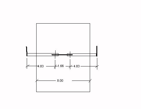

does anyone know about how much the spider foot is offset from the spider leg? maybe from the center of the circle? I couldnt find anything in the rules or I couldnt find the CAD files of the field Both would be greatly appreciated
Look at detail 20 on drawing 2007 Field_Rack_Fabrication(2)_R1.pdf - it looks like the offset from the center of the foot to the center of the leg is 2.88".
the drawing I mentioned shows a dimension from center of leg to center of plate of 3.188". This dimension is not shown explicitly, but it is the difference between the height of the “center of peg” and the height to the “center of plate”, and is shown in three places.

I am confused, some one menioned that the spider led was offset 2.88’ from the edge of the rack… Well in doing the math, taking into account that the central disk is 2’ in diameter, spider legs are 5’ long, and the rack is 10’ (face to face), the spider leg is only offset 2’… where do those 0.88’ come from?

To address your question, I find the horizontal offset of the spider feet is about 1.67 feet, viewing from the side. The overall width of the “cage” of the rack is 8 feet, each spider leg (from pivot to end) is 4.83 feet, the center disk from pivot to pivot across is 1.66 feet.
Two spider legs plus the center disk add up to 11.33 feet, sutract the 8 foot rack leaves 3.33 feet for two spiders. divide in half, leaves 1.66 feet per spider.
see attatched sketch, hopefully this clears it up. One place where you might have made a mistake is not including the amount the spider legs overlap the center disk. My measurements are taken from the bolt hole in each, not the overall size.
Thanks for the clarification
