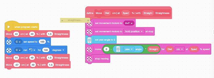

We have a basic gyro heading script running on our Spike Prime robot. It works fine, but only sometimes. We are wondering if the pressure on the wheel is the source of this problem or whether it is a mechanical issue.

Here is an image if our code

The gyro is internal to the Spike controller, but gyro initialization errors are a common problem. For the Spike, it is important to set the 'bot on a stable, flat surface when turning it on, and leaving it alone for several seconds or more.
If the gyro doesn’t initialize properly, you will get constant zero readings for roll, pitch, and yaw. We had a simple program to display a smiley face when one of these values was non-zero to test that the gyro had initialized properly.
That could explain why your robot thinks it is driving in a straight line when it is not.

We had the same issue with some of our teams. You might want to try redeclaring your motors with the set movement motors block after you use the blue motor block.
ah, I forgot spike doesn’t use external gyro like previous mindstorms do
thanks! this is the answer to our problem
