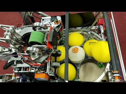

Our shooter is off centre and it works great. Originally it was going to be in the middle, however I there were several conflicts with other systems and I had to move it to the side. In the end, moving it to the side had several additional benefits, for example it allowed me to put the climbing winch and gearbox next to the shooter.
The omni-wheel on a motor worked fantastic. The motor is spinning at around full speed and the gearbox is a 4 : 1. The added velocity on the ball increased the efficacy of the shooter while also being the loudest part of the robot.
What do the balls slide on the side further away from that omni wheel?

We have a 4-cell spindexer made from 6mm aircraft plywood. Basically, our robot holds 4 balls in the spindexer and 1 in the intake.
Below is an early version of the robot that shows the spindexer
How do y’all spin your “carousel”? Is it similar to your rotating turret design?
not on the team but I would assume they have a motor in the center hub/axerl going through the center thats driven by a motor
different from a turret because for a turret you need things to pass through the center so they are driven by a belt/chain/gear that loops around the outside of the turret this would be a pain to do on a spindexer due to the amount of teeth needed around the outside
Kind of. There is a 192T 20DP Onyx 3DP ring gear attached to the spindexer. Then there is a 20T aluminum pinion that was on a 9:1 Versa Planetary gearbox and is driven by a NEO 550
Just to specify: the difference is on the turret I designed a 3DP lazy susan with the gear teeth built into it and the spindexer has a T6-LS lazy susan from Triangle.
