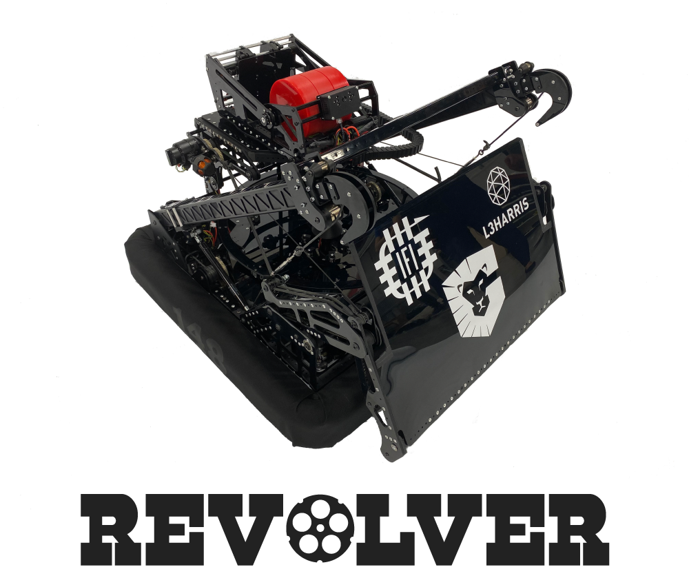

16 slots really isn’t that many, especially for swerve drive teams.
Take this year for example:
8 motors for swerve
2 motors for shooter
2+ motors for end game deploy/climb
1 motor for intake
1 motor for hopper/spindexer
1 motor for indexing
1 motor for turret
1 motor for adjustable hood.
That’s 17 motors right there. And you don’t have a PDP slot for limelight or a color wheel motor.
Robowranglers seem to regularly bump up against the PDP slot limit.

I completely understand that there are design trade-offs. We climbed with one motor this year and only had a 4 motor drivetrain. I only made an example of how quickly you can run out of motors (based heavily on 148’s Revolver) to address the idea that “16 motors seems to be more than enough.” If a robot aims to do most or all aspects of the game fairly well*, 16 motors becomes a very limiting factor. I believe Revolver wasn’t able to retract it’s intake due to that.
*I realize that most teams aren’t able to or shouldn’t shoot for this. “A jack of all trades is a master of none.” But there are teams that do accomplish this and the limit is very real for them.
