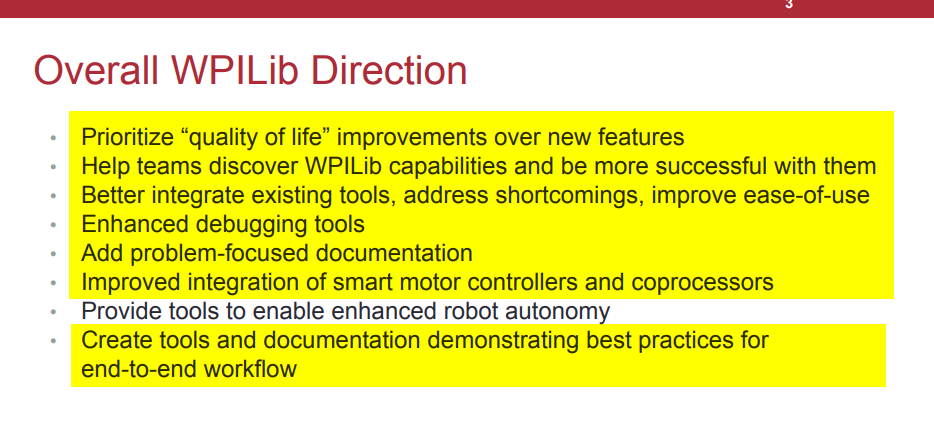

Bringing this back to the original post, what specifically in the future direction as laid out in the WPILib long term (eg 5+ year) roadmap is troubling to people? Or is the concern more with how far we’ve already gone (water under the bridge)?

I personally am happy with the direction of wpilib providing so much support for teams, but here are a few things that sound like they align with the points made in this thread so far

To boot - all but one of the Overall bullet points in the future direction support expanding the threshold of what a high schooler can bite off in their tenure. Only one speaks to expanding scope of WPILib:
