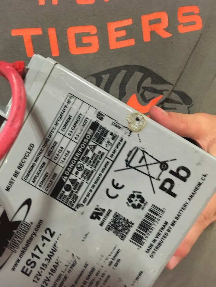

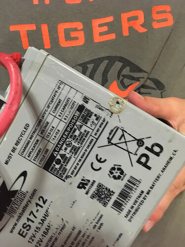

Also, here’s a battery that was punctured with a soldering iron at an event I volunteered at in 2017. I am still alive, for the record.
I’ve unintentionally drilled multiple 3/16" holes into an SLA in the robot and then won an eliminations match right after with that battery…
Should you do that? No, absolutely not.
An SLA battery exposed during the endgame is no more dangerous than the fairly common routine of mounting one vertically above the bumpers, where it could easily be hit by an intake at a combined 30+ fps.
