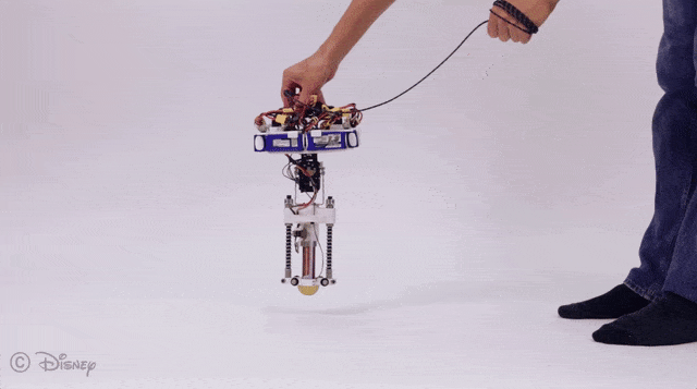

I can see it now. 1 motor swerve drive with multiple power take offs.
See I was thinking monopod…

the one-motor robot is a creation I would find joy and horror in simultaneously.
1 motor robots I can think of steer by tilting only. Like D-O
star-wars-bb8
The IRL toy does not turn well at all. The one with a rc remote actually has tiny clear casters and cheats. The smartphone app enabled one can balance but falls down a lot. On smooth flooring it works better to turn but then it slips and falls. On carpet it stays up but then can’t turn well. The head tilts on a servo and tips the body enough to turn as it drives forward. Obviously no turning in place.
Would not recommend for your FRC chassis unless you are going for a pity award. The thing looks very sad when it falls on its face for the 60th time.
But how do you tilt without a second motor?
Small servo that tilts a mass inside the chassis or in the case of D-O the head above the chassis tilts side to side. A servo isnt a motor in my mind. While servos contain a small motor it is a seperate and distinct component in its own class. You wouldn’t use a servo to drive ever because they aren’t typically continuously rotating or strong enough. So a robot with 1 true motor is possible, just also has other components to aid it, just not more motors. So when they say Only motor you’ll need. I guess that’s still true. Of course Vex and CTRE dont sell servos so there’s that issue now.
