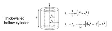

I thought this was interesting so I took a look. Of course a bullet has been designed to maximize the conversion of energy into human harm, whereas an FRC shooter has been designed to shoot a ball into a goal.
Our am-4019 has mass
m = 0.8 lbf = 0.363 kg
And dimensions
r_1 = 11.938 mm
r_2 = 41.91 mm
For a thick-walled hollow cylinder,
I = 1/2 * m * (r_1^2 + r_2^2) = 3.447E-4 kg*m^2
Kinetic energy stored in such a cylinder can be expressed as:
E = 1/2 * I * omega^2
A 22LR bullet apparently has a muzzle energy of 135 ft*lbf or 183 J
For our am-4019 to have the energy of a 22LR bullet, the speed needs to be
omega = sqrt(2 * E / I) = sqrt[2 * (183 kg * m^2 * s^-2) / (3.447E-4 kg * m^2)] = 1030 rad/s = 9840 rpm
Which definitely is a reasonable speed for an FRC shooter.
Note, a 135 lbf mass raised to a height of 1 ft above the ground also has the stored energy of a bullet!

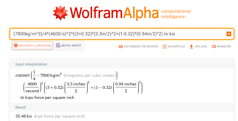

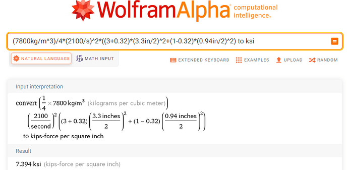

@Lil_Lavery please avoid saying ‘the vendor didn’t provide a rating, so I don’t know if this will explode or not’ and crying wolf in the name of safety.
We can do the math instead.
There are tons of flywheel stress example problems out there. It is a common calculation. Here is one that I found with clear variable/value descriptions.
AndyMark lists the dimensions and material on their drawing. The material is A36 steel, conveniently listing the yield strength in the name: 36KSI. Documentation on A36 properties is easily found from many sources.
I plugged these numbers into the stress equation and guessed 20krpm was a stupidly high speed to run. Then I dumped the whole mess into wolfram alpha (I don’t even need to understand algebra or unit conversion).
So, at 20krpm (or 2100rad/s) we have a factor of safety of about 5.
We will start to see yielding around 44,000rpm.
Even then the material is extremely ductile, with an UTS around double the yield strength even 44krpm isn’t likely to break, just stay expanded a bit.
So, children, please try to keep your AM flywheels under 44krpm. Even better, keep them under 20krpm for a lovely 5x factory of safety. (5x FoS is what is recommended for lifting rating of rope and chain, failure is hysterically unlikely at this threshold).
