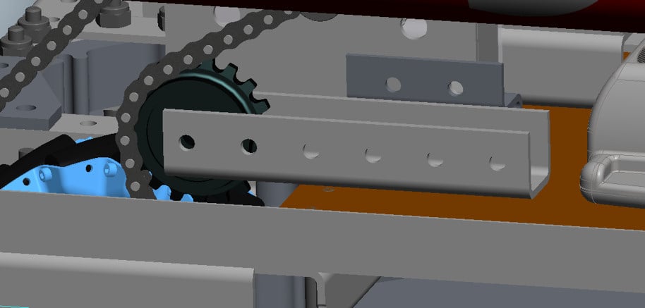

That’s typically how we do it. Last season we had the idler sproket mounted on a short section of c-channel with two bolts holding it to the frame. When we needed to adjust the tension, we put a washer under the c-channel to lift it up a bit.

You could try a cam…see the picture below. Each cam has a 1/4" shoulder bolt that acts as an axle. The bolt is drilled off center. You twist the cam into the desired position then tighten a set screw…this drives the aluminum cam up into the bolt and locks everything down.
As the delrin wears you can adjust the tension or replace the bushing altogether.
