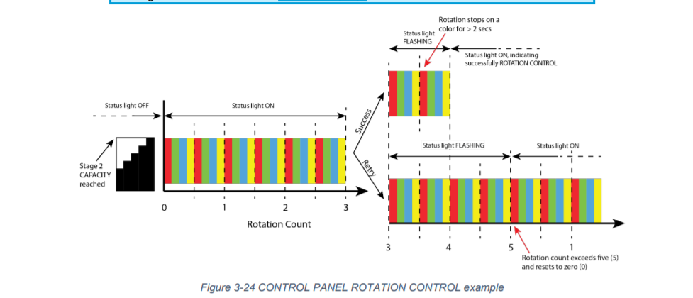

This diagram seems to strongly indicate that CAPACITY must first be reached.

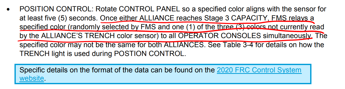

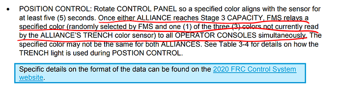

I am assuming it is sequential, based on the phrasing of these 2 rules:

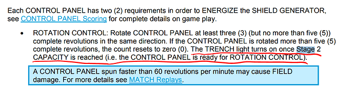

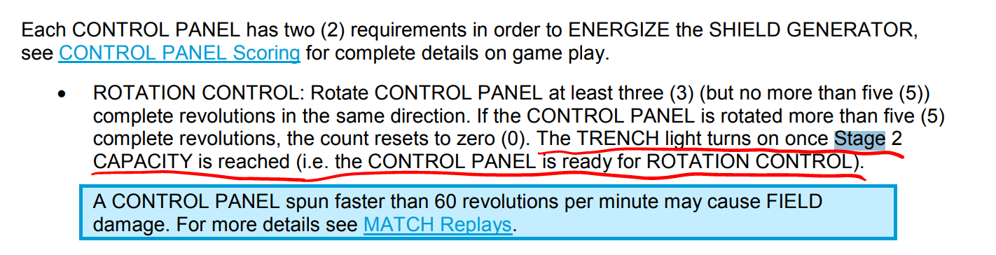

Here is the definition of capacity:
The light is off until the CAPACITY is reached, at which point it is turned on.
4.4.2, second paragraph:
The SHIELD GENERATOR has three (3) stages that need to be charged to CAPACITY and ACTIVATED
consecutively
