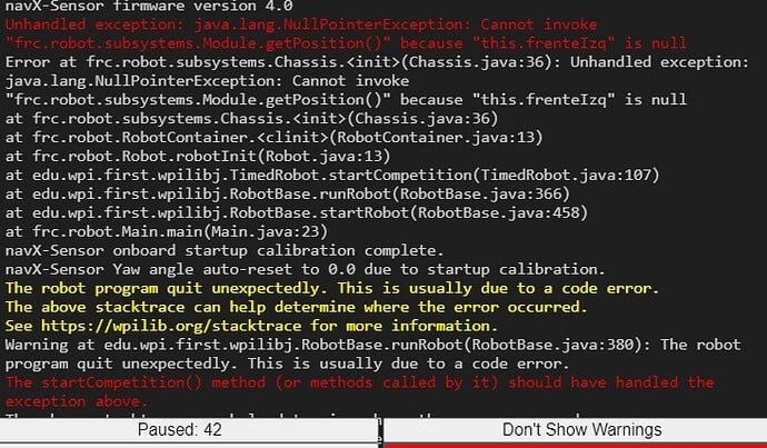

Hi everyone, its my first time doing this so I will try to be the clearest as posible.
My team is using for first time a Swerve Drive Chassis, to put you more in context we have a Swerve X that moves only with NEO’s (SPARK MAX), we also use the Thrifty Absolute Magnetic Encoder, and a NAV X. I tried to look up if i could find a solution to my StartCompetition() error, but i really dont understand wheres the error in my code.
If someone could help me please would be great, if you need more information about something just tell me. Thanks :slight_smile:

That’s not your code, the bin directory contains compiled .class files, not your source files (.java).
That said, your problem is right in that screenshot. This page should
help you interpret it: Reading Stacktraces — FIRST Robotics Competition documentation

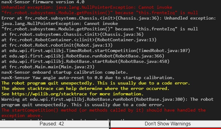

It shows you where the error is in the stack trace:
Error at frc.robot.subsystems.Chassis.‹init>(Chassis.java:36): Unhandled exception:
java.lang.NullPointerException: Cannot invoke
"frc. robot.subsystems.Module.getPosition()" because "this.frentIzq" is null
I can’t see the code you uploaded because you uploaded the compiled .class files, not the human-readable .java files, but we can tell on line 36 of Chassis.java, you try to run the method .getPosition() of a Module, but that module has not been created yet. The value of the variable frentIzq is null, meaning it doesn’t exist.
