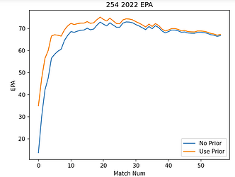

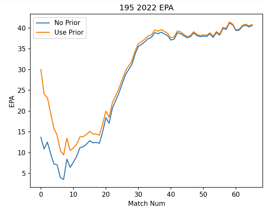

Great question! Over time match data from the current season replaces the past season projection, but it does not necessarily reach 100%. I wrote a quick script to simulate 2022 EPA ratings both incorporating past seasons and starting from scratch (Notebook link).
In 2022, using past season priors improved prediction accuracy from 76.2% to 77.5%, with most of the advantage coming early in the season.

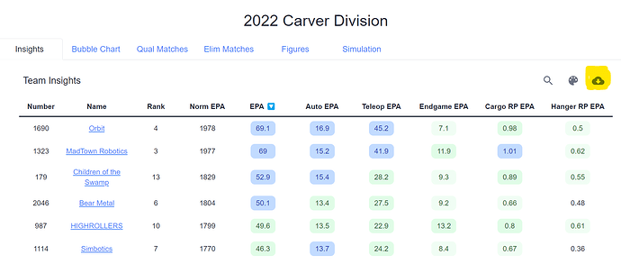

Many of the tables on the website can be downloaded into a CSV format and opened in Excel or with a programming language. One of the most useful tables is the event insights table. This is probably the best way to quickly integrate Statbotics data with your own scouting data.

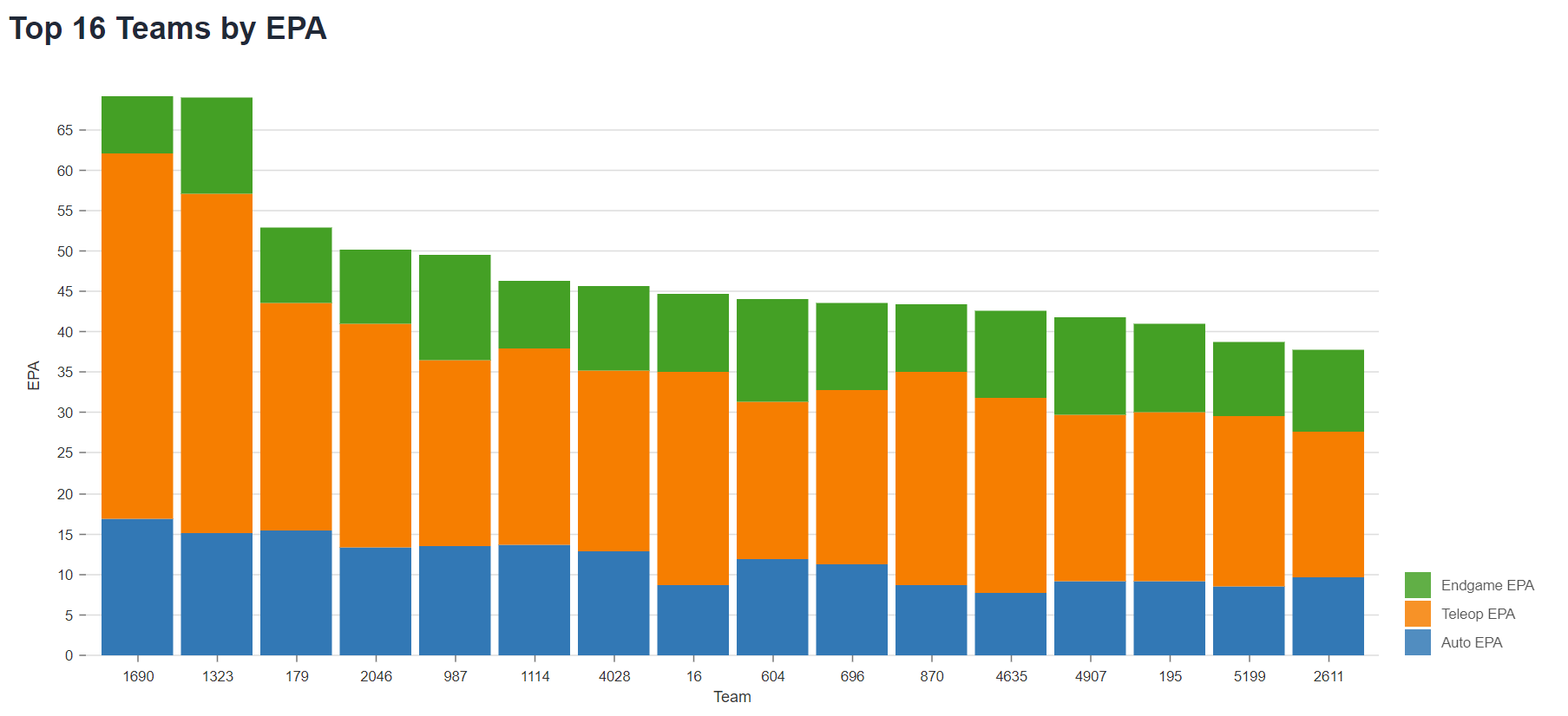

There are also several visualizations available directly on the website.
If people have suggestions on helpful visualizations, I would be happy to add more.

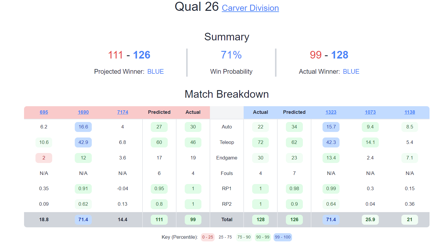

For a specific match, Statbotics provides pre-match score breakdown estimates, and updates after the match to include the actual results. This could be helpful for pre-match strategy.
