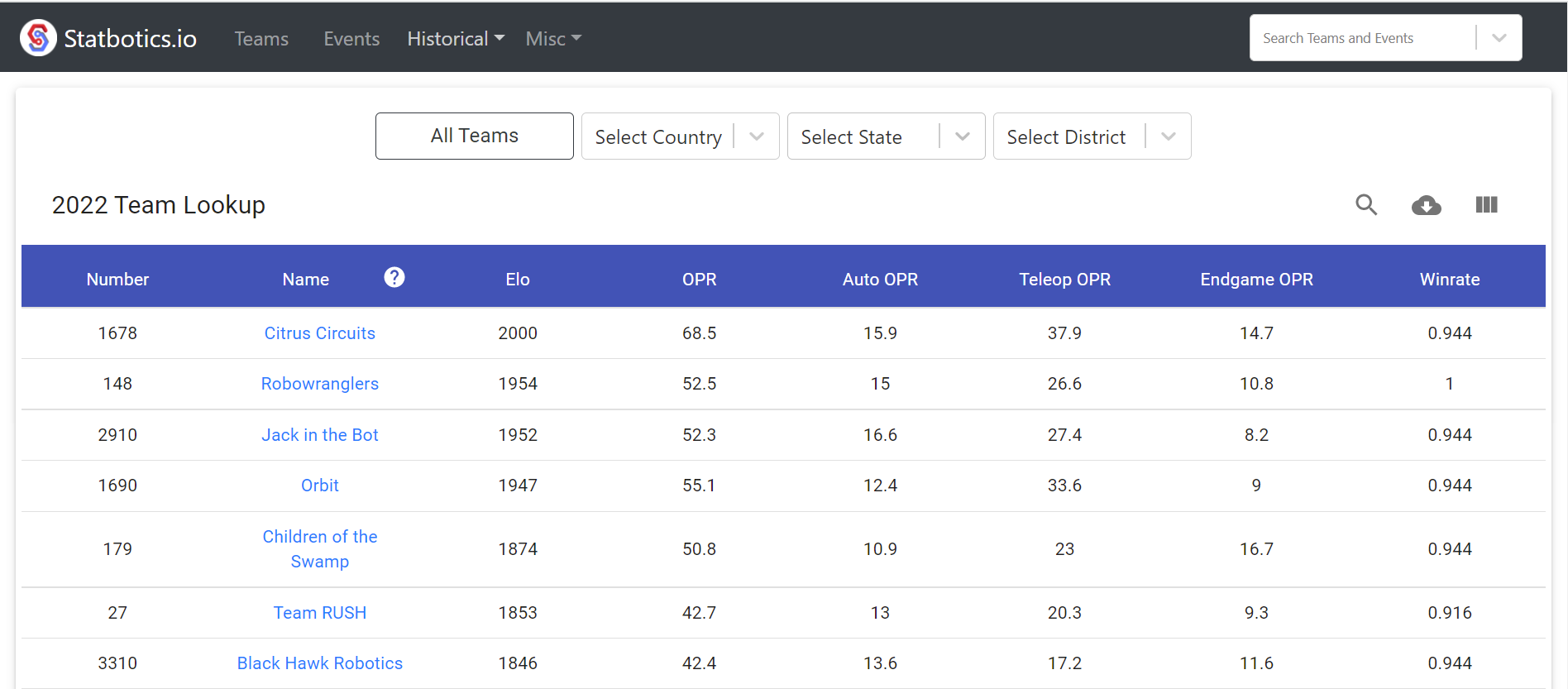

2022 Global Elo and OPR Rankings
Stay up to date on the most dominant FRC teams this season. So far, 1678 has already hit an Elo of 2000, and five teams have an OPR of at least 50. Check the full page out at Teams - Statbotics.

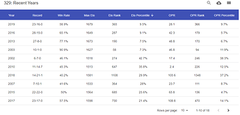

The percentiles are backwards. Percentile is the percent of other items in the population that are below that item. Said another way, what percent are you better than. 99th percentile is very good. Also, the percent sign is generally not used with percentiles, since it’s not expressing a portion of a whole, but rather a place along a scale.

Looking at my team: Team 329 - Statbotics :
When sorting by ELO percentile it looks like you are treating those as strings not numbers so the sort is off. It looks like the same situation with OPR percentile. Other than that, I am spending WAY too much time playing with this site.

  • Percentiles (and sorting) on the team pages have been fixed @zeta @Matt_Boehm_329

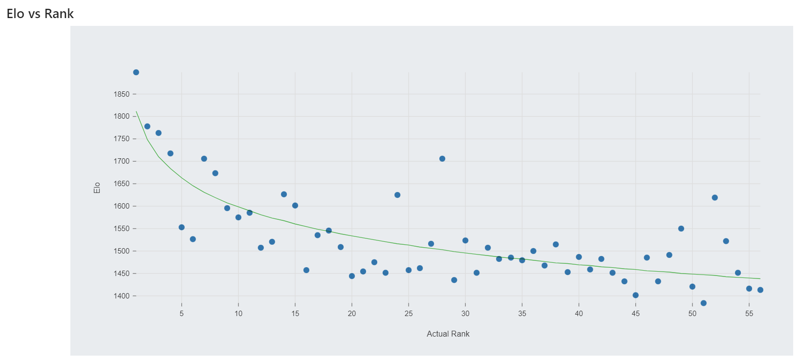

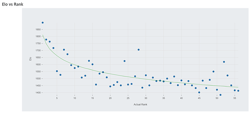

  1. Elo vs. Rank and OPR vs Rank graphs:
For ongoing (and completed) events, a scatterplot of Elo/OPR vs rank is included. This may be useful as an additional data point when looking for alliance partners.

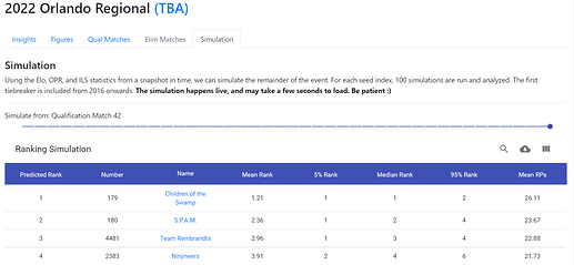

  1. Event Simulation
The simulation page takes into account upcoming match win and RP probabilities to forecast the remaining schedule and compute ranks. Teams can use this page to estimate their rank and think through alliance selection scenarios.
Note: I have observed the RP predictions are generally underestimates as the model is still learning which teams can consistently hit the RPs. A similar TBA feature exists, but it does not take into account Elo to my knowledge.

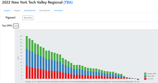

Terrific site! On the Figures page for events, is there any chance of getting the OPR graphs for more than just the top 15? That is such a nice representation.
That’s a great suggestion, I have gone ahead and implemented a button that toggles the chart between top 15 and entire event. Let me know what you think!
See for example: statbotics.io/event/2022nytr
That’s awesome! Thanks so much. Also wild to see the graph turn upside down there at the end!
