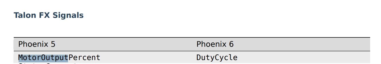

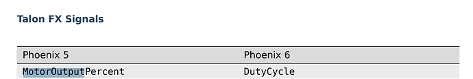

One more thing, what’s the command for getMotorOutputPercent in for TalonFX?
Not completely sure, maybe getDutyCycle()? All of the TalonFX methods are here CoreTalonFX (CTRE Phoenix 6 Java 24.1.0)
can confirm:
sourced from this extremely useful pdf: https://pro.docs.ctr-electronics.com/_/downloads/en/latest/pdf/
it solved all my migration issues in like 10 minutes
