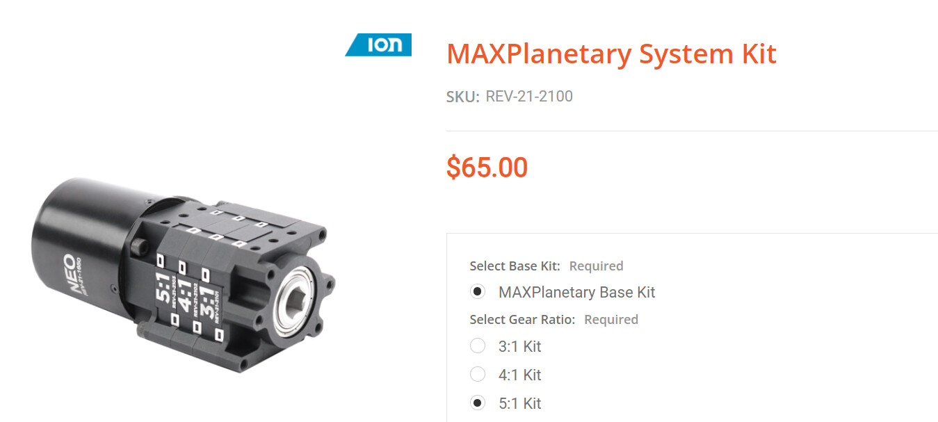

Kitbot Climber

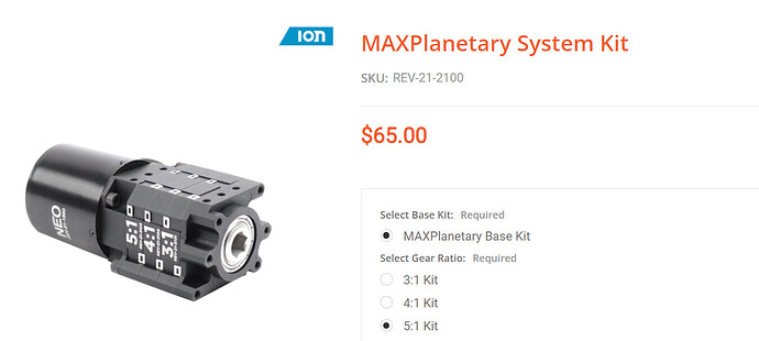

We wanted to make an mvp climber using things that teams will likely have already. The solution we came up with is two half inch wood panels with a 1/4 inch slot milled into them to accept the chain and a few curves to help guide the chain into the slot. It’s powered by a Neo on a max planetary gearbox that many teams will have from the Everybot last year. We did have to switch out one stage from 3:1 to 5:1 (125:1 in the end) so it wouldn’t backdrive, and we used a second output faceplate so the shaft was not cantilevered. We attached a ratchet strap directly to the hex shaft with a bolt and washer through the side of the hex shaft, and added elastic to keep the arm raised.
We just finished making the video of us talking about our kitbot climber and amplifier modifications, as well as our prototyping process and shooter for a separate robot.
I have been trying to answer any questions on the videos, but if you have general questions feel free to ask them here as well!
I love this! its a great way to modify the kitbot to easily increase its versatility. By using the kitbot, any new team can make these same modifications. hats off to you!
Nice job on your ri3d bot as well.
Glad you like this the team, especially kevin spent a good chunk of time on thinking through really simple economical improvements.
We will be sharing DXFs etc of the climbers shortly- ( kevin is getting some well deserved sleep, and i am trying to catch up on real work )
I really would love to see that climber on a lot of kitbots, I think its just so cheap and easy to implement. It can be implemented by only having to buy another Max planetary base kit, and a 5:1 stage if you have last years parts
