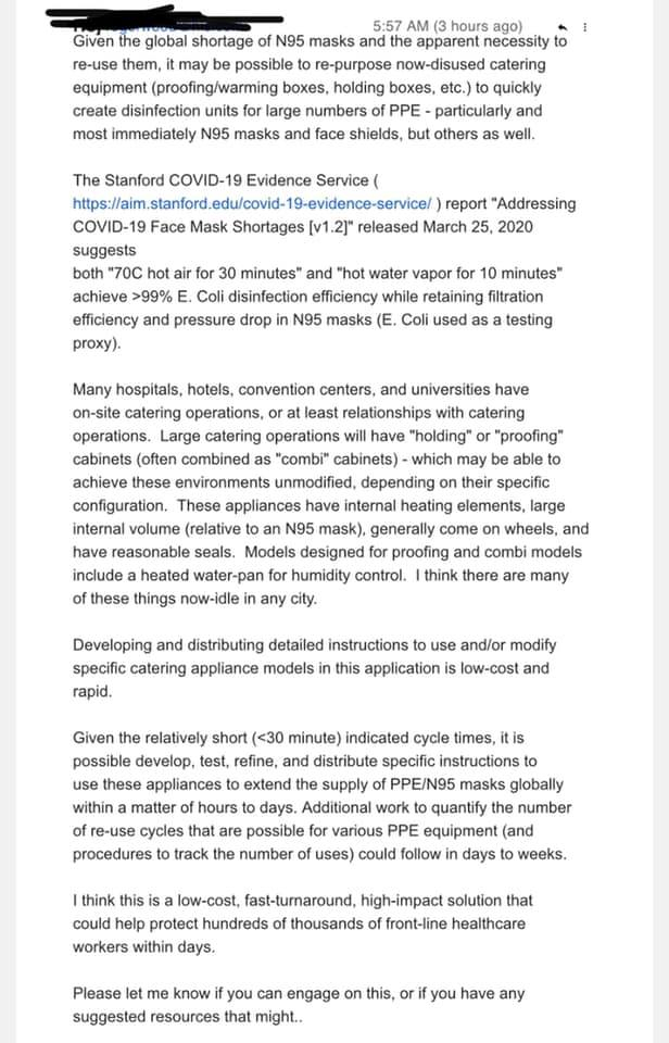

A good solution might be establishing disinfection protocols using catering equipment.
Apologies for the copy-pasted email - takeway: Steam for 10 minutes or 70C bake for 30 minutes both show efficacy in killing e.coli (proxy for 'Rona), catering equipment is natively capable of those things, catering is not being done right now in many US cities, perhaps idle equipment becomes disinfection tool?
High impact, a day of reprogramming and protocol development becomes weeks of mask reuse.
