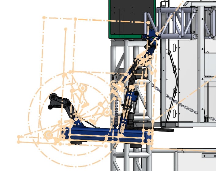

I run an educational design community, and I’ve designed a trap robot for this game and posted the progress here.
It’s unbelievable how many teams I’ve talked to that are going for the trap as a “must have,” not knowing how ridiculously hard this objective is… for not that many points, and the opportunity cost is much greater. Compared to previous endgames, where you can reserve space (2022) (2019), cheesecake it onto a different mechanism (2018), or literally drive onto a platform. (2023), the trap requires you to design your entire robot for an RP and a few extra points around this objective. A single mechanism needs to perform 2+ functions, and the height limit, extension limit, and height of the chain make the design process incredibly difficult if you don’t plan for it ahead of time. The geometry is stupidly hard, but it looks easy. Try designing/planning for it, and it’s so much harder than it looks.

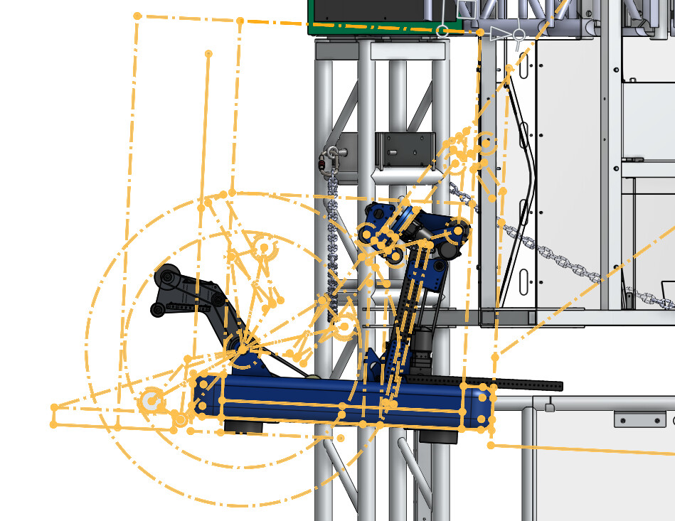

For context, the top line is the height extension limit. That’s the lowest I think you can feasibly go (look at the location of the chain), and maybe design two rollers to sneak into it. But then you start being too tall to fit under the stage or break another rule. I usually want it to be a lot more comfortable though.
Here’s what I had to pull in order to make it work.
Note how I had to design the entire shooter/amp mech on top of an angled elevator (a lot of complexity), then have to do two handoffs. The chain is almost against my bumpers.
It’s not to say that climbing the chain is the biggest barrier, it’s just that climbing and lining up for the trap also take time.
If having to get 2 amp scores is a knock on the speaker, then climbing is a knock on the trap. Not to mention, 2 amp scores amplify 4 speaker scores. You need 3 climbs for 3 traps. And 3 is the max number of trap scores you can get.
