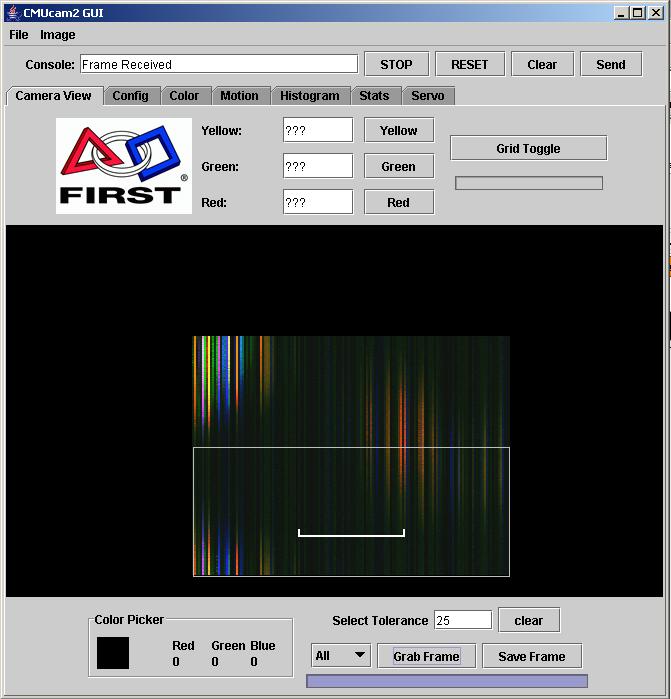

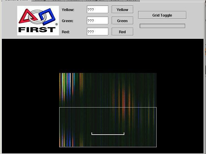

We’re experimenting with the CMUCam and have everything hooked up. There are no problems other than that the image recieved by the GUI app is completely messed up. We have gotten it to show the basic shape of an opject held in front of it, but no real image like that in the getting started guide. Any ideas?

oooh! I had this same problem, check the baud rate and stuff on your serial port, go into the device manager and find the entry for com devices, then right click on the com port and go to properties, then under I think the second tab (sorry, not on my windows machine atm), make sure those setting correspond with the ones they give you on like the third page of the start here manual. this fixed my problems, the com port defaults are probably NOT what CMU cam requires

From the troubleshooting part of the manual:
 I get wavy lines or a distorted black and white image when I call
 dumpframe:
 This is most likely due to power. Make sure that you have a high enough voltage
 and that you are getting a clean signal. Running the camera off of fresh batteries
 not an AC adaptor) is a good way to test if this is the problem.

Ours is working fine, but we cannot connect when it is also connected to the robot, so make sure something like this is not happening. Also, as mentioned before, check all power cables and make sure your baud rate is set right. If you have one, try testing the camera through a usb-serial adapter. While I have had problems with these when programming the robot before, we used another team members laptop equipped with an adapter today for the GUI, and it worked fine (although it was not COM1, rather COM4 but this probably varies). If this way of communication works, you will know that your standard serial connection is malfunctioning or not set properly.
Ah yes, I also changed the battery, both of which may help. Run a volt meter to it and make sure the battery is giving you at least 7 volts. (The backup battery of course)

I just got home from today’s meeting, and am happy to say that the cam now works. We tried a different computer. We thought that it was some kind of unknown fix, but after reading this thread the real problem is clear: battery! We had been using a backup battery with an unknown charge state, but we charged it today during school. Now we can take horribly-colored photos of everyone on the team (only in bad light)!

The picture you show is a classic example of a camera that has been dropped. If you try all of the suggestions above and still have the problem, I would suspect the the CCD has been damaged or the connections have moved due to an impact with a hard surface. Check (with power off please) that the camera is seated properly on the mother board and no pins are bent in any of the connectors. The picture is an indication that there is no sync between the pickup pixels and the output. Does the image change with objects moving in front of the lens? If it does than I would suspect the camera.
Thanks for your suggestion, Al, but I posted yesterday that the problem was fixed by charging the backup battery. We were beginning to think it was the CCD, but thankfully the issue wasn’t that permanent.
