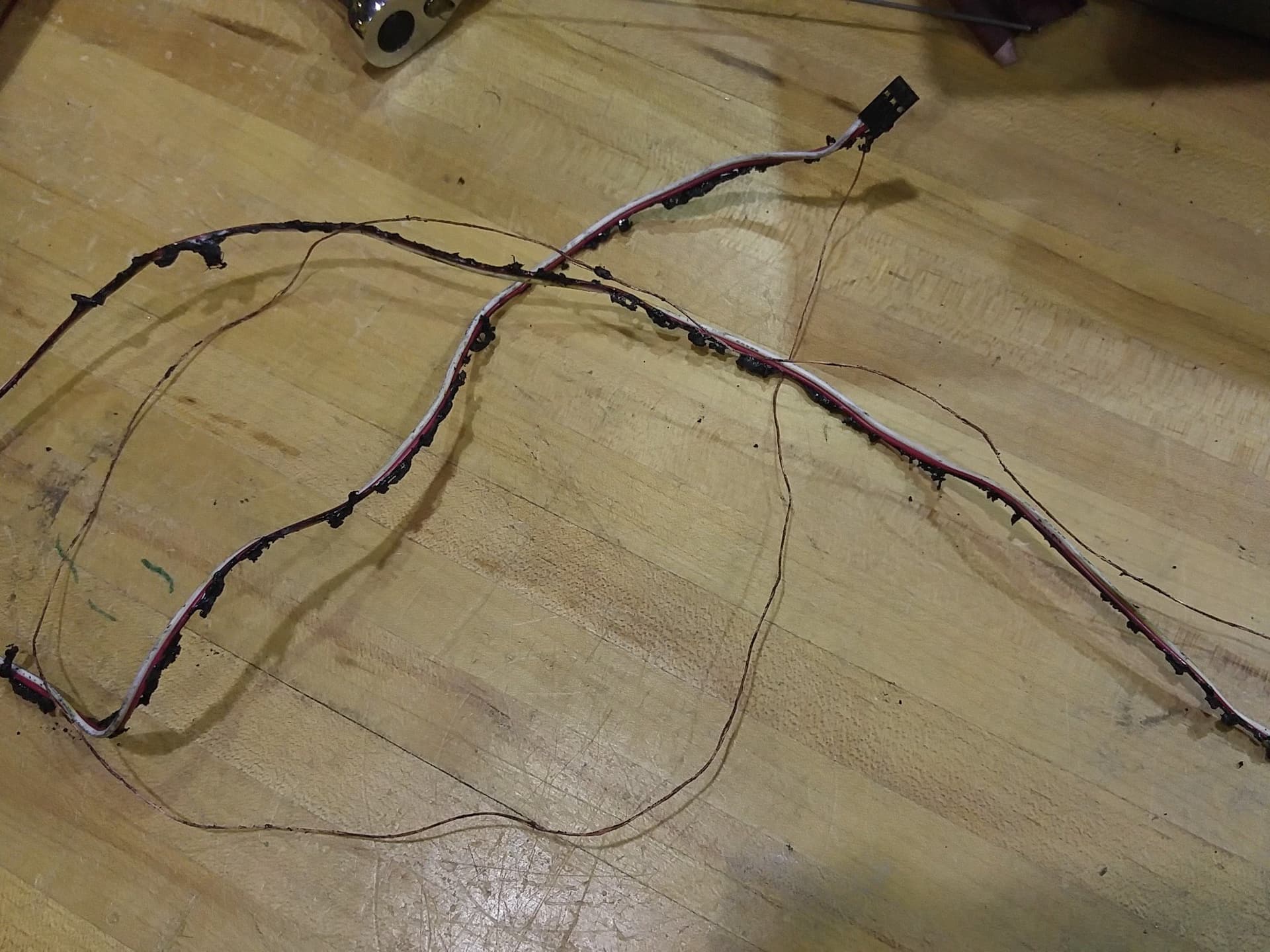

One of the PWM signal lines on a spark motor controller got loose of its zip tie and crossed both the M+ and M- screw terminals. The wire insulation smoked like crazy, we thought it was much much worse than it really was. In our panic and the field staff panic we didn’t hit the estop right away. The driver couldn’t see what was happening really and didn’t know to stop driving so they slammed into the other bot on the pad. A ref finally came over and told them to estop. Definitely was panic inducing and needed the fire extinguisher. “Batman” (I think Adam?) the FTA saved the day
It happened right at Endgame. We are on the left side of the field near the gate

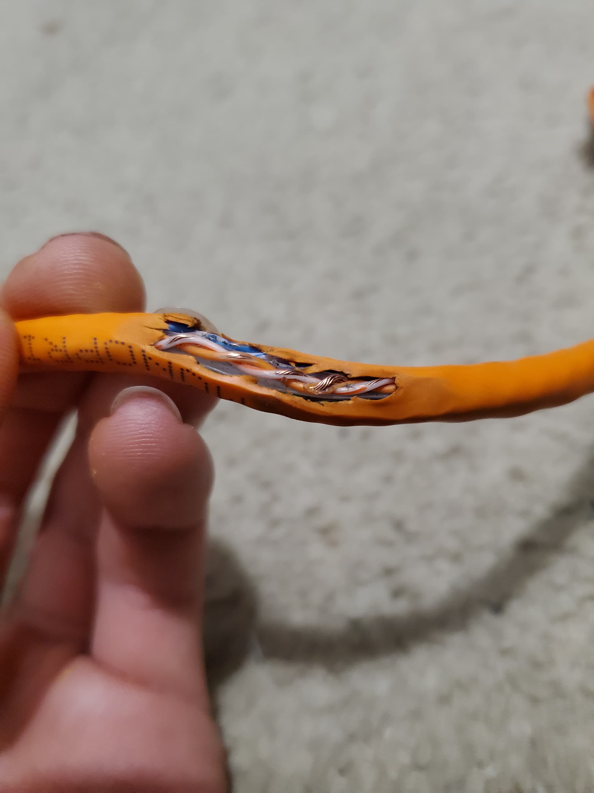

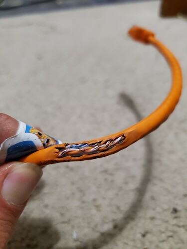

Our 2022 bot’s ethernet that went from the radio to the switch. The wiring last year was so insanely compact the ethernet had to be within millimeters from the drivetrain chain (as well as the 6awg that went from the pdp to the battery). They touched during sdr I guess, but it still all worked so we were chilling. Pneumatic tubing was also within millimeters of the drivetrain chain

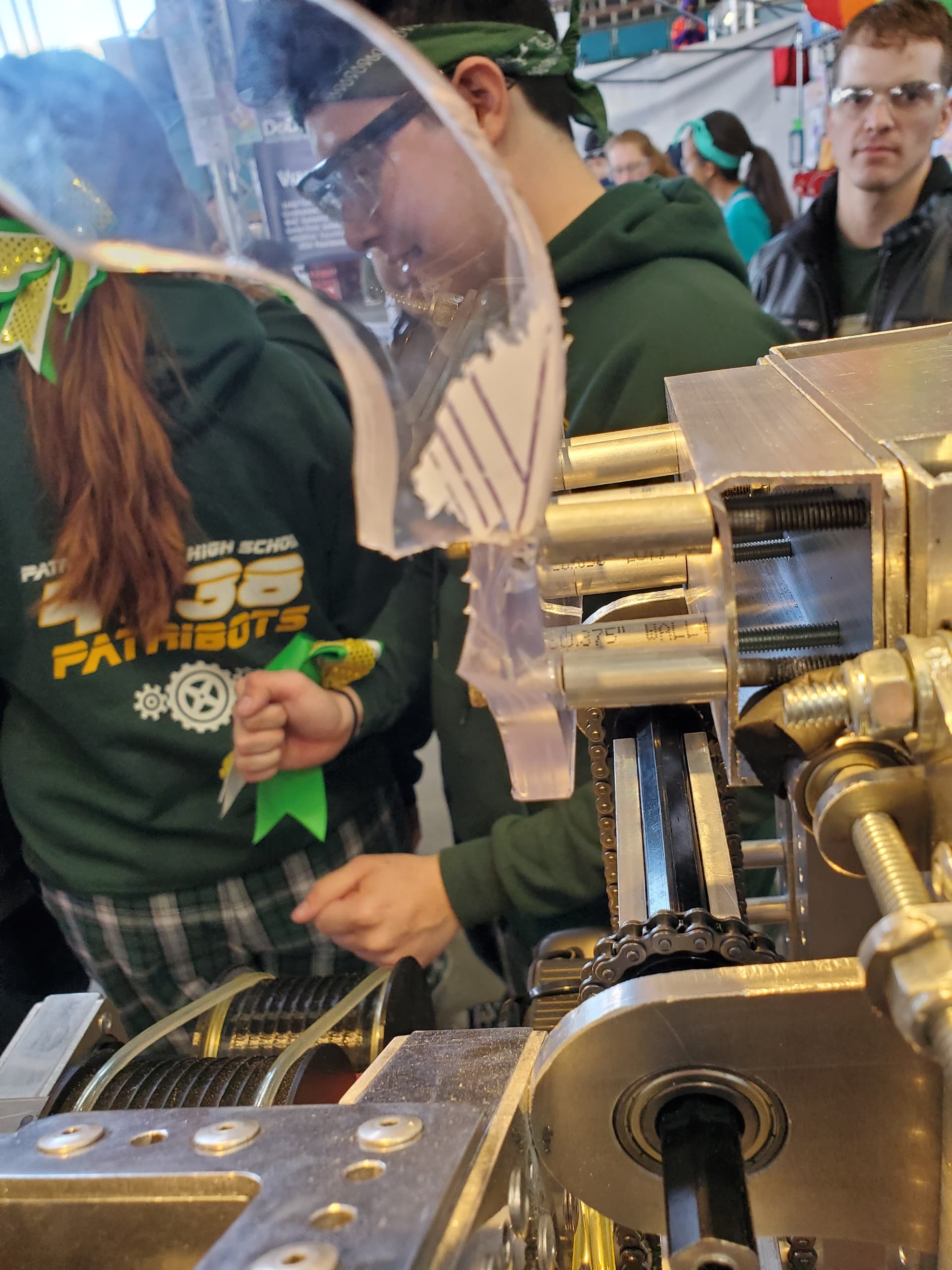

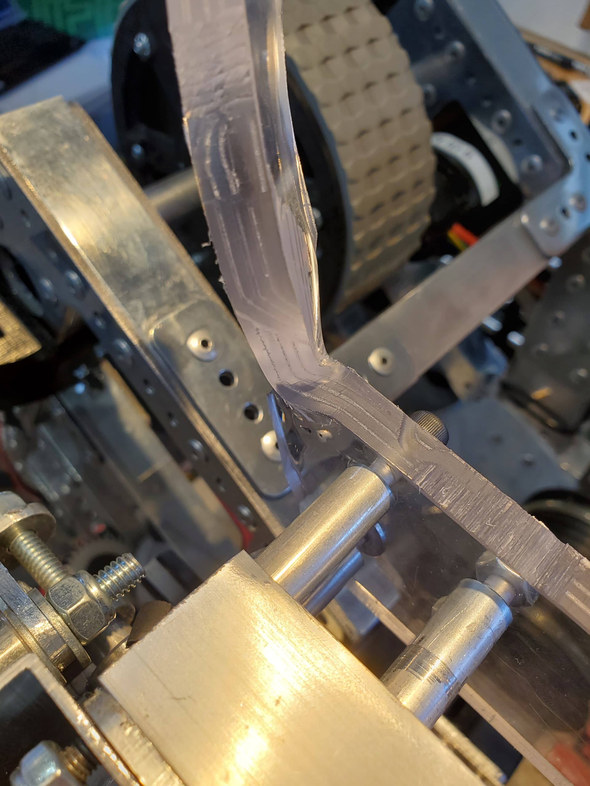

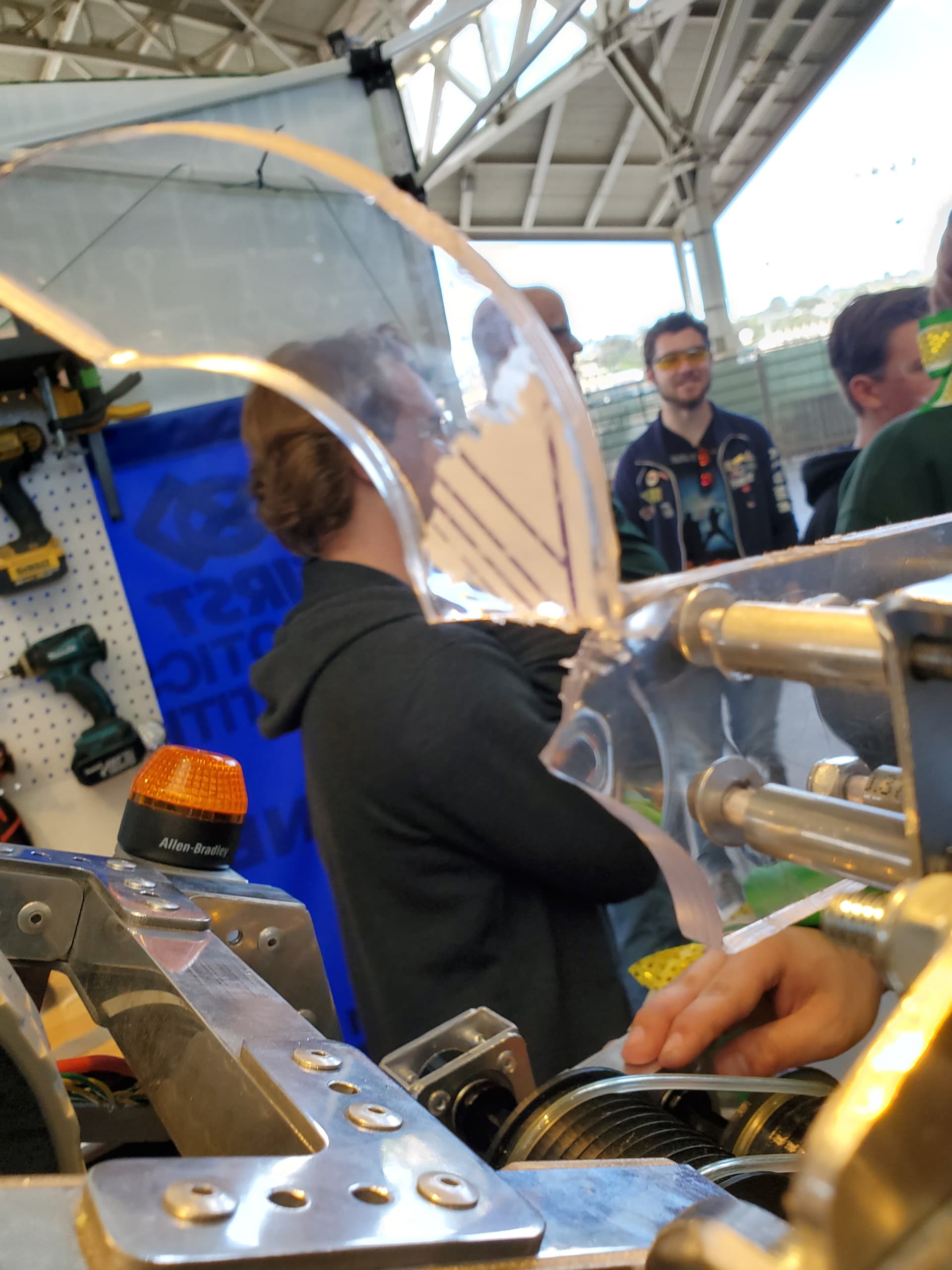

In 2022 we were testing traversal in a practice field and somehow we snapped lexan and bent our climber in a box. That’s not all, the piece that snapped flew up and almost hit the person managing the practice fields. They came over and handed it to use. Whops :upside_down_face:

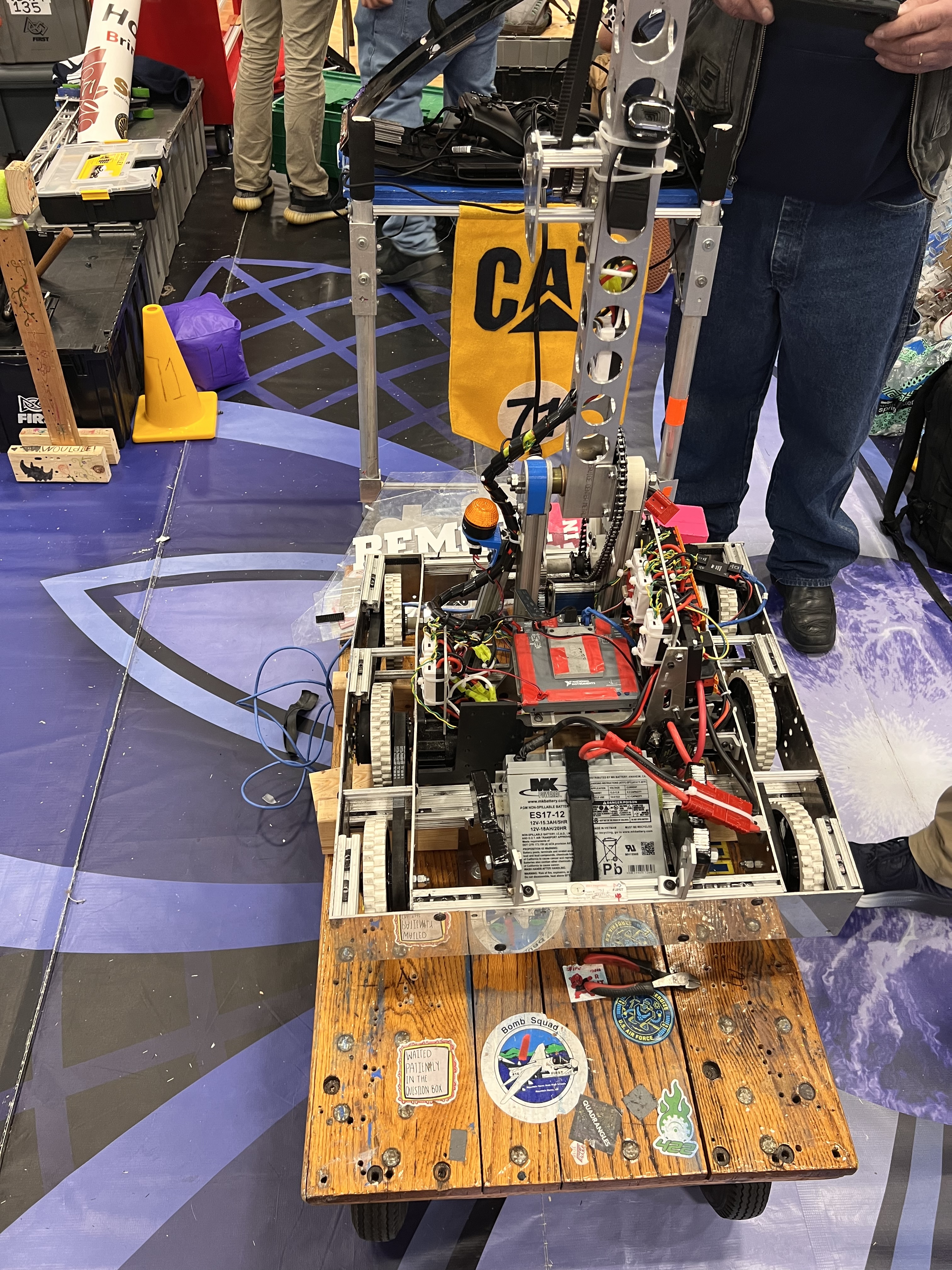

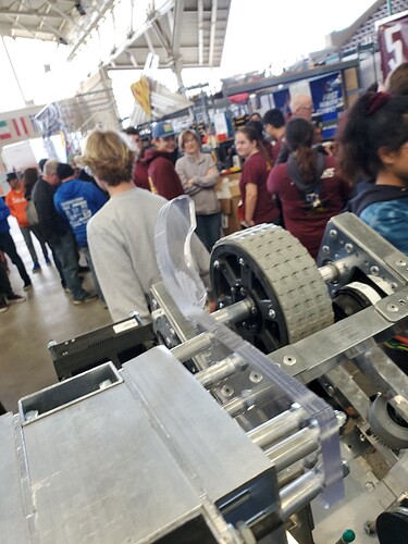

At FIN Greenwood, we took a friendly fire hit that torqued our frame. We had to rebuild the entire chassis this time in 1/4” aluminum within 3 days. Take a look at the top left corner of the robot in the picture.
