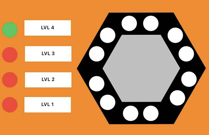

Rather than defining specific “zones” you could define the points you want your robot to align with and determine which is closest to your current robot pose. This seems to me to be the simplest solution, hold down a button and align with the nearest point. You’re right it could be difficult for the driver to determine visually which point they are closest to at the edges, so you might need the driver to get close to the points before auto-aligning.

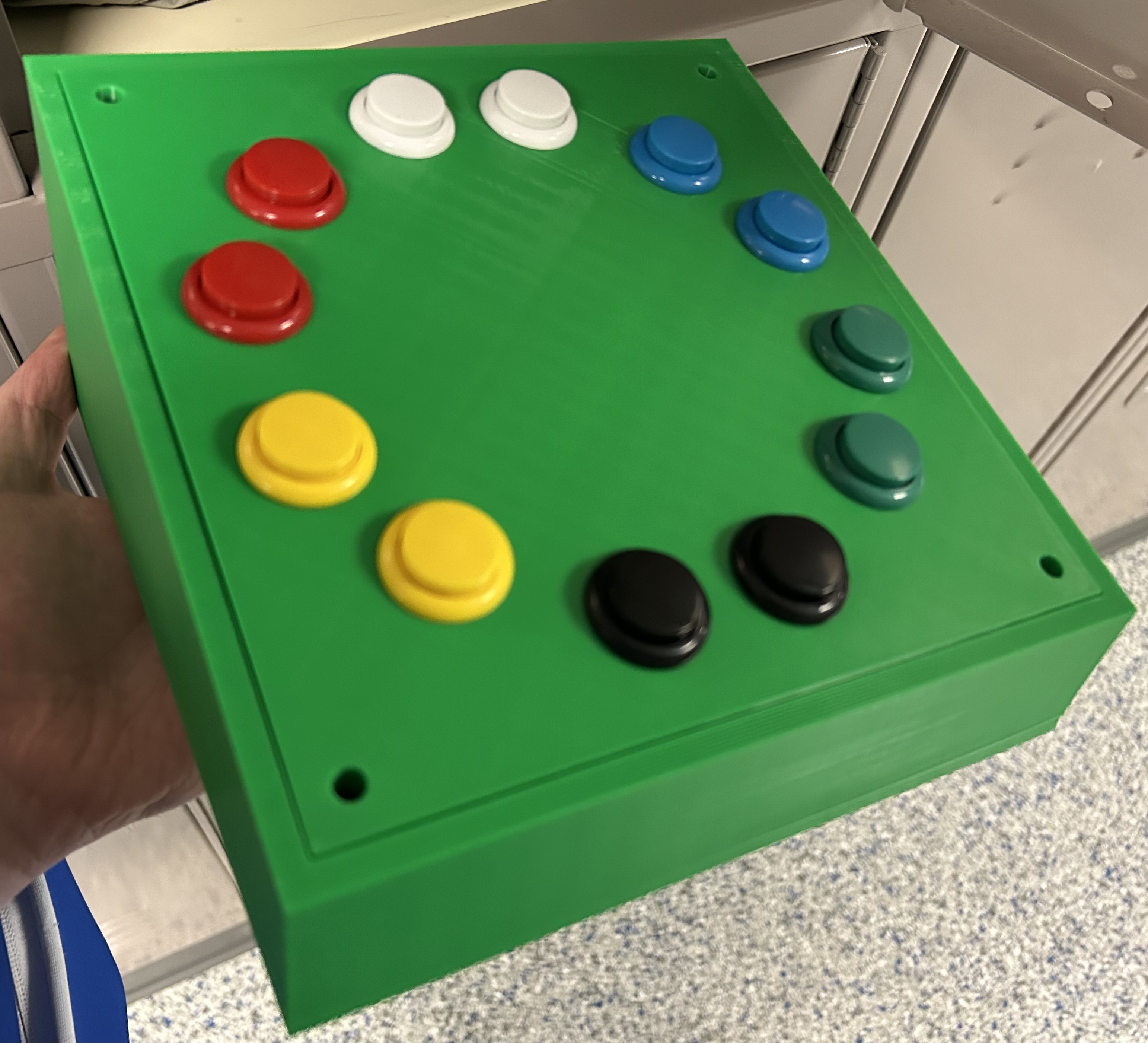

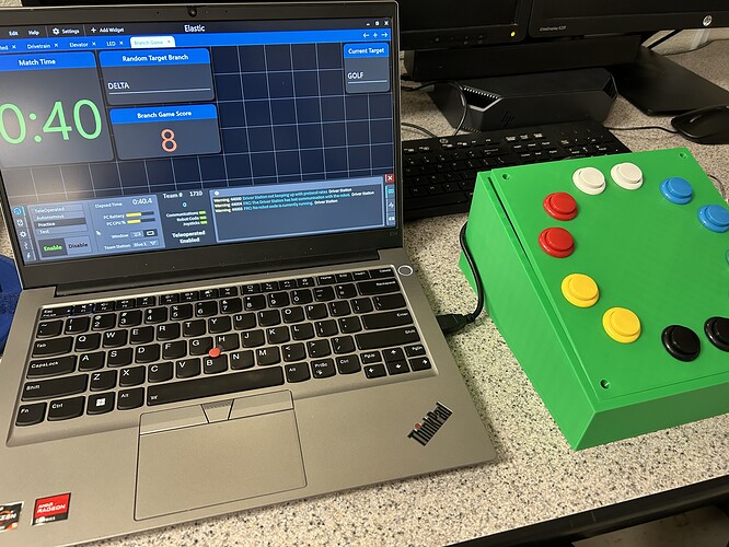

We’re making something pretty similar to that to select branch (and hopefully level) targets so that the driver only needs to use one button for automatic alignment and scoring. Having the targeting controller is nice because it lets us save cycle time by pre-rotating while we move to branches on the opposite side of the reef, opens the door to pathfinding routines that don’t rely on reef AprilTags, and we’ll still be able to automatically rotate to a target if our cameras go down. Here’s the prototype:
Edit: A targeting controller is also pretty useful for memorizing branch names! You can setup a game to practice reacting to callouts.

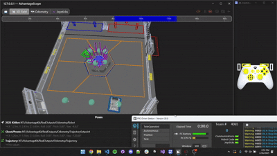

How did you add these lines to advantage scope? Did you draw them in the cad and import a custom field?
Code release will be end of season but I’ll post a lay-man logic to implement this on my team (4065)’s instagram.
Thanks! I used poses to create a trajectory and logged it to display it.

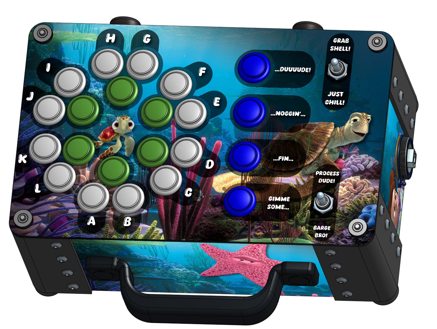

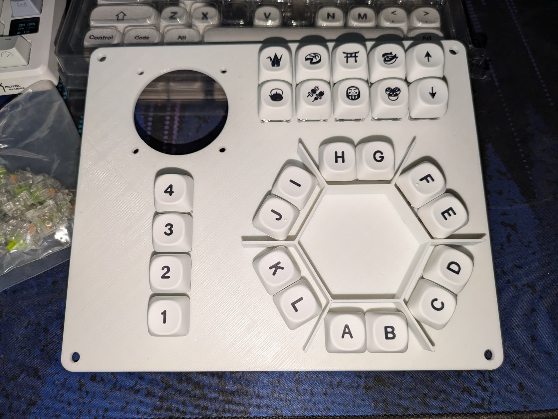

First prototype concept for our new control board (empty spot is for a joystick). We are trying some mechanical keyboard switches instead of generic momentary buttons. I think the angled sides of the reef buttons should probably have the buttons rotated for easy reading.

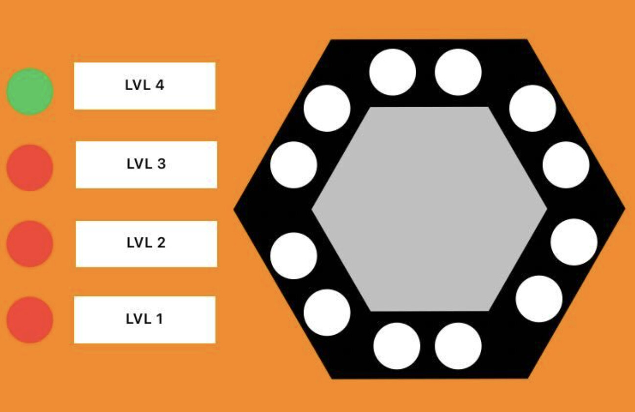

Our team is deliberating over a button board, with 6 different buttons for each 1/6 of the reef. The robot would create a trajectory, and while following, using the pinhole model of the camera, can see which of the spots on the 1/6 of the reef are already taken by localizing the coral. If there is a spot available in L4, unless other specified with another button, it will score in L4. However, if both L4 are taken, it will switch to L3 (etc.)
There will prob be override buttons if we want to score on say L1 no matter what.
If both spots on a level that the algorithm wants to score on is open, it chooses the branch closest to it, and alters the trajectory goal.
Haven’t tested this yet since the LL model for Object detection isn’t out, but look forward to trying
