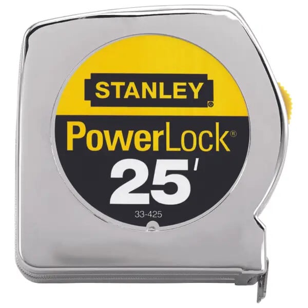

Better is a nice tape measure works well. It might have been this; get a good spring. We printed a case for it to mount it and the potentiometer.

3946 used a tape measure in 2015. We disassembled it, glued a radio knob to the spool with the shaft engagement facing out, cut a hole in the side of the tape measure case and reassembled. Finally, mounted a 10 turn pot from (IIRC) Mouser. It worked for a while, but was a bit fragile.
