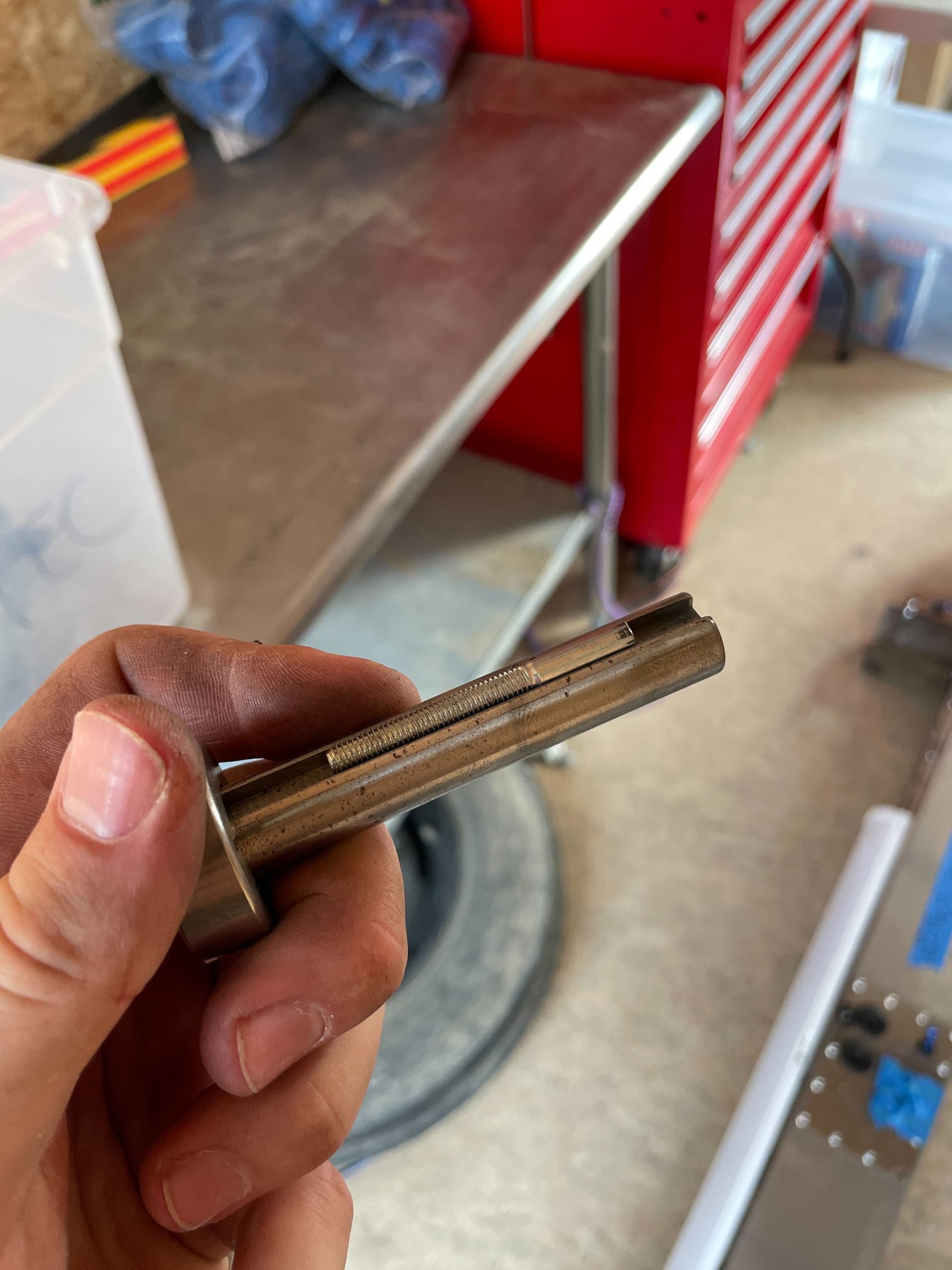

It’s just the cim style key, but we need it very soon and don’t have access to any machining equipment

@theovandermarck - You could go from 5/16 stock as suggested to 5/64 pretty quick with a file. You could even start with a small screw and file that square. If you can buy a piece of metal and a file, you can make this happen.

Thank you all for your help. In the end we settled on cutting apart a 5/64 alan key which is currently working.
Pocketing this info for later. That’s a great fix in a pinch, let us know how it holds up over a longer term. I’d be worried about the hex v square shaped but if it’s working don’t question it.

Update: We showcased the bot for a weekend, running all of the motors and subsytems at full speed, and it’s held up very well! We haven’t physically checked on it, but it seems to be perfectly fine. We will definitely be doing this if we’re in a pinch at a comp (although knowing the FRC community I doubt it would be hard to find one to borrow).
