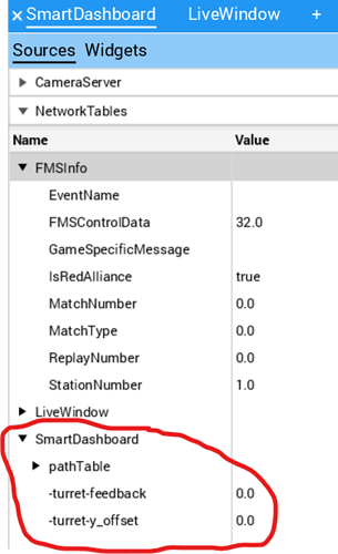

Hello CD,
I’m having a hard time reading subtables in Java.
In the photo, I have the subtable “pathTable”, along with 2 basic entries “-turret-feedback” and “-turret-y_offset”.
I can read the 2 basic entries by writing:
private NetworkTableEntry turret = SmartDashboard.getEntry("-turret-feedback");
turret.getDouble(1.0);
However, when I change “-turret-feedback” to “pathTable” such that I am accessing a subtable rather than a double, there is no get method for turret to read its value.
Also, when I do:
turret.getKeys().toString();
it prints the turret feedback and offset, but not pathTables.
It’s like it doesn’t recognize the subtable as part of Smartdashboard.

Fundamentally NetworkTables is a flat namespace. Subtables are completely notional things and not actually stored as such, but rather just prefix the entry key with the subtable with “/” separators. For example, SmartDashboard → pathTable → -turret-feedback is actually stored as a single string “/SmartDashboard/pathTable/-turret-feedback”. This means you can’t actually “access” a subtable. You can only access the individual entries within it. All of the functions like getSubTables() work by seeing what keys start with that prefix.
The SmartDashboard class also prefixes all entries it creates with “/SmartDashboard/”. So SmartDashboard.getEntry(“blah”) is really accessing the key “/SmartDashboard/blah”. The raw NetworkTables functions don’t do this. That’s why your third bit of code doesn’t work… it is accessing “/pathTable” not “/SmartDashboard/pathTable”.
