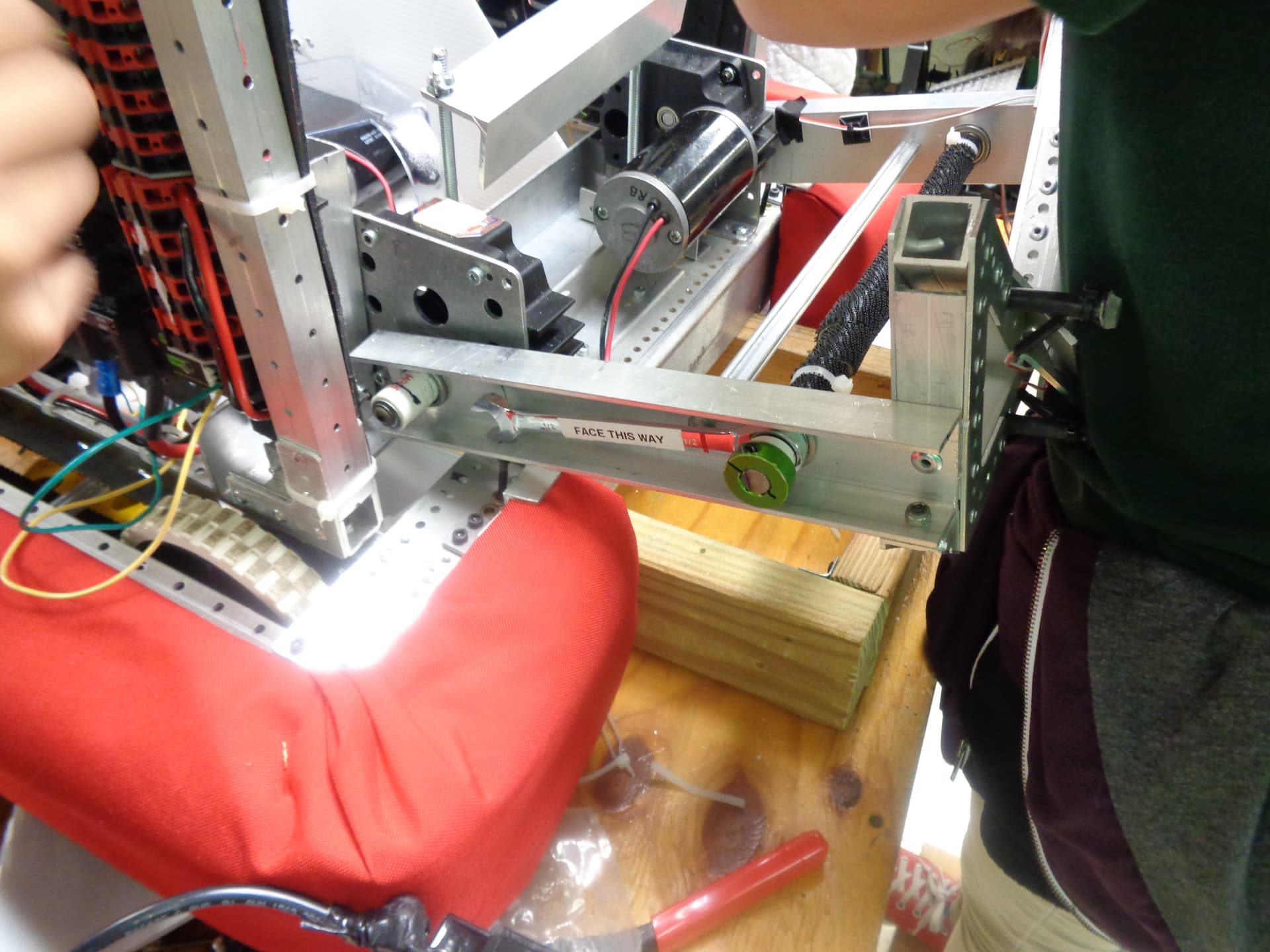

Did the same sort of thing on the rope climber in 2017:
We later ditched the green shaft collar in favor of a velcro strap. The neat thing was that we didn’t unlock the ratchet, we slid it off the end of the shaft. The other neat thing was that running the shaft in reverse lifted the arm into place; we didn’t need a motor in the nearer TB mini gearbox.
