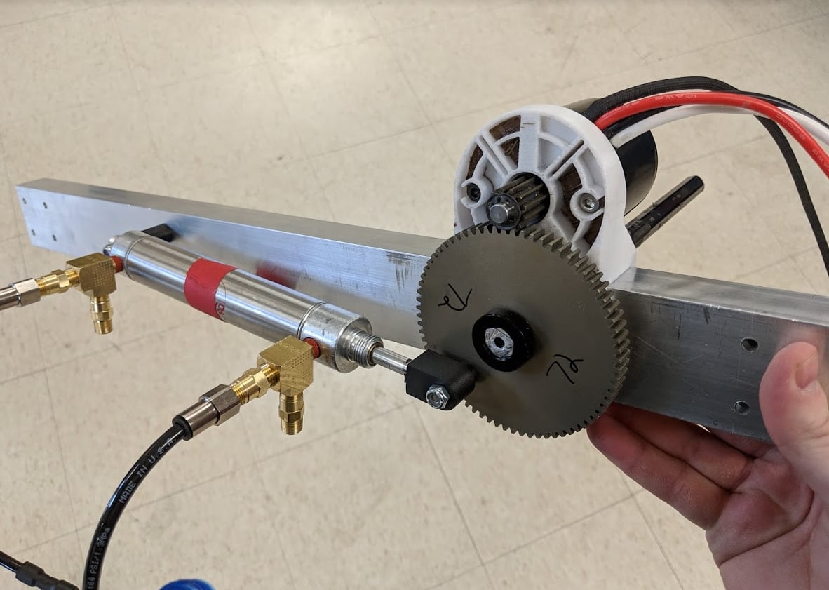

Deep in our back pockets we’ve had the ‘turn a pneumatic cylinder into a vacuum pump’ trick ready to go. When we strongly considered trying it for game pieces, we decided to fab one quickly so we could get to prototyping. We used a NEO/Spark (because of the USB interface allowing easy speed control), a 1-1/16" x 3" stroke bimba cylinder and some printed parts.
It was pretty amazing! We calculated the rough CFM to be about 4, which is a large amount of air to move for a vac pump. With a vac gauge we measured 25-28 in-Hg of vacuum which was pretty promising. To make the system work we needed to use a series of check valves to stop flow, and it pretty quickly started to get confusing, so we made a little block diagram for ourselves to document what was working.

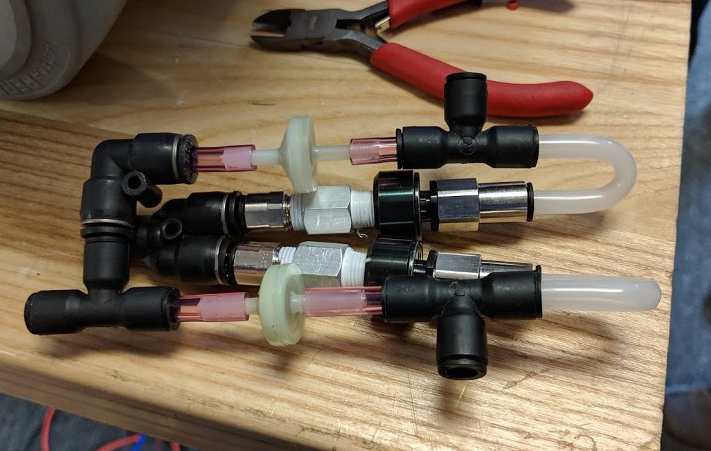

The solution to this were “AQR” valves made by Piab. https://www.piab.com/en-US/products/suction-cups/suction-cup-accessories/suction-cup-valves/aqr---atmospheric-quick-release/
They’re pretty awesome little devices. Essentially you apply compressed air to the valve, and as long as you do its shut and vac can generate. If you remove compressed air, it ‘pops open’ at a rate of 7CFM to atm and lets the cup release what its holding. Ideal for our application (demo below).
Below is an image of the ‘Suction End’ of the system. You plug in 1 line from the vac pump, 1 line from a solenoid (for the AQR release) and 2 suction cups. This was hidden up inside the little prototype suction grabber.

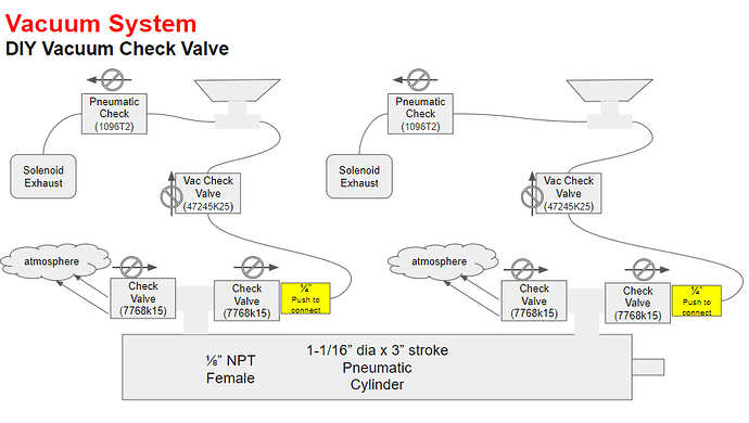

It was actually one of our students who went off and started the block diagram with the idea of having to explain this to an inspector in mind.

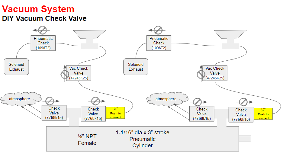

Looking at this diagram I have a couple questions. Do the check valve arrows mean the direction air can go or the direction air can’t go? Since if it’s the direction air can go, then I don’t see how the cylinder would vent to the atmosphere.
What do you mean by “do its shut and vac can generate”? I don’t see any compressed air entering the system in the video which is how you said these valves work. All I see is someone turning an exhaust valve.
As for this setup, I can understand that the two tee-fittings on the right are where the suction cup attaches to. On the left is a tee-fitting and a y-fitting. To which one does the vacuum pump attach and to which does the solenoid. What exactly does the solenoid do and how is it setup?
As far as the suction cups go, where did you purchase them from and how did you install fittings onto them. I was on SMC’s website and was confused how fittings would be attached to them. How did you choose what type of suction cup you needed?
I know these are a lot of questions but suction is so cool. It is also very confusing.
This is the confusing part, because ‘you’re creating vacuum’ I think your mind tends to think that the ‘thing you’re creating’ is what you’re trying to quantify. So when you start quantifying it with a diagram that depicts the actual flow of air, its all backwards for vac. I suppose this is probably NOT the smartest way to draw this out - the arrows with cross out marks represent direction air cannot flow. It was labeled like this because it tended to be the easiest way to think about it when someone was trying to build the system with physical parts in hand (which way to assemble each check valve).
Wow terrible grammar on my part. I was trying to say “…and as long as you do, it is shut, and vac can generate.” Essentially meaning it will hold the valve shut (vacuum will generate) as long as 60psi is applied.
The demo was quick and dirty - the release valve was T’d into a regulator/compressor and quickly charged before the video started. The video just depicts what happens when you remove the 60psi from the valve. Saying more clearly - there is no vac pump in the video, the suction cup is just manually pressed AND 60psi is applied to the system - then the 60psi is removed and the suction cup lets go.
The T fitting on the left goes to the vacuum pump. The Y fitting on the left goes to the pneumatic solenoid. The solenoid just applies the 60psi to the AQR so that the valve is shut. You leave the solenoid ‘on’ through game pieces acquisition and the entire time you hold it. When you’re ready to let go of the game piece, you fire the solenoid and release the 60psi.

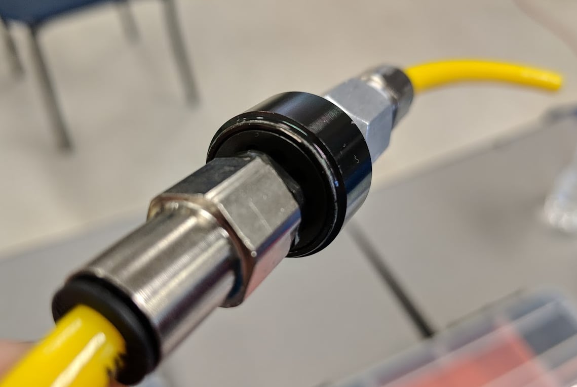

The blue suction cups were from Mcmaster, because we could get them fast, and because Mcmaster is the best. The science applied to selecting them was essentially to choose some with multiple bellows, would fit on a disc surface (in the places we wanted to use them). We ordered 2 sizes figuring we would try both, and then ended up just using 1 of each size in the final gripper (with the larger for the main Cargo grab because it gave more holding force).
The red suction cup in the AQR video is from Piab. We talked to their application engineer and ended up getting a recommendation from them on material for the cup. Piab has a billion options and their engineers were really excited to help us out, so I have to give them a big recommendation if you decide to look at suction cups in the future.
For fittings, the cups all NPT style threads, so we just chose the right size, added some teflon tape and screwed them together.
