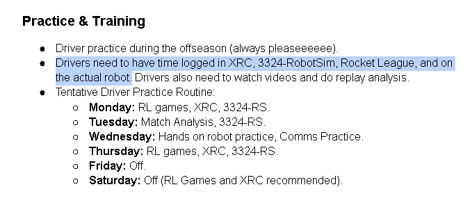

  • Drivers need to have time logged in XRC, 3324-RobotSim, Rocket League, and on the actual robot
The only one of these that actually matter is the actual robot. The two best drivers I have ever had both hated simulators/video games
One of them could not stand looking at screens as they gave him a headache. The other flew RC planes and helicopters competitively and hated video games /simulators because “they feel wrong and the real robot doesn’t move like that”
If you are doing this because you want to increase reaction speed/decision making fine but especially with rocket league it will develop bad habits.
Rocket league cars move like cars, as in forward backward with 0 sideways movements. Watching back some of your matches from last year your driver only moves forward-backward or left-right never really taking advantage of diagonal movement or the way swerve can move in an arc. This could be a symptom of how practice is being implemented.
  • Drivers also need to watch videos and do replay analysis.
If this is the system you want to implement that is fine, however this is really something the coach needs to do more than the driver. The coach should decide what things the driver reviews and which critiques they hear. If you constantly force them to review everything than everything is given equal weight but if the coach comes in and shows specific instances or ideas that means more.
An example from sports is “watching tape” on yourselves or another team. The coaching staff watches everything (whole matches/games), then presents it to the players. This allows for the coach to decide what is important to highlight as well as not have the players focus on something dumb they won’t do again anyway.
(Our 2019 Einstein driver probably never actually watched a full match he was in and he drove from offseason 16-19)
  • Tentative Driver Practice Routine
Are they doing all this in addition to their other roles on the team or instead of doing those things?
