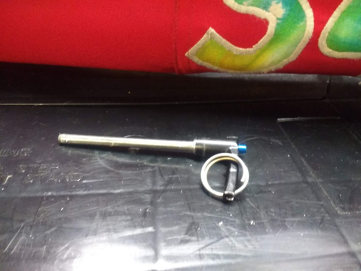

Example of something a little fancier we’ve done with our bumpers using the Cricut:
Google Photos
Those aren’t defects in the lettering btw. That’s meant to be like that.

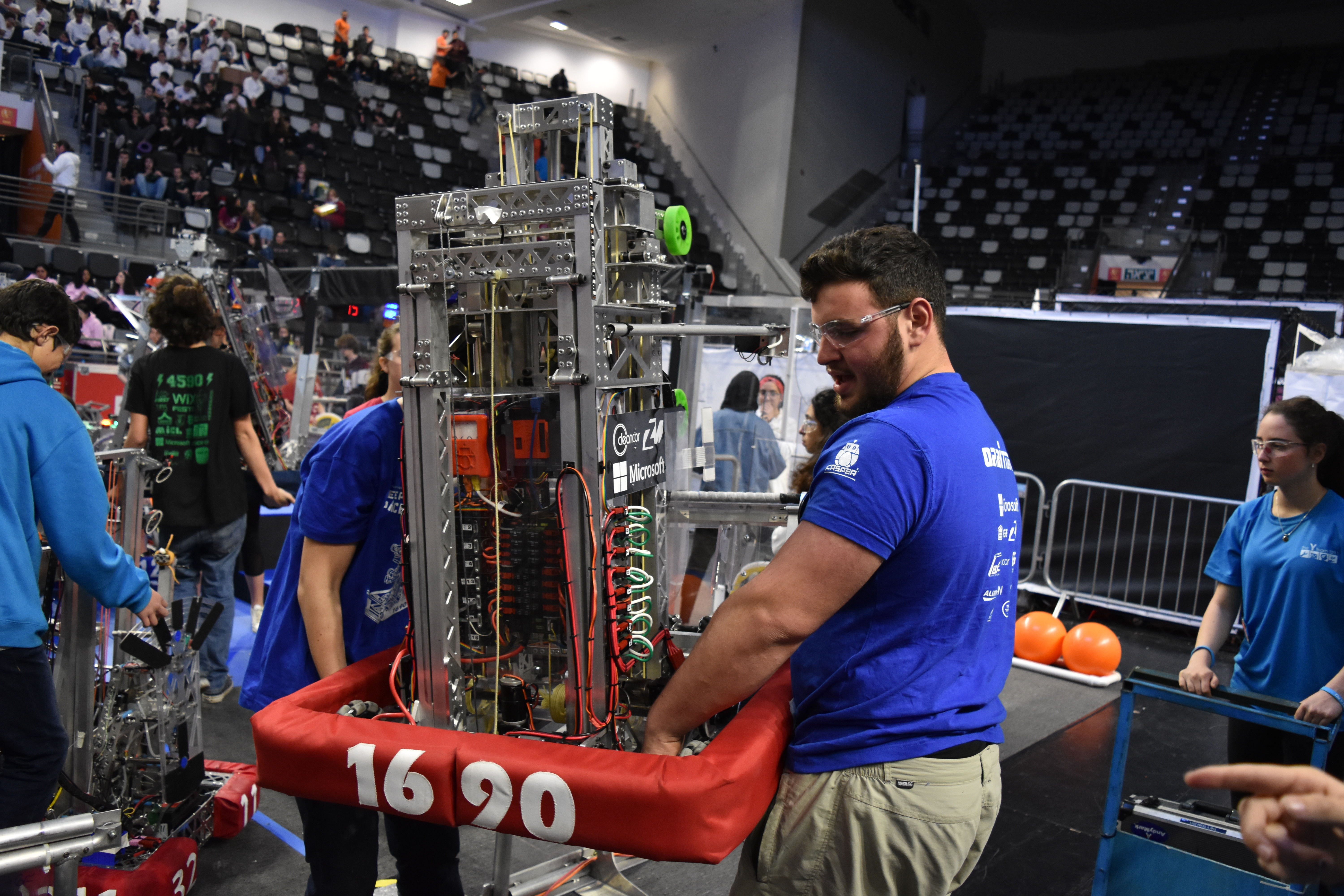

If you can get a sponsor that does it, embroidered bumper numbers are pretty cool, we’ve been doing it for 8 years and no problems with like it falling off. 2019-09-08_08-38-07|690x460

Orbit Robotics had an embroidery machine given to the team this past season. It does a great job but isn’t quick. After 2 district events, Provincials, Worlds and several outreach events there are 3 or 4 broken threads.
