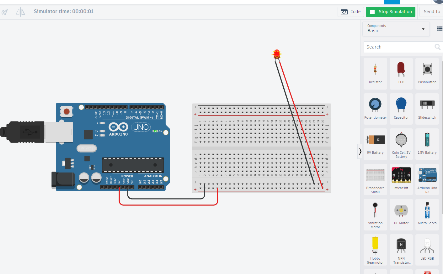

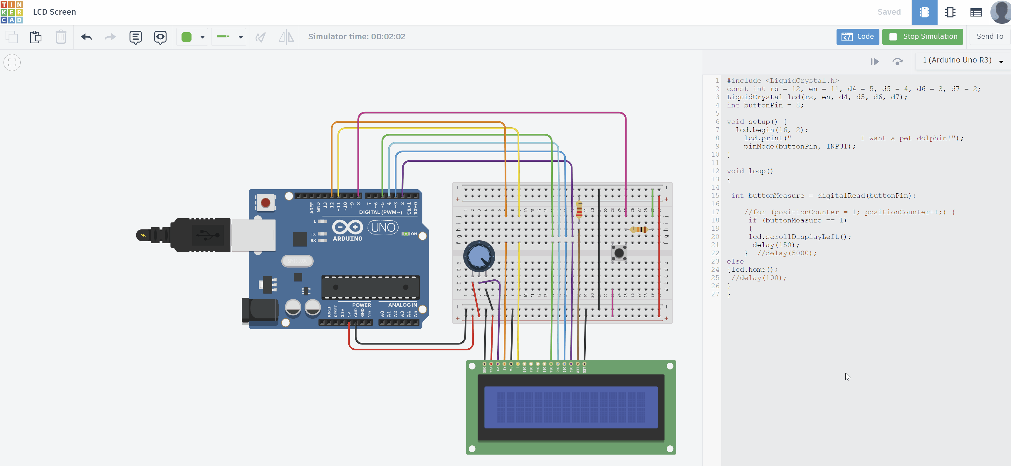

Getting their feet wet in TinkerCAD Circuits has been a huge help to our students. We’ve been using TinkerCAD Circuits as the brainstorming and rough draft portion of the student’s project. They get their Arduino working in TinkerCAD on the computer before they move to the real physical kit. This has allowed us to work with more students, since each student has their own computer, but we don’t have enough Arduinos for each student.
