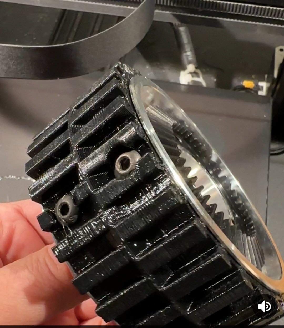

If you have time I’d print some tpu tread like this. They didn’t grab carpet good but held up good on some short pavement driving, not real aggressive driving bit some mild swerving back and forth. I’m positive way better than the conveyor tread

That looks cool might want to tri it so we could do a little swerving at events. Do you have a link to that model?
I’ll see if it’s in the team drive

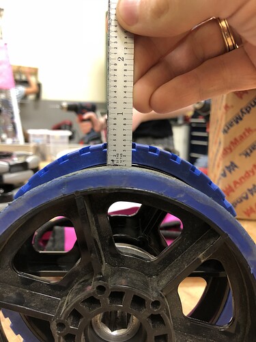

We ran our T-shirt cannon in our homecoming parade and about an hour outside on a concrete basketball court. In the parade we used blue nitrile and it FUSED ITSELF to the SDS wheels and flattened the bolt heads and was near impossible to get off. We then used our spare black neoprene for driving it on the basketball court and it held up… so I’d say yes if you be careful with the throttle it should hold up, but the problem is with the bolt heads flattening…
We ran the blue nitrile rhino tracks during a parade a little bit ago and they held up fine, a they had also been through a full day of demo outside a few days before and still were fine if not coated in grass.

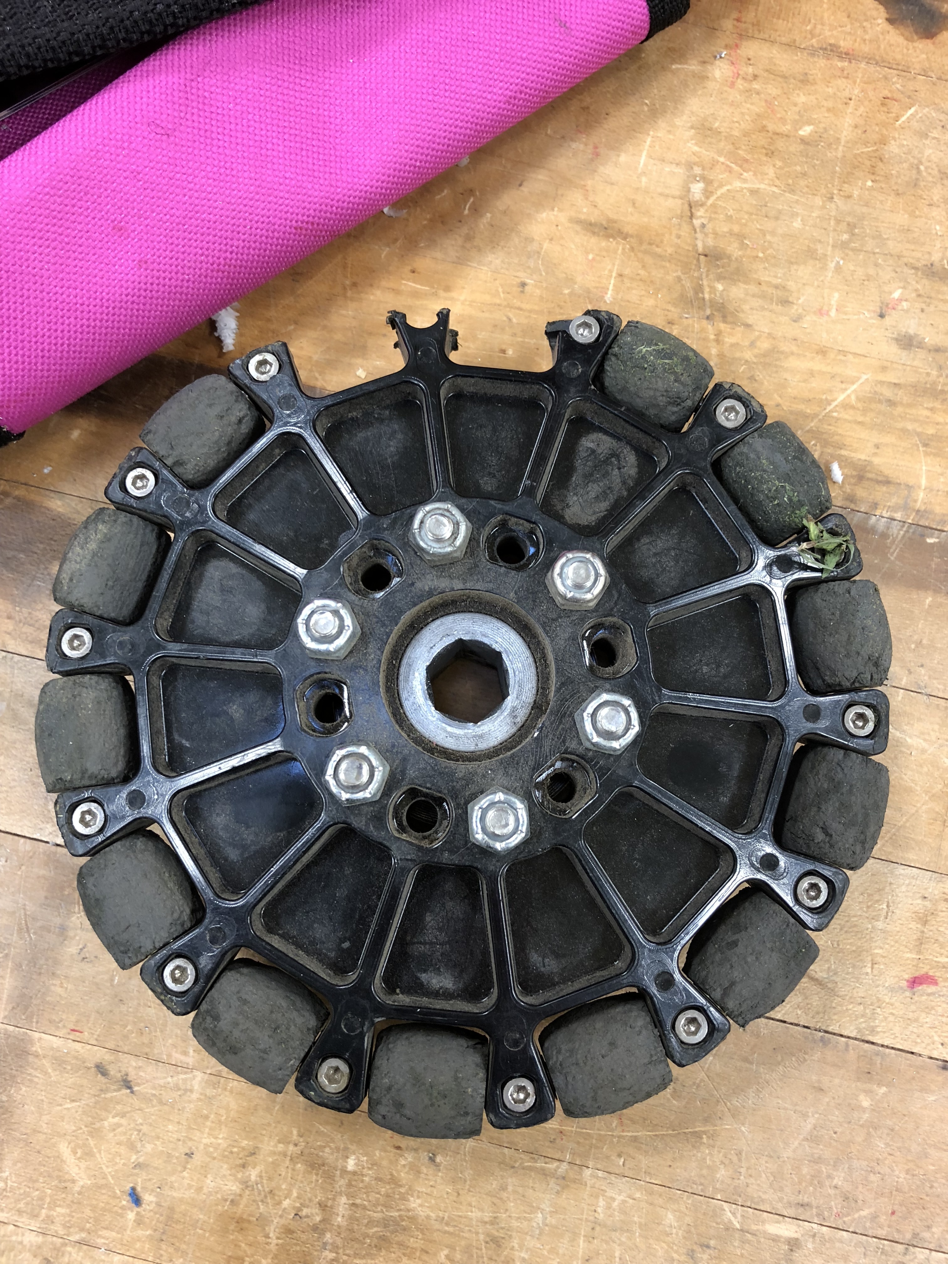

FRC bots on concrete is in our experience generally not a good idea - our swerve wheel bolt heads ended up pretty messed up after some summer outreach events on concrete and the tread didn’t last long either.
This was after a couple of hours of demo at a park, partially on a paved path, partially in the grass, with a tank drive. Not the best choice of wheels!
After this, I try to get us to use pneumatic tires if we’re doing anything on a rough surface like that!

Do you have a file for the TPU tread you can share?
It wasn’t on our team Drive but I’ll get a hold of the mentor that printed it and see if he can get it to you.
Me too please!
