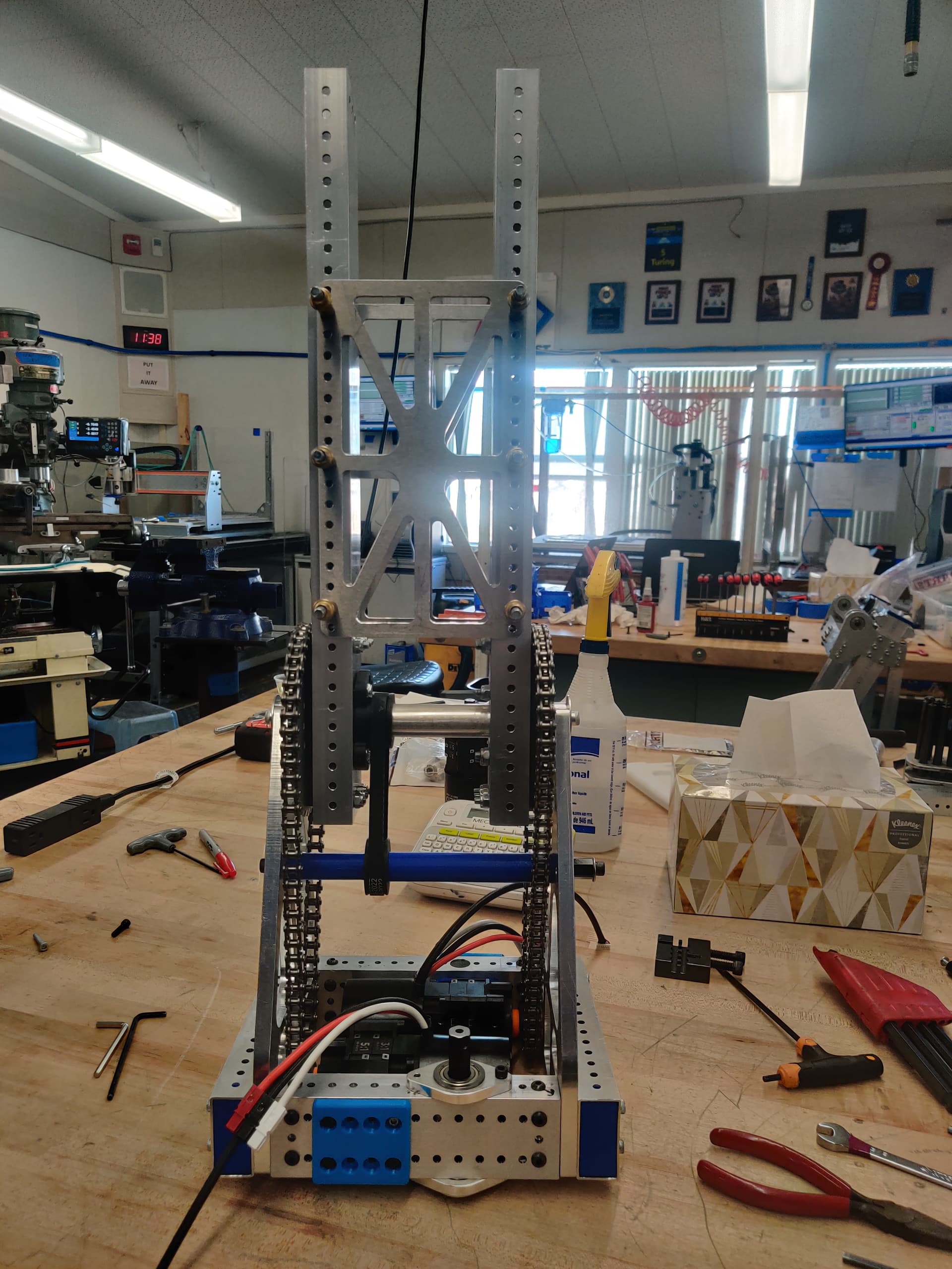

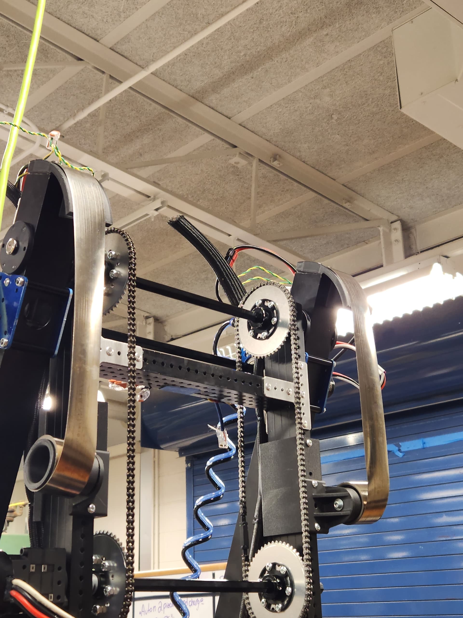

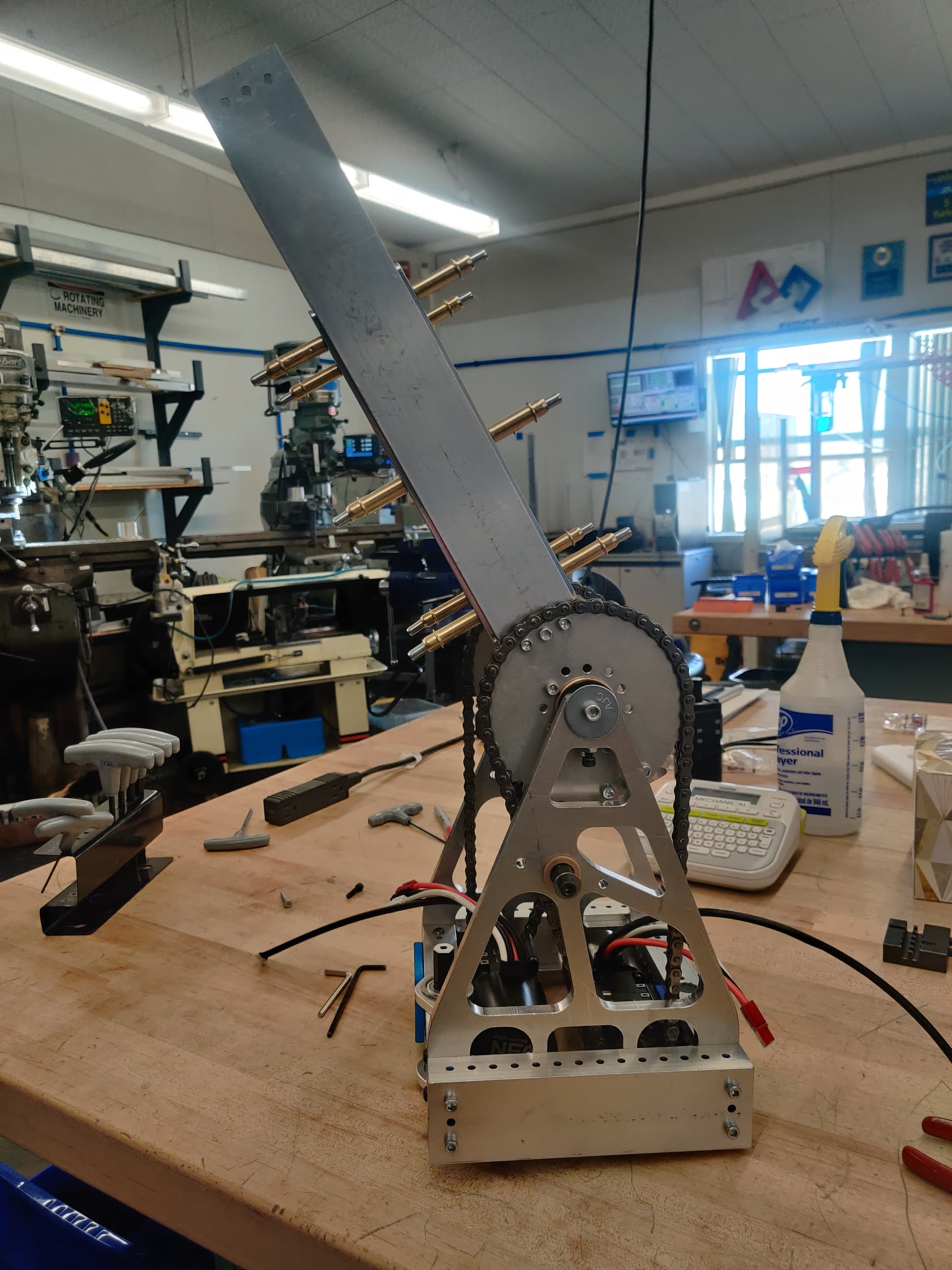

We tried very hard to learn from the lessons of 2019 and use them in designing our 2023 carriage arm. I laid out some some arm best practices in this thread last month (read the whole thread, lots of good advice):
The biggest 3 pieces of advice I can can give you are:
  • Absolutely do not use VersaPlanetary gearboxes for high torque arms
  • Use a dead axle setup with a round aluminum tube
  • Use tensioned chain for your final reduction, the chain will help absorb shock loads and has substantially higher tooth engagement
Here’s our 2023 arm which incorporates most of the advice I laid out in the shared link above:

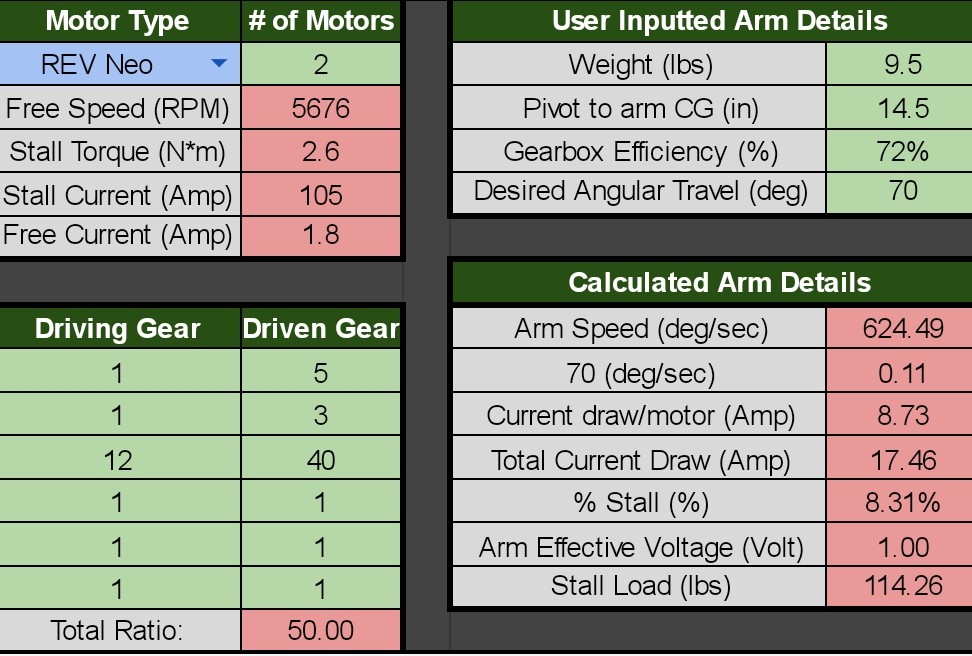

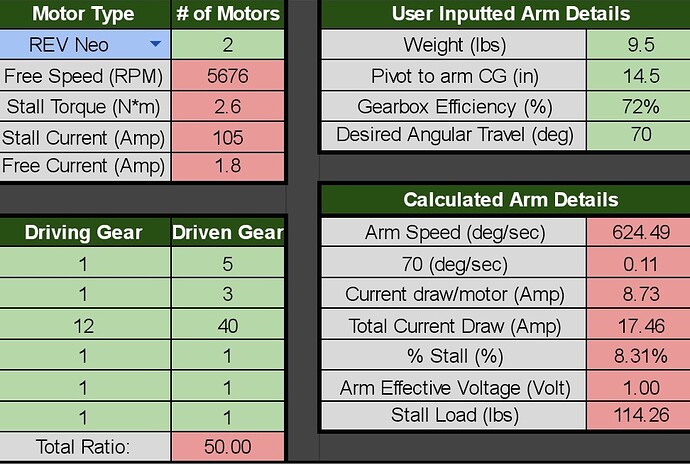

And here’s our arm calculations using the KLib Design Accelerator:
15:1 is the MaxPlanetary
40:12 is the #25H Chain Reduction
