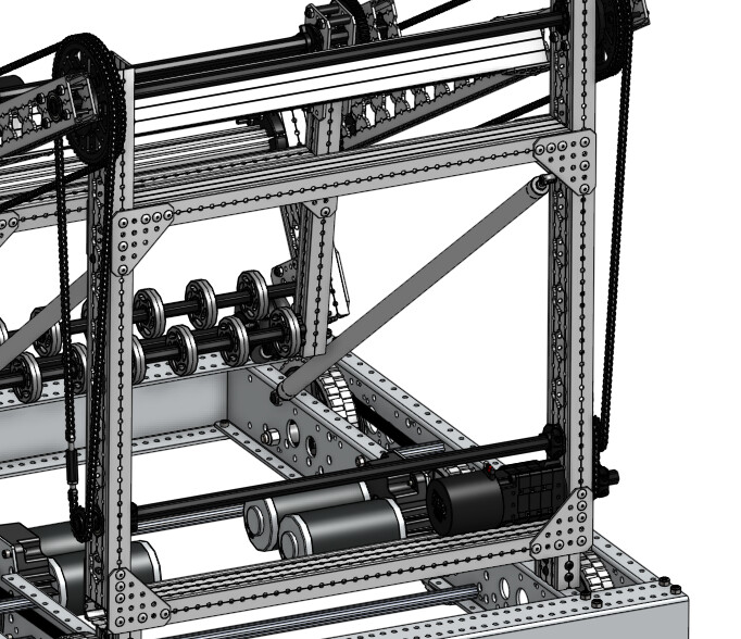

In our case we achieved a 200:1 reduction with a 5:1 VP, the WCP Rotation Gearbox geared at 58:18 and 52:18 and a 15:64 chain reduction using #35 chain.

We got two of these and have been very happy with them. They are heavy, but ours are mounted very low, with chain running up to the two joints. We also have tensioners on the chain situated so they can help take up shock load. We ordered these early on, when the arm prototypes were really heavy. But we don’t need to use the chain for reduction, which helps keep things compact. Overkill, but would probably stay with this choice even with a lightened arm.

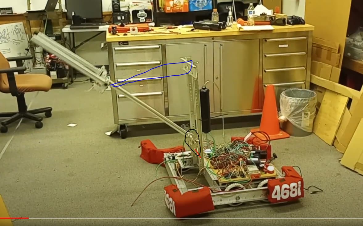

This was a video of the prototype, non-competition robot: FRC 4681 Murphy's Law - Proto-Arm Test - YouTube
The mounting job is poor, but we wanted a quick proof of concept. Even at 900:1, the arm falls under its own weight, so hopefully the springs/cords will help mitigate that.
The competition robot will have this arm mounted on single cascade stage elevator mounted diagonally on the robot. We’re using a mini-CIM, and the output shaft is 1/2". The arm length is still under discussion, but it should be around 36 inches, and if we can redesign our elevator, we might increase the arm length toward 48 inches. I also don’t know the weight, but will estimate it to be between 10 and 15 pounds.
I can get exact measurements on Saturday when I’m able to be with the team.
This arm is definitely long and heavy enough that you’ll need to take some precautions to ensure it doesn’t destroy itself.

I will echo the general feed back you have gotten from other teams. Use chain and springs.
Blue can be surgical tubing.
Red is a jack shaft with a chain run up to the arm.
The REV starter bot shows a good example of how to do this jack shaft and sprocket for an arm.

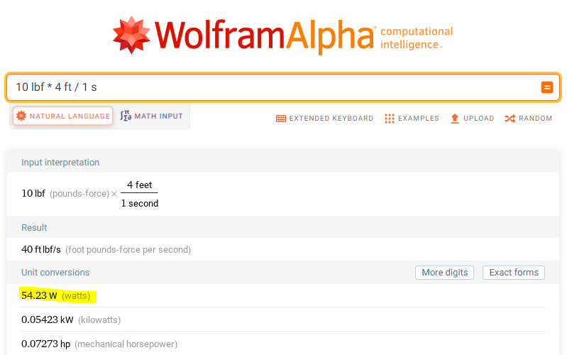

Motor selection, for all its mystery and politics, is fairly one-dimensional. You primarily just need to determine how much power you need the mechanism to deliver. In 2023, we are challenged to raise a 1 lb cone, plus our robot’s manipulator, by a few feet, in a few seconds. We can just throw all those numbers together and get an order-of-magnitude estimate of our minimum power requirement [1]:
The 2nd piece of information you’d need is this: Whichever motor we pick, we would like to operate it at say 25-40% of its max power. This ensures that we are in the high-efficiency region and are not dumping an excess of energy into heat that might cook the motor. It also ensures that we have some headroom in case we have accidentally underestimated our power requirement in the previous step.
The snowblower motor is only capable of delivering 20W at max power. Our desired operation point is ~25% of that, or ~5W. This is 10x worse than our estimated minimum power requirement, so it’s not an acceptable choice for this application.
