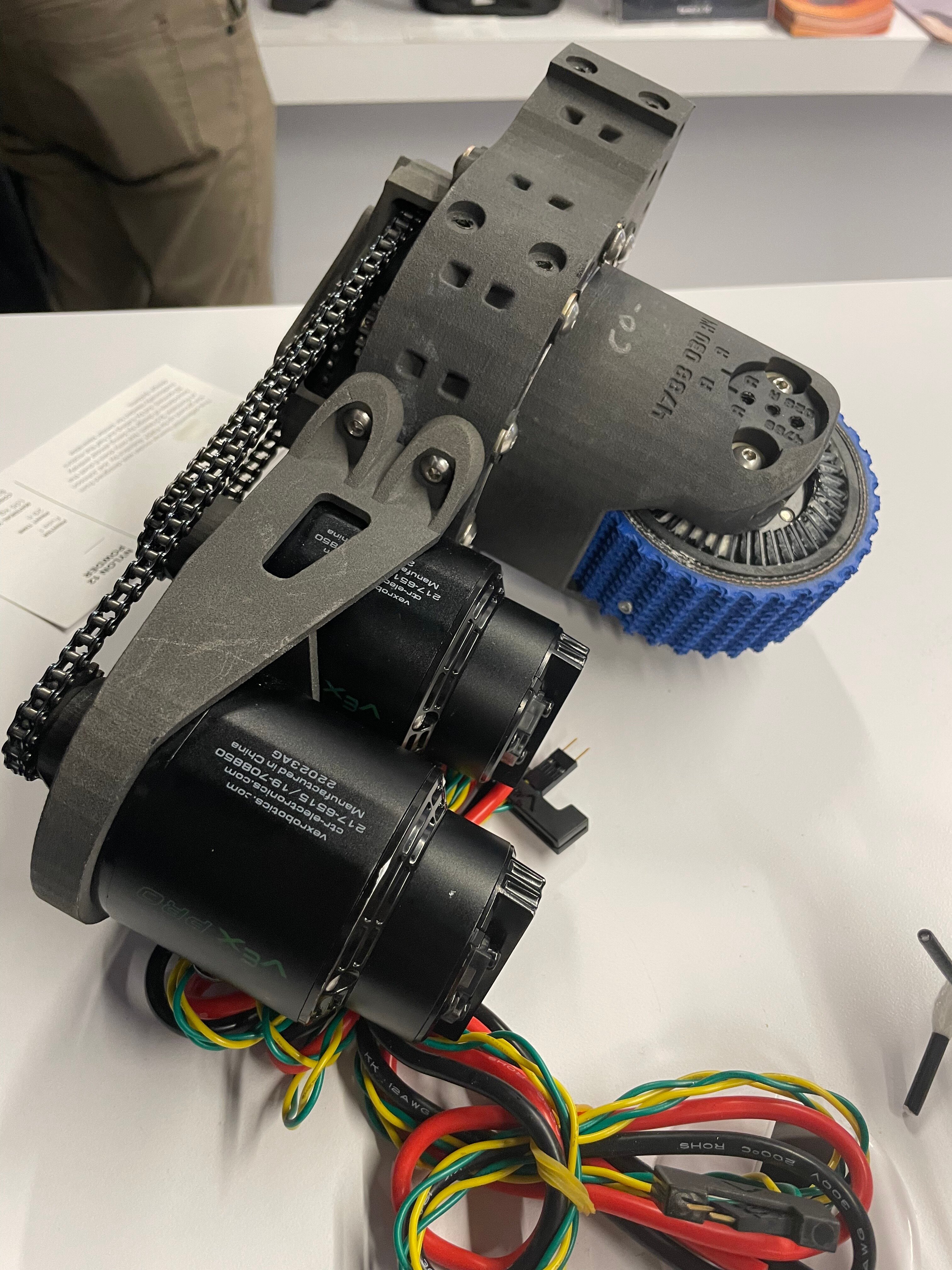

As many of you know, I’m currently an engineer at Formlabs and I’m mentor on TJ2, Team 88.
TJ2 has been working since about half way through the pandemic to develop the best 3D printed tire for FIRST FRC. Many of you saw the tire at New England Championships and at Worlds in TX.
Formlabs just put out an IG featuring the tire. You’d be doing me a solid if you could check out the video.

Out test rig showed that V40 had a coefficient of friction on FIRST carpet of 1.6 while the standard black nitrile from SDS had a CoF of 0.9 on the same rig. This was a static rig with 35lbs on one wheel. We saw some differences between our static rig and the actual SDS Mk4i’s on a real robot. HOWEVER, we put them on virtually identical robots (this year’s competition robot, Scorpion, and our practice robot, Slither) and it wasn’t even close. V40 TPU90A easily pushed its twin around the field (and left less noticeable marks on the carpet FWIW)

We’ve thought about selling them. Not sure if there is a market for them. Also, Team 88 has a Fuse1, which can’t print TPU90A (yet?) but even it if could, it isn’t super easy to convert between powders and we wouldn’t want to give up printing in Nylon12 (the parts as SO good).
As a Formlabs employee I have access “infinite prints” (best perk EVAR) but generally speaking that doesn’t include making parts to sell. Who can say? Perhaps I can convince them to make an exception for FIRST related parts.
As to Rev Max Swerve tire, there has been a ton requests from people stopping by our pits this year. I guess the stock tires are, let’s just say, less than ideal. I don’t see any reason not to make versions for other swerve modules. Our initial work was with a 3.5" tire we were planning to sell with our Diff Swerve Module (that we’ve pulled back from not enough bandwidth to do all the things we want to do in life.)
