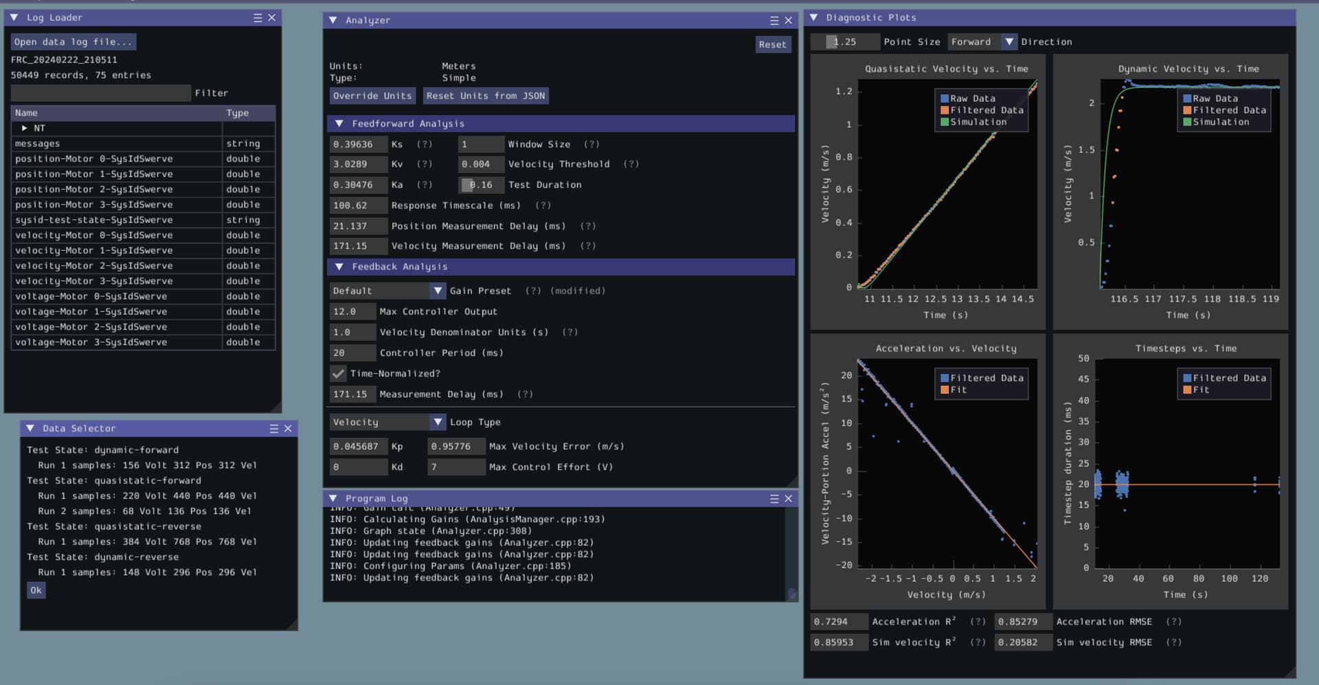

We are using SysID to characterize our swerve drive - when analyzing it takes reads for each individual motor of a swerve module - should we just average the constants for all four modules or is there some way to characterize the entire drive?
You may combine the different gains or select a single representative set as you see fit. There is no combined analysis yet.
Alright, thanks!
