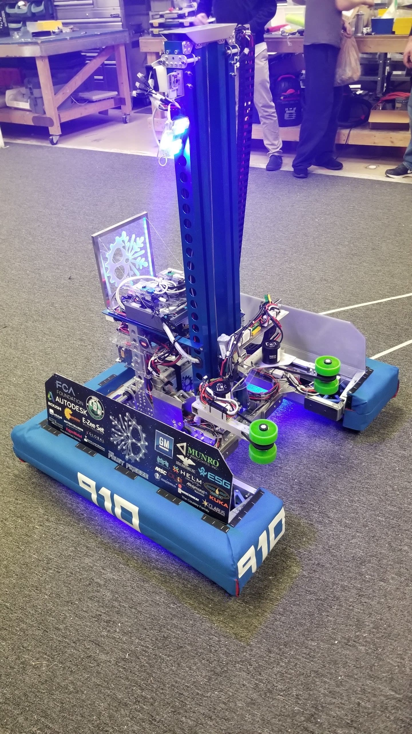

910 ran an open front swerve drive in 2019. Seems to have worked out for them.

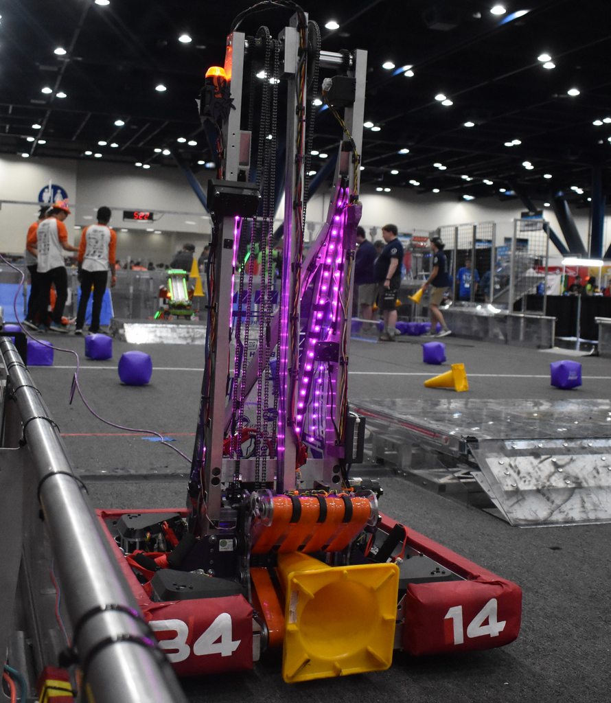

I know this has already been answered but we ran a gap in the frame with swerve this year. we had some difficulties making everything fit whiles still being strong but when we got it worked out it ended up working very well.

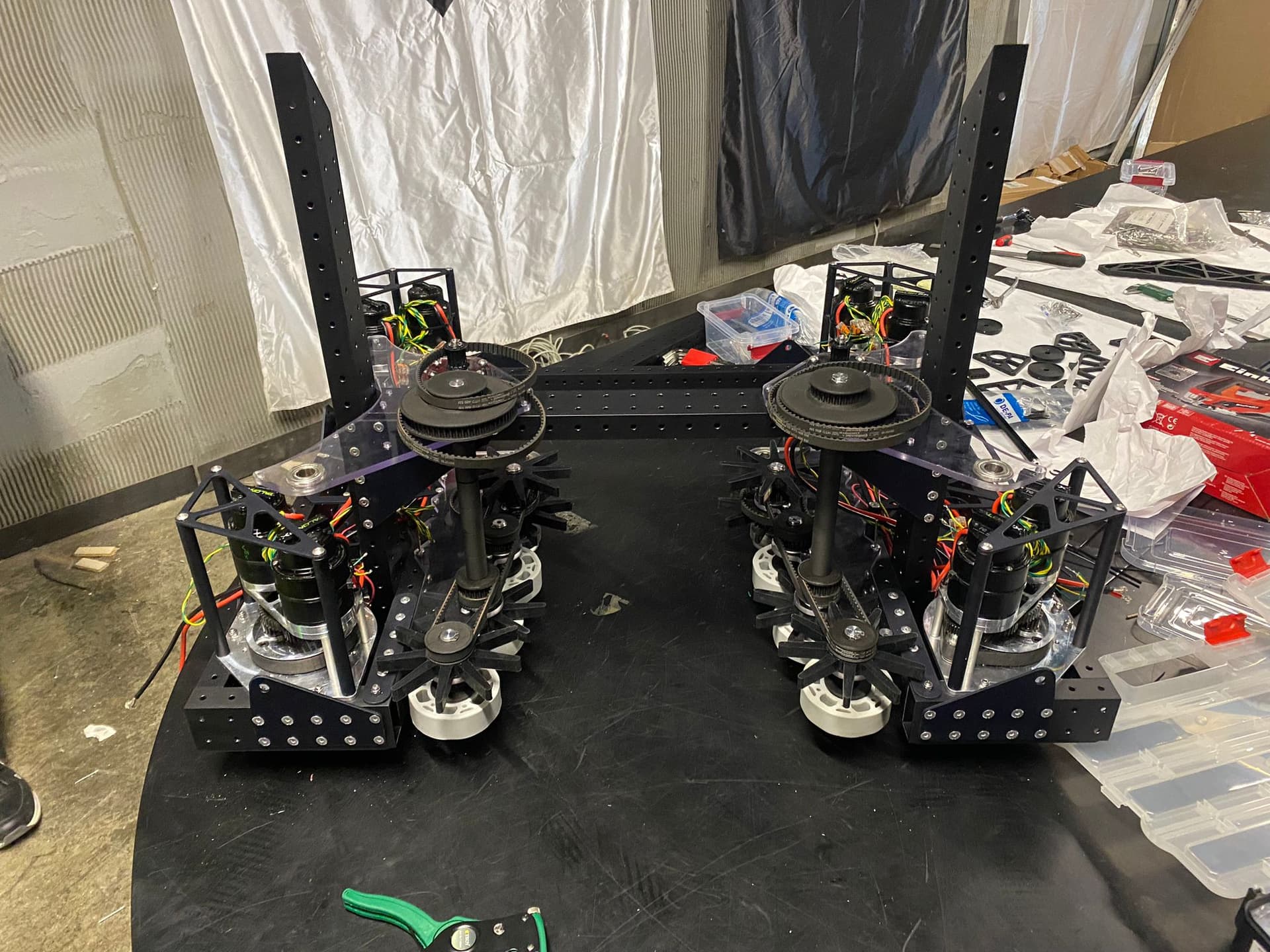

You can use swerve in many variations, it’s completely up to you (within the rules) I probably have the strangest swerve chassis :smiley:

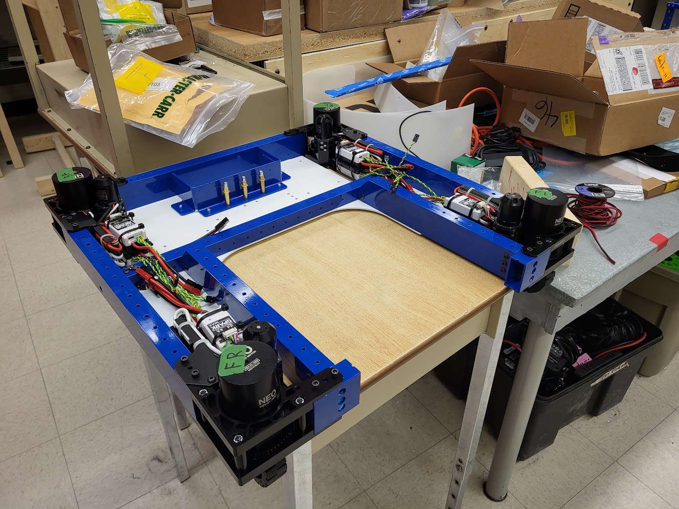

Its certainly possible, we ran a gap this year too:
We even had to cut parts of the robots top plate off and it was still fine.

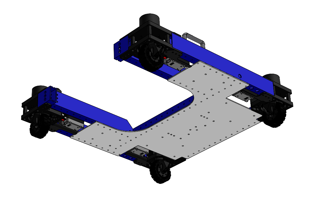

This was 3739’s swerve chassis this year, with a sizeable 13" wide x 14" deep gap in the front of our 24x24" frame.
It was a robust chassis that didn’t give us a single issue all season (no bending or twisting, no repairs ever needed).
The 2 biggest things contributing to the strength of this chassis (despite the fact it’s missing basically the entire “front”), is the 11ga steel belly pan tying all the various structural elements together, along with the use of WCP’s tube plugs (plugs on either end of the 1x1 tube in the middle, and plugs on either end of the 1x2 tubes on the sides of the cutout).
The combination of these 2 elements prevented the chassis from being split/twisted/bent, even when taking hard hits to primarily the front area (where one would expect this style of chassis to fail first).
Here’s a screenshot of our CAD with a better view of the bellypan:

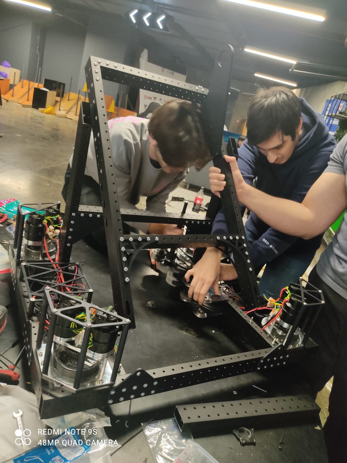

Indeed it is possible to make an open front chassis. This year we needed a long tunnel to transfer the game objects from back to the front of the robot. That is why we elevated the middle extrusion and achived a no/open front chassis.
This is an excellent example of “be sure to think in 3 dimensions”
