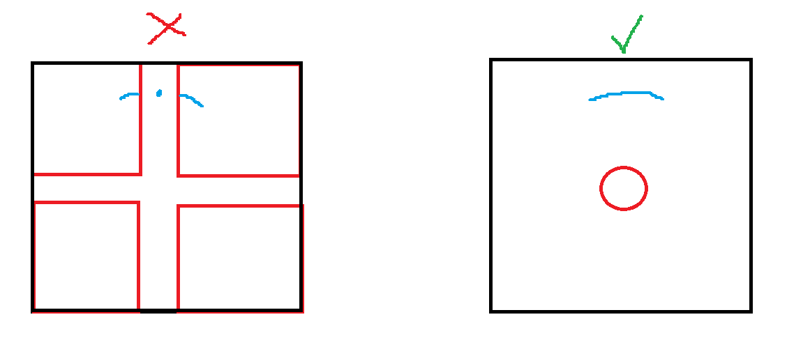

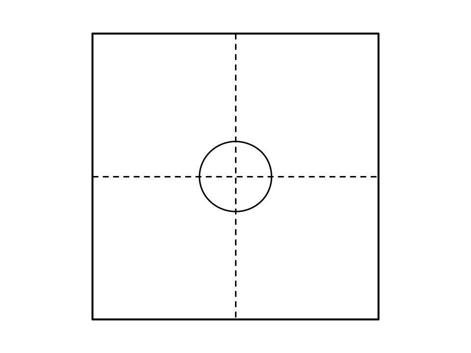

Interesting, we have found added dead bands on each axis really limits your steering sensitivity around the poles (like in the left example). We make round deadbands by looking at the magnitude of the vector created by both axis (like in the right example).
This is really only noticeable when trying to drive in a smooth orbit around an object, you end up diving in an octagon-looking shape. There might be a way to turn this off, maybe yours is.

The advantage of a cartesian deadband is you can deadband each axis individually. So if the driver tries to drive straight and pushes the joystick 100% in Y and 2% in X, you can ignore the X movement and make the robot drive exactly straight.
On the other hand, a polar deadband is better at ignoring small measurement errors in the joystick while cancelling out fewer “real” values.

I haven’t done this for swerve, but have worked on dead-banding joysticks at an internship. We actually used an elliptical deadband, which provides advantages of both cartesian and polar deadbands. I don’t have any code for it, but could probably figure something out of people are interested.
You mind doing a crude sketch (like mine above) for how this looked?

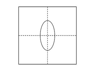

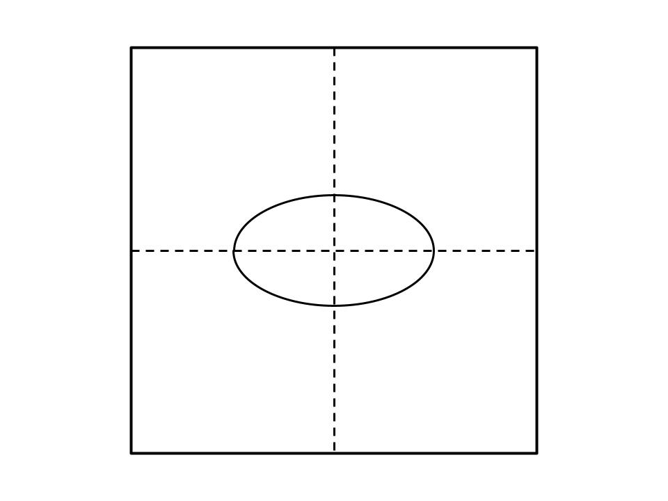

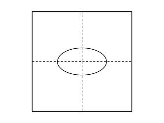

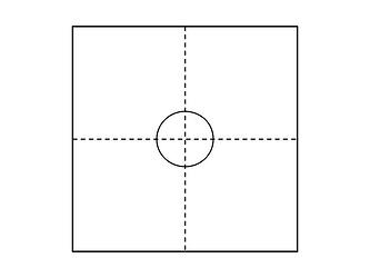

So here are the three general states of how it worked. We controlled the shape by defining an ellipse with four points, with two lying on the x-axis and two on the y. We then solved for the foci with these four points and knowing they lie on the x or y-axis.
Here’s an example of a pretty big y-axis deadzone and a smaller x-axis.
equal deadzone on x and y.
Smaller y-axis and big x-axis.
