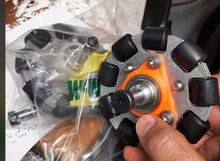

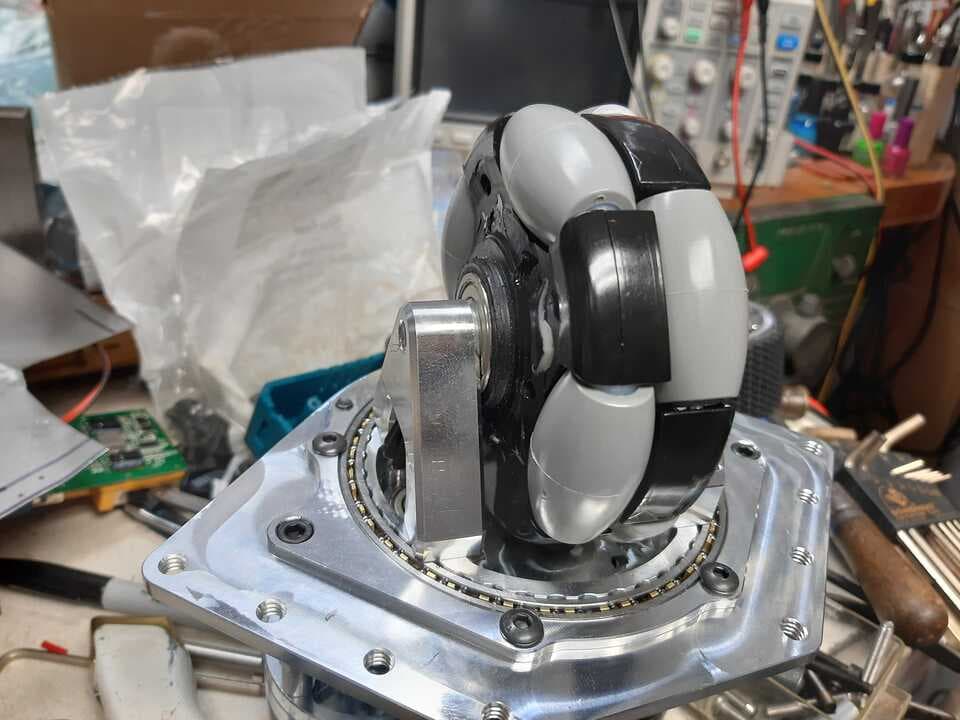

I built our team a crazy wheel that fits the SDS MK4 modules. The idea is that when you fail -something- on your swerve module and need it working in a big hurry, you pull off the wheel and substitute this thing!
Its a 4" Omni wheel with bearings in it, so it rolls any way you want, irrespective of what the swerve module is doing (steer OR drive)!
I recently made some updates so that it uses the stock SDS bearings… Bore or drill out the hole in the AM-2948A Omni-wheel to anything over 1/2". I would use 3/4". Two 3DP parts needed and six 3/4" #10-32 BHCS. I suggest super gluing the shaft sleeve into it so it doesn’t get separated. Maybe glue the bearings in place too.

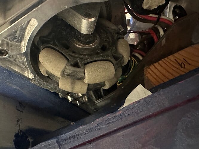

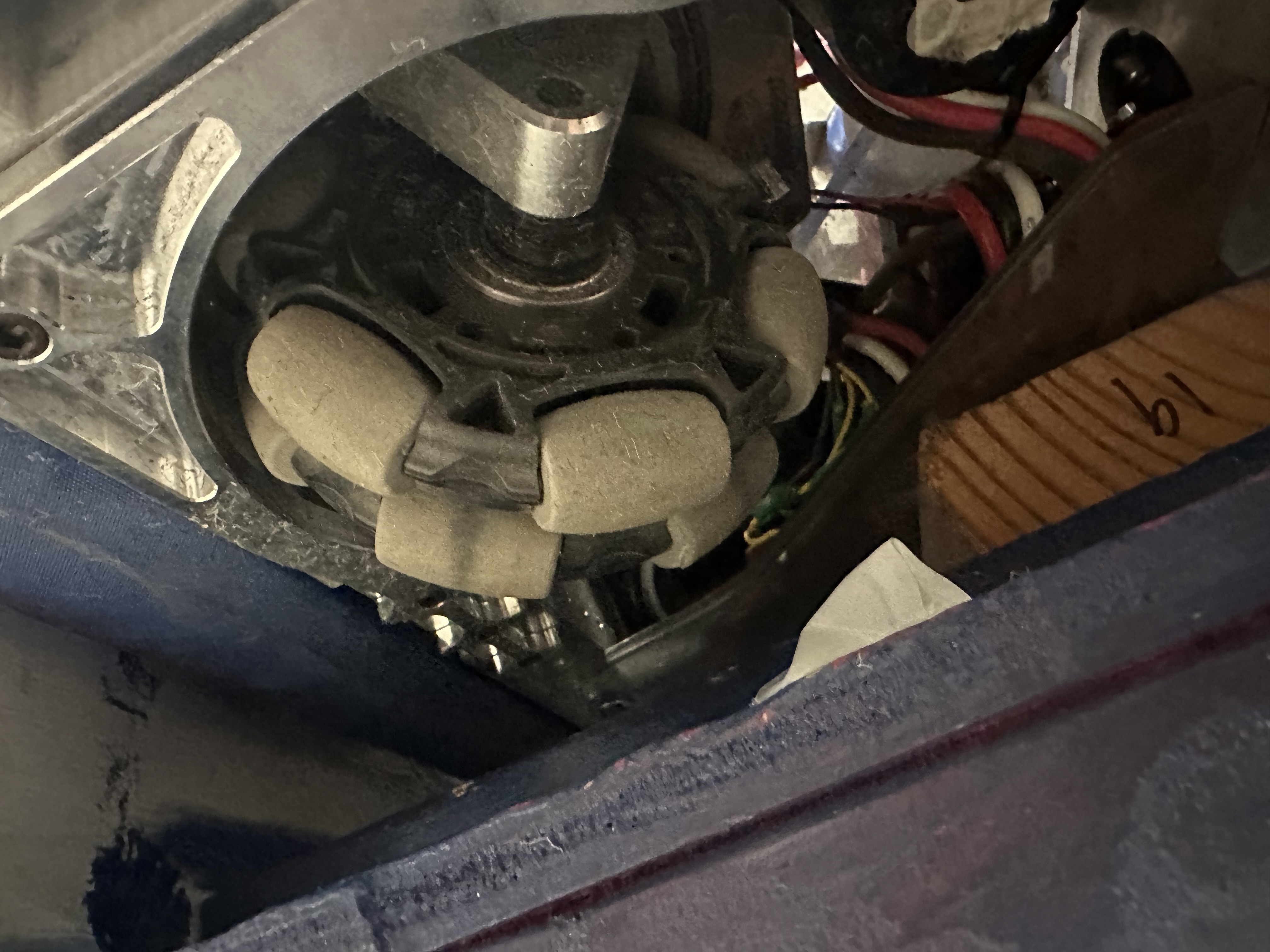

After our last competition where we suffered swerve issues throughout elims, I came to the same conclusion as you guys. The Omni wheels we had lying around our shop were slightly different to yours, so I didn’t have to 3d print anything, just a couple bearings and were all we needed to get our wheel working. Driving definitely felt different than with 4 wheels but much more manageable than the completely disabled wheel we had in those finals matches.
(Only picture I have sorry)

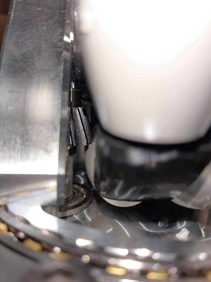

Interesting! I tried REALLY hard to get a dual row omni to work, but I just couldn’t get the darn thing to clear the pinion gear!
