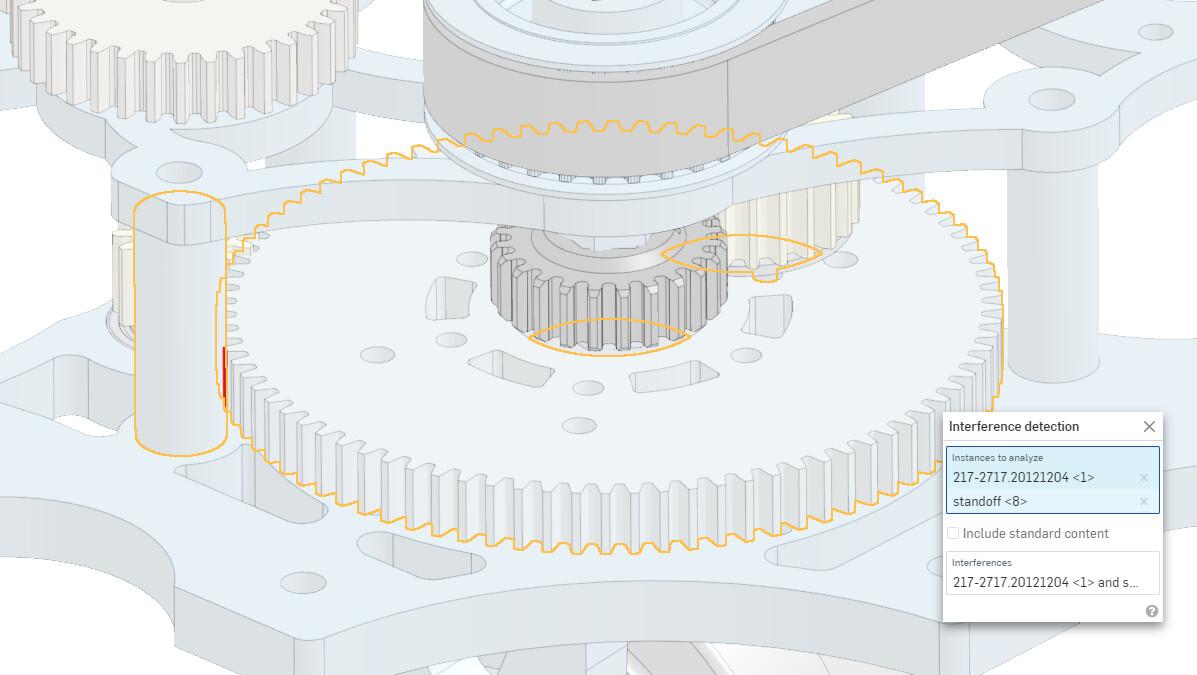

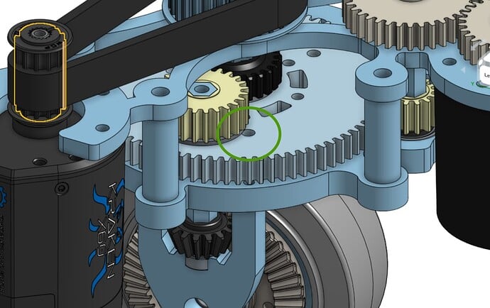

May be some fastener interference hear as drawn, assuming this hole is used to attach the forks below.
other than that looks good on first glance. top plat may be a little too aggressively pocketed and could use some fillets around a few fasteners.
It’s always great to see custom swerve designs - thanks for posting!
Just a heads up, your steering gear currently interferes with one of your top plate spacers (and gets scarily close to another one). Moving them out a little bit will save you a headache during build season.
Thank you so much for catching this! This just saved our team hours of pain!
Here is the new version of the file with this issue fixed!:
2024 swerve v2

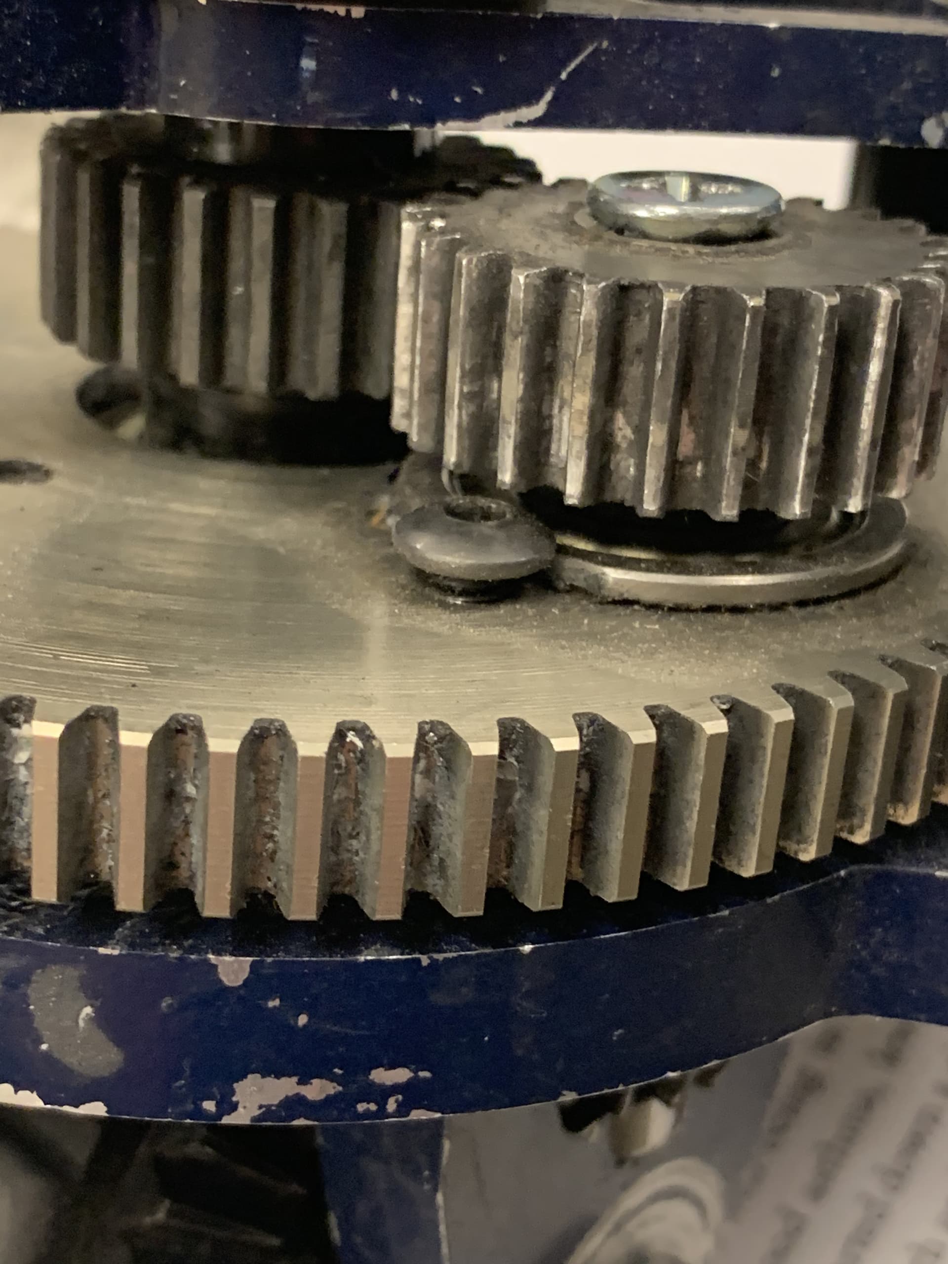

This would prove worrisome but this was based off of last years design which worked splendidly with a very close tolerance:
However I do agree that there needs to be a few more fillets on the plates which I changed in the most recent version which I just posted on this thread.
