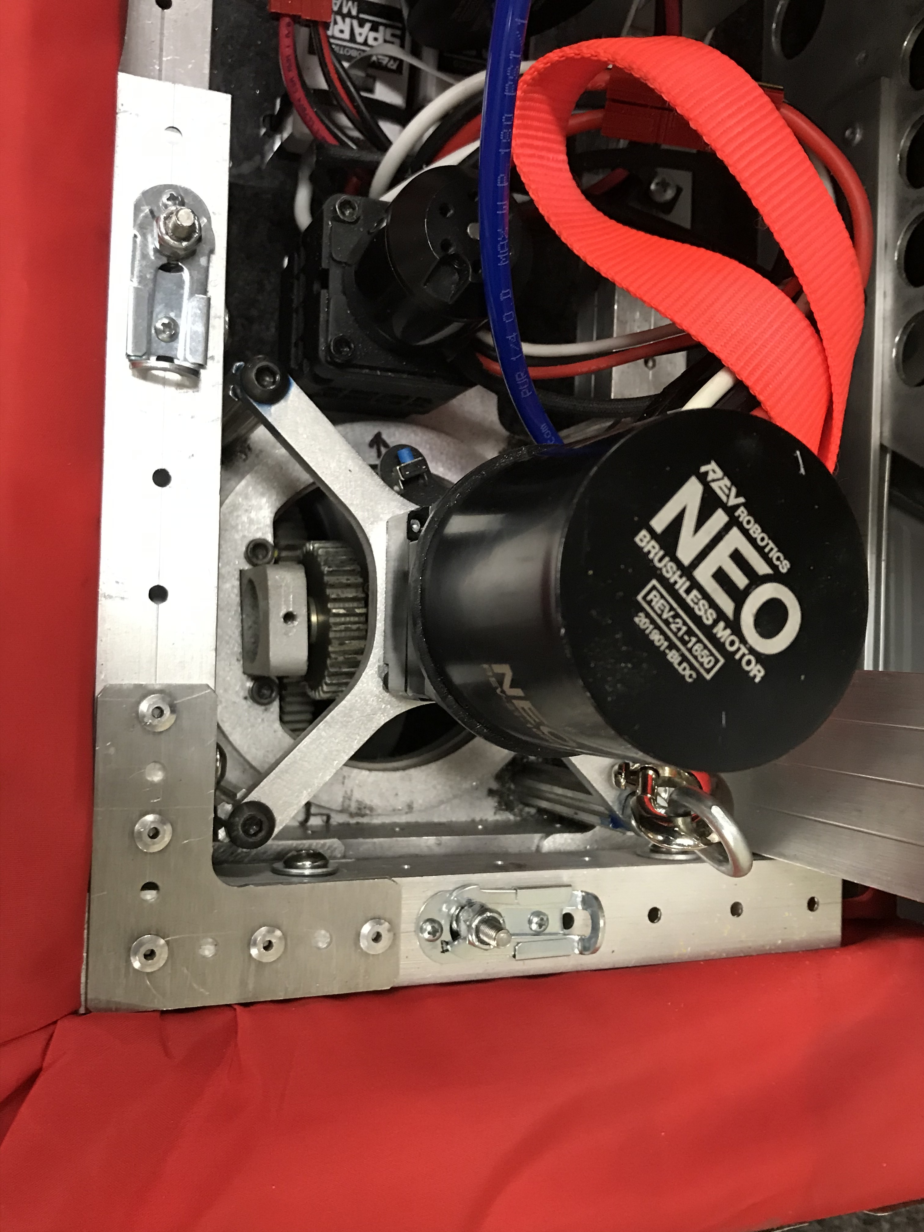

Just because we were brought up, here is this year’s bumper mounts, they interface with little pieces of angle screwed to the plywood of the bumper:
It’s just a clevis pin stud that a clip goes through. nothing special. We had to go this route as we cant drill holes for drop-pins through the 4130 frame without structurally compromising it.

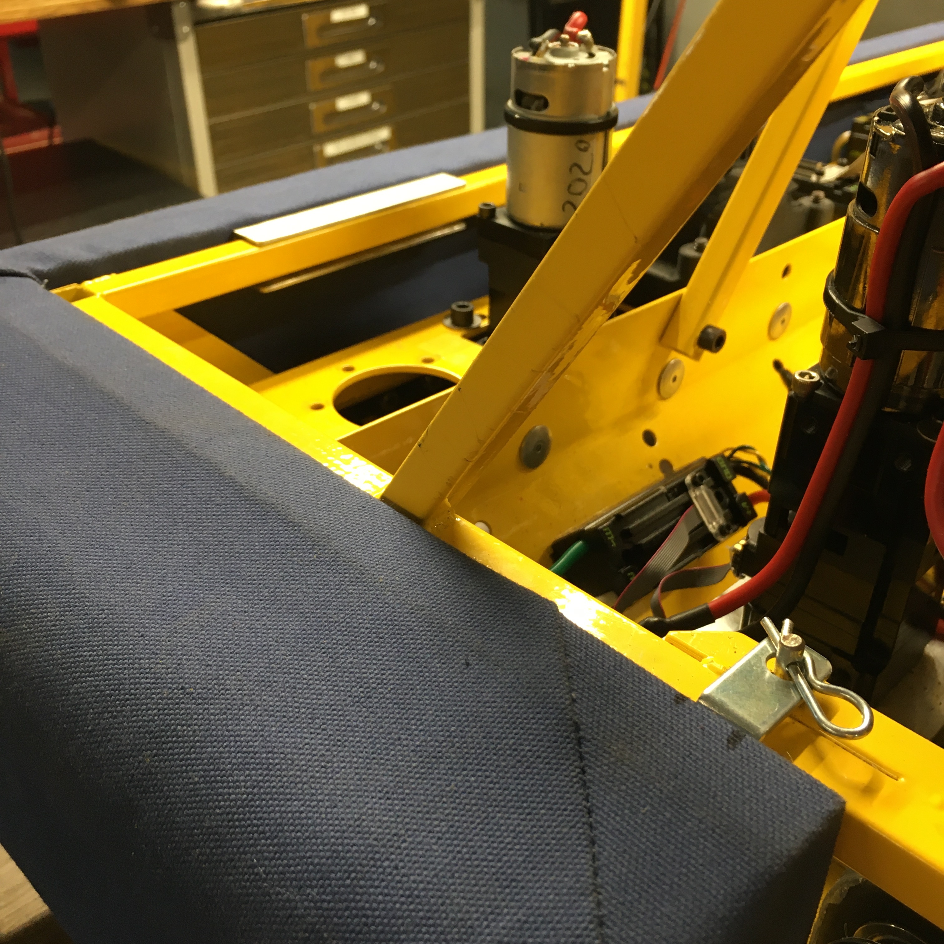

This swerve has been removed so you can see the aluminum U channel which started life as a a 3/4 thin wall tube. One side was removed with a band saw.
The pin is a generic, multi holed clevis from the hardware/farm store.
The bracket is a steel bracket from Menards.

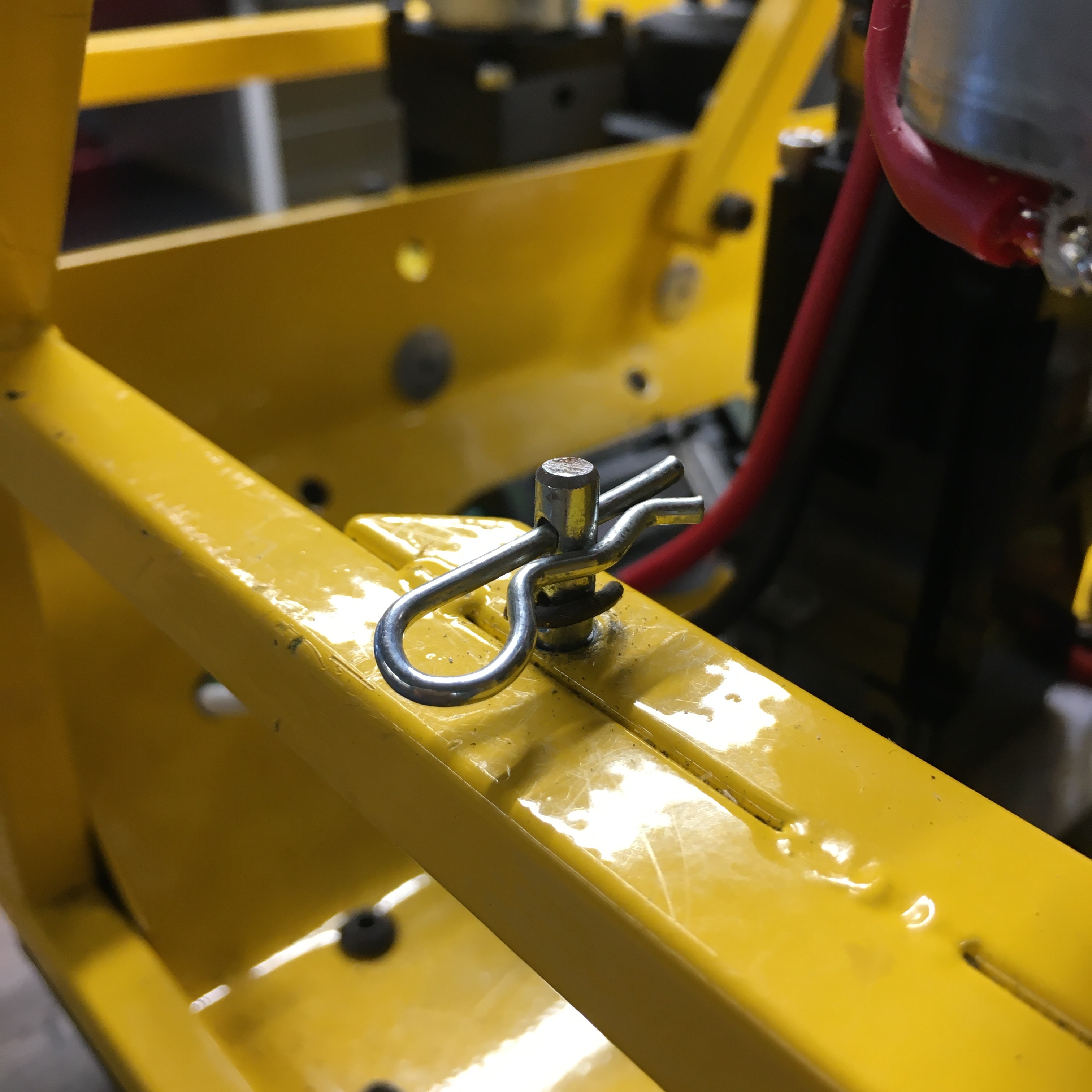

Here’s a closeup of how the clevis pin is held.

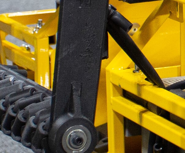

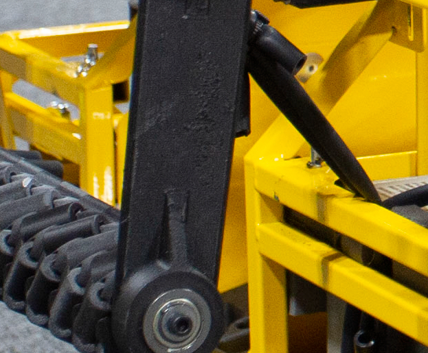

Everything in the picture that is black (except the silicone tubing) is printed on a MarkForged. The forearm has layers of Kevlar and they flex when hit. They are considered semi sacrificial however the ONE competition we attended they held up fine. Other teams (including us) have used polycarb in the same manner.

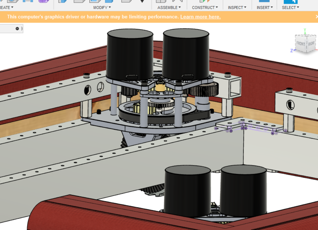

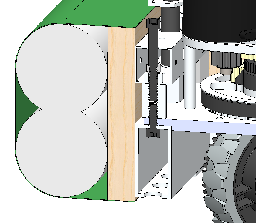

Our attachment is similar to what others have posted. I’ve attached a picture below that shows it pretty well. We have a full perimeter 1x1 frame. We have studs (3" long 10-32 bolts) protruding up out of the frame at various locations and then we have a thin wall 1x1 attached to the inner face of the bumper with holes in the same locations as the studs such that they slide over the stud until the bumper 1x1 is resting on the frame 1x1. There are some nuts on the bolts that hold the swerve module to the frame that create the gap between the bumper 1x1 and the frame. The bumper 1x1 is attached to the bumper plywood using T-nuts in the plywood and a 1/4"-20 bolt (the bolt heads are visible on the inside face of the bumper 1x1 in the picture). Since the module fits inside the frame rails, it also fits inside the bumper as can be seen in the picture.
This year, we did not use a full perimeter of the thin wall 1x1 on the bumper as there were some mechanisms on the robot that came out near the frame perimeter that we needed to clear. So the thin wall 1x1 is only in the corners (8-9" out from each corner). We have 2 studs in each corner for a total of 8 studs around the perimeter.

When I read this, I thought it might be against R24 (BUMPER construction); I have only used angle, sheet metal brackets, or pass-throughs like tee nuts for bumper mounting. R24 e and f only allow angle or sheet metal (or staples/screws) to clamp fabric and attach segments to each other; tube is not mentioned. However, I don’t see anything in R24g which would rule out tube to attach the bumper to the ROBOT. (But you may want to double check you aren’t violating 24e or 24f incidentally.)
We have used this technique of attaching our bumpers going back to at least 2016. It has never been questioned by any inspector (18 total competitions including 4 CMP inspections).
Having said that, I looked at the rules and noted the following:
  • R24A deals with the wood board; no issues here.
  • R24B says “hard BUMPER parts allowed per R24-A, -E, -F, and -G must not extend more than 1 in. (~25 mm) beyond the FRAME PERIMETER (measured as shown in Figure 9-4).”
These 1x1 tubes do not extend beyond the frame perimeter at all. R24B does not seem to have a limit on whether the hard parts can extend within the frame perimeter any particular distance from the back of the bumper plywood.
  • R24C and D deal with the pool noodles and the covering; no issues here
  • R24E says “optionally use metal angle, as shown in Figure 9-6 or other fasteners (e.g. staples, screws, etc.) to clamp cloth.”
We are not using the 1x1 to clamp the cloth. The use of a metal angle to clamp the cloth is listed as optional. This rule references figure 9-6, which I discuss more below.
  • R24F says “optionally use metal brackets (i.e. angle or sheet metal) to attach BUMPER segments to each other (see Figure 9-5).”
We are not using the 1x1 to attach the segments to each other. The use of such brackets is also listed as optional and there are no size limits on such brackets (although figure 9-5 seems to imply that the brackets would be small in size, there are no specific dimensional limits given).
  • R24G says “must attach to the FRAME PERIMETER of the ROBOT with a rigid fastening system to form a tight, robust connection to the main structure/frame (e.g. not attached with hook-and-loop, tape, or tie-wraps). The attachment system must be designed to withstand vigorous game play. All removable fasteners (e.g. bolts, locking pins, pip-pins, etc.) will be considered part of the BUMPERS.”
I think the 1x1 system that we are using certainly qualifies as a rigid fastening system / attachment system. This rule has no real restrictions on how this system can be designed.
  • Figure 9-6 shows a “1 in. limit for hard parts”.
The 1" limit for hard parts shown in Figure 9-6 seems to be referring back to the R24E requirement that the metal angles not extend more than 1" beyond the frame perimeter, but the figure is very unclear on this point. The two dashed lines of that 1" limit are not aligned with anything on the structure of the bumper except maybe the inner edge of the angle and the T-nut, but that does not seem to make any sense. Although the plywood board falls between those 2 lines, the two lines are not aligned with either surface of the plywood, so it is not clear how the 1" limit relates to the plywood, if at all. The frame perimeter is not shown in that figure, so it is impossible to tell if the inner dashed line is the frame perimeter (which is what R24E puts a limit on). All in all, this figure is very confusing with respect to how the bumper is attached to the robot and does not seem to restrict the use of the 1x1 to attach the bumper to the frame as we are doing.
So, I can’t find anything in the rules that would prohibit an attachment system like what we are using. But, as always, I am open to hearing alternate interpretations…

I didn’t know we printed the zip ties and the fastener on the end of the shaft on the MarkForged. Neat!
