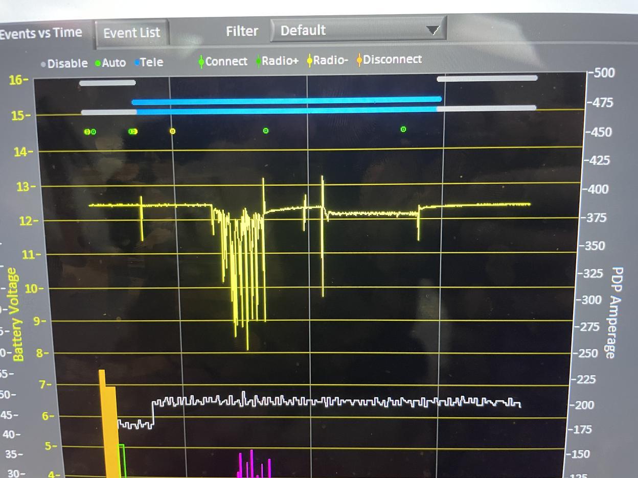

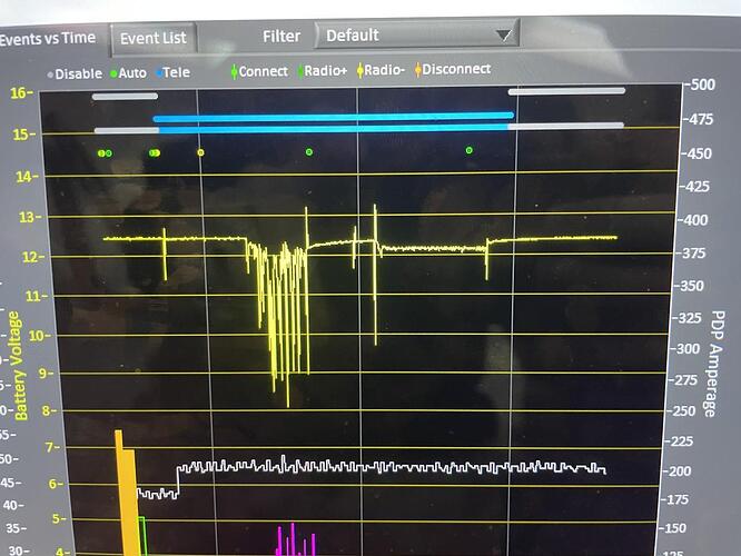

We just installed our first swerve drive system this year and are having issues with the robot “chattering”, not moving but vibrating in place when the battery voltage gets a little drawn down, usually with only 30 seconds of driving. It’s not 100% of the time, but primarily when we try to change directions. When this “chatter” happens, we can see the voltage go from ~12v to ~7v on the readout. It’s only a temporary dip and goes back up to the ~12v range but it’s very erratic movement when it does this. Has anyone seen this and have any ideas how to remedy?

A dip to 7V implies something is drawing a lot of current, and if it’s longer than an instant that would suggest there’s a lot of friction somewhere. The logs will help tell us where, as long as you have the PDP/PDH wired up on the CAN bus (and can tell us which power ports correspond to which motor).

If you could upload the log file directly, that should help us figure out where the issue is (as long as your PDP/PDH was on the CAN bus for the session the log recorded).
Our coding guy (Phrendoul) found that the current limit wasn’t all the same in the code and made them all 20A I believe. I think one was 20a and the rest were 80a. Thanks you for the help, that was a tricky problem!
